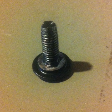

Also best to clean the mounting screw when reinstalling. Toyota in all their wisdom decided to paint/coat the screw, which can affect the quality of earth you will get. A quick polish with a grinder/file will see if earthing that much better.
post-13080-0-32619700-1316340203_thumb.j
