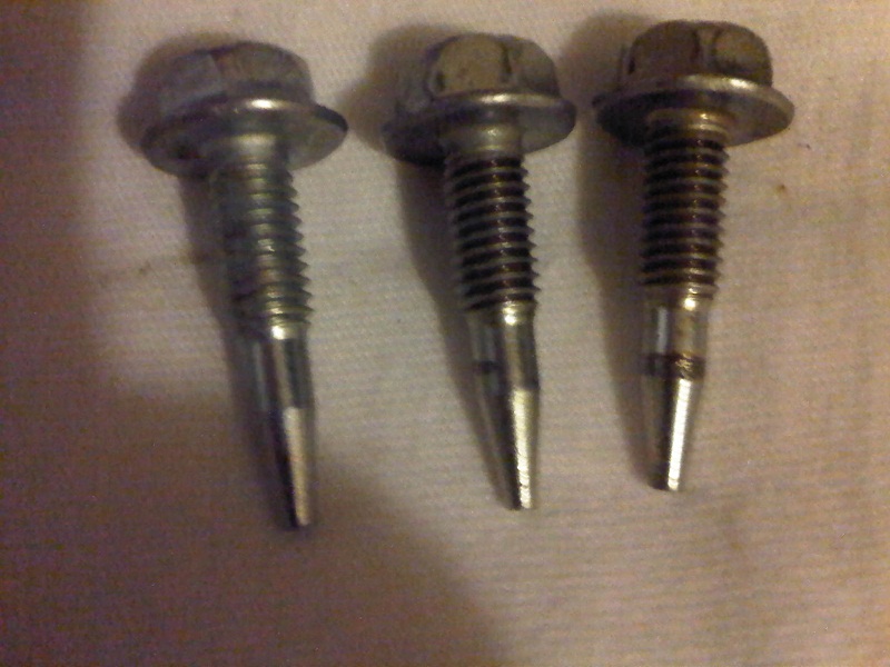

I was given some advice by another guy in the forum to change my lift bolts. Will go and get some today. It looks like a pretty easy job.
Lift bolts were changed by previous owner around 60k km. I'm now at 94k km.

Changed the lift bolts last night, no apprecialble wear. New one left, old middle and right.
