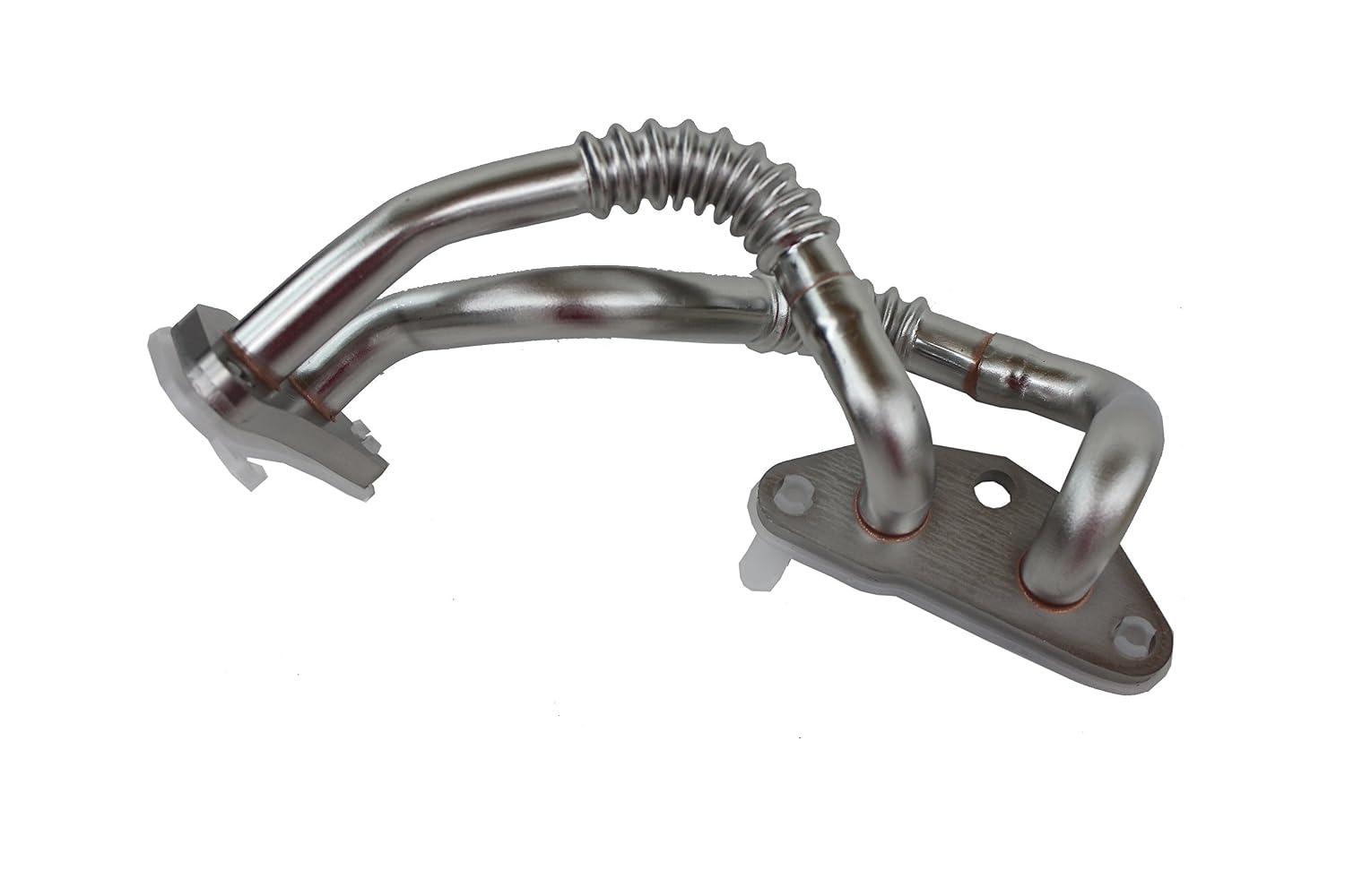

450HP/tonne you were correct. It was the part you described in your picture. I picked up the vehicle today and they confirmed it was in fact the Oil Cooler Assembly Hose and you had to buy it as an entire hose assembly hence why it would have cost $279. However as I got it fixed as a special matter Out Of Warranty Claim I did not have to pay for it. I just have to pay for the tilt tray truck getting me back to the dealership. I think the new hose assembly is of better quality and may have been changed on later models compared to my 2007 engine. I will post a picture of it when I get a chance to remove the shield under the motor. The dealership also tested the engine and said everything was fine, they gave me a loan car during the period so I was very happy with the outcome.

Here is a picture of the replacement hose which appears to be all metal with a stretchy bendy section (not sure what word you would use?)where the rubber hose was on the old part. It appears to be much stronger. You actually can see it without removing the plastic guard under the front as it is near the oil filter.
