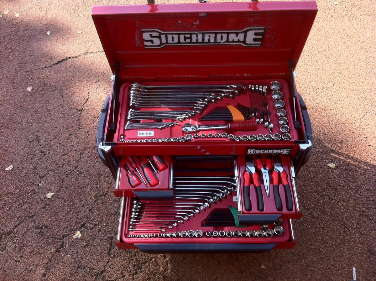

Example - Sidchrome tool chest i got for my 21st last year came damaged/disfunctional 3 times from Repco. Wrote a letter to Repco Aust, 3 weeks later i had a tool chest (next model up) and few extra tools on the house, also dropped their price by $200, all for the f |_| ck around they caused.
post-21214-0-84828700-1329305953_thumb.j
So intern write a letter, see what ya get out of it :)
That's a sweet tool set! Great minds think alike I already started the letter after my 2nd post, stating my dissatisfaction :P
