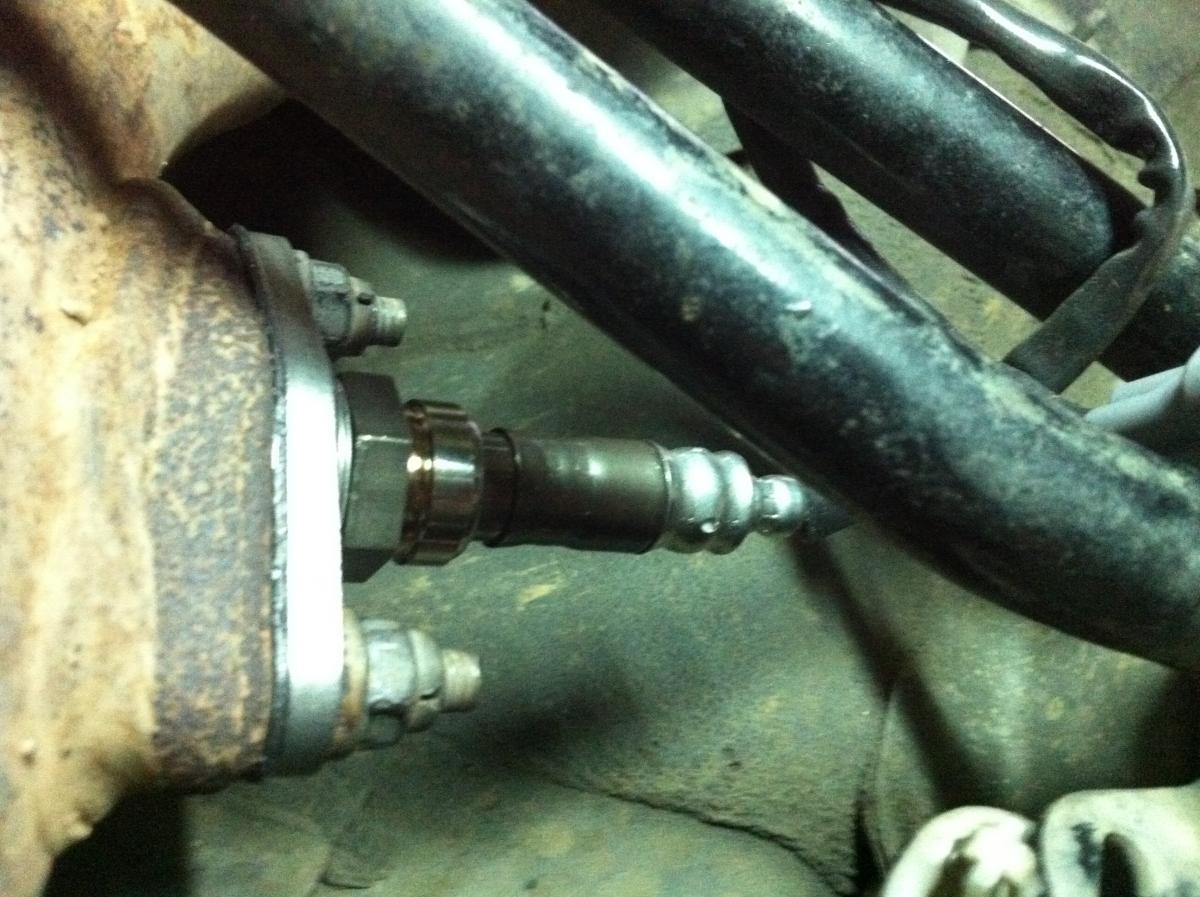

The O2 sensor of the Ae112 is located downstream , near the catalytic converter. While the AE102 is below the exhaust manifold, you have to drill and weld an o2 sensor bung on the ae112exhaust manifold/ extractor same position where the ae102 ,in that way you can install the o2 sensor.
But if you got no time to do the modification, just swap it.
True, is it still a 1/2 wire O2 sensor on the 112s or did they switch to a heated one?
post-27536-0-55350900-1346660970_thumb.jIt has a 13ohms heater resistance, high wattage, 4wires, Flange type (54mm pitch) sensor. I just installed this today, arrived from US, Part number SG470 Standard Motor Products, same sensors use on 1998-2001 Toyota Corolla/ Chevy Prizm 1ZZFE engine.
