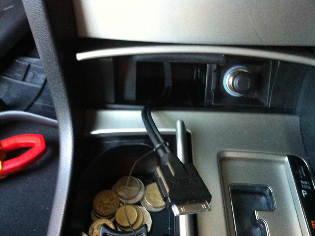

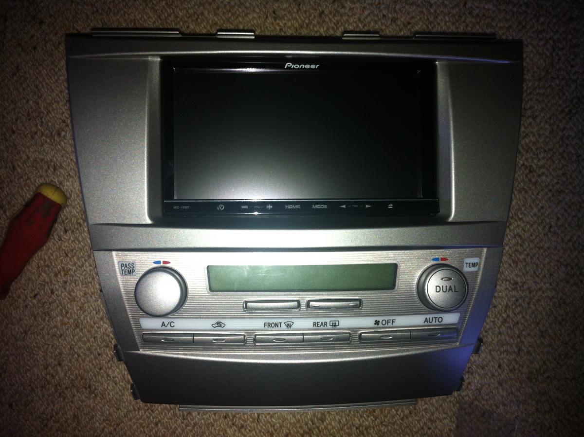

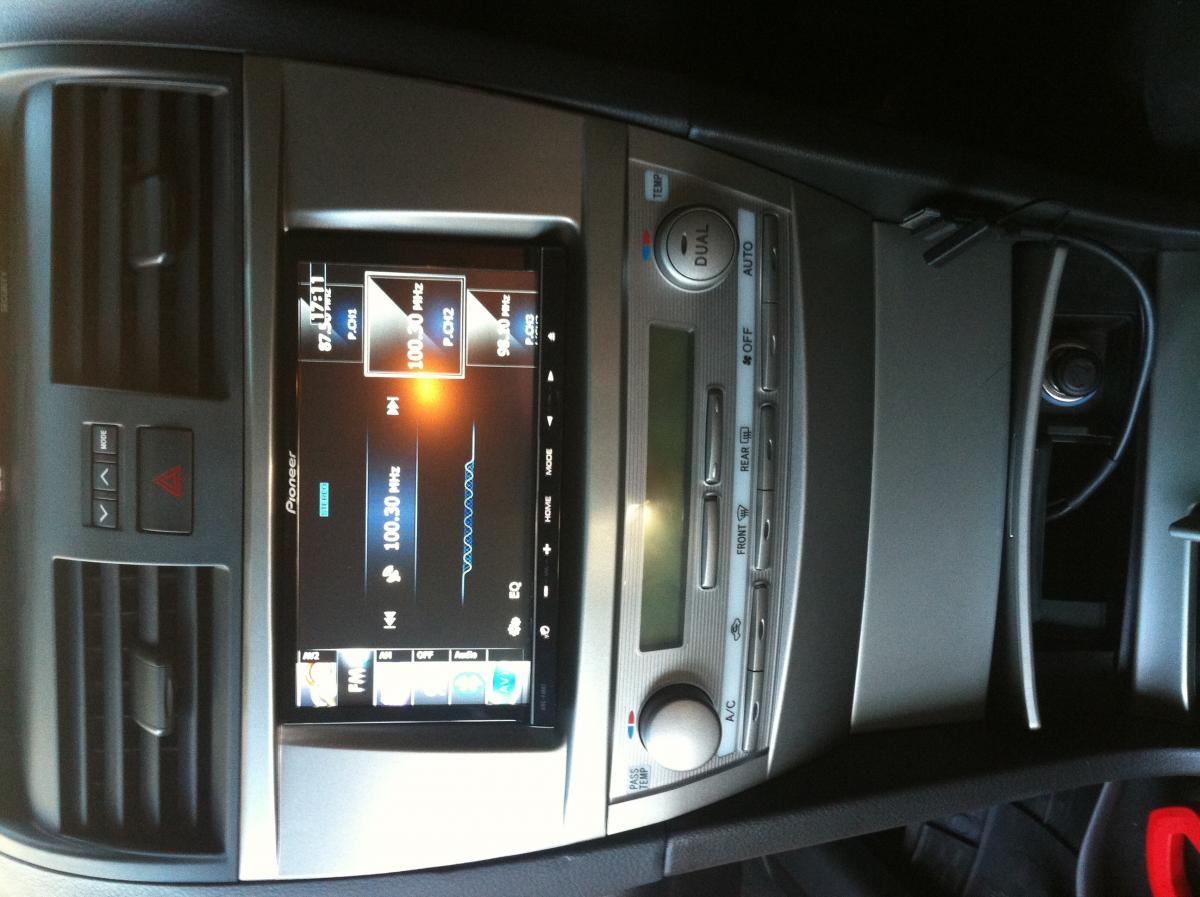

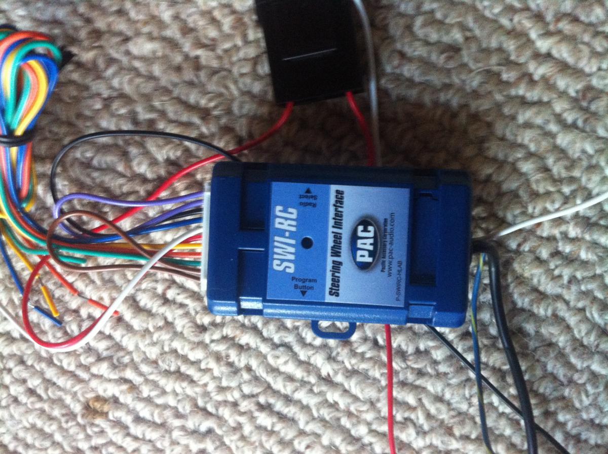

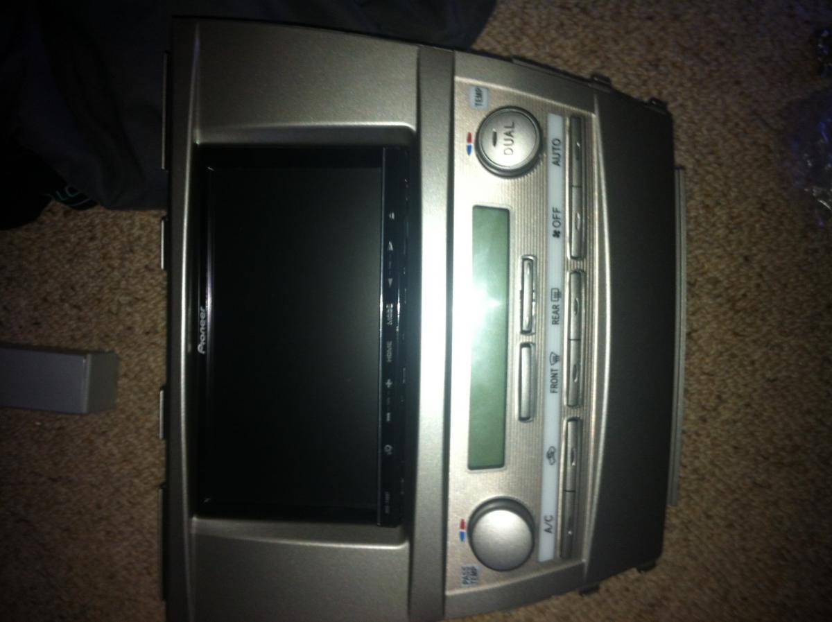

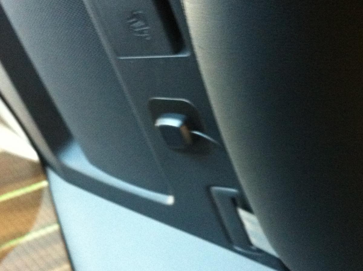

Just finished putting in the new head unit, replacing the cheap Chinese piece of s.hit - Sooooo much better in every way! SQ is amazing!
So here's some photos of the install and parts used. I'll keep this thread updated with new installs etc, going to put some extra lighting in. Also happy to answer any questions anyone has.

post-28952-0-14015300-1346855795_thumb.j
post-28952-0-37427800-1346855825_thumb.j
post-28952-0-01738300-1346855857_thumb.j
post-28952-0-91943400-1346855899_thumb.j
post-28952-0-42032300-1346855940_thumb.j
post-28952-0-49815700-1346855988_thumb.j
post-28952-0-74041600-1346856040_thumb.j
congrts on the install look really nice :D POS for sure hahaha
if you dont mind me asking how much did everything set you back ?
Expensive lol. Headunit $1700, Speakers $900, Amp $300 (i think), Wiring $80, Interface $80, Fascia $50 and another $30 or so for crimps, solder etc etc.
wow that is expensive lool but everything good comes with a price tag ,i can just imagine how nice this will sound, post a video if you can PLEASE !

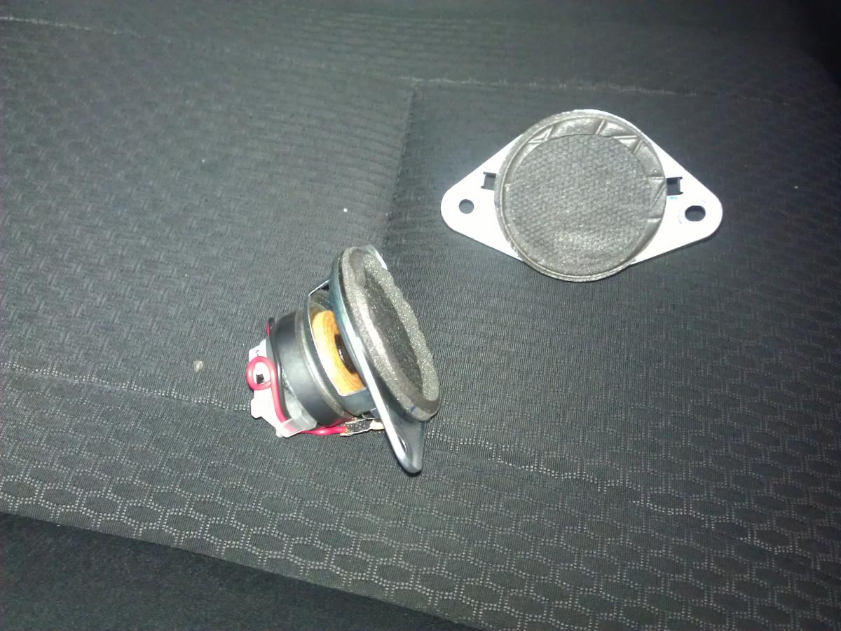

SATORI893
as requested, factory tweeters and aftermarket tweeter size
post-22021-0-64989500-1354417471_thumb.j
post-22021-0-79379400-1354417563_thumb.j
the tweeters i used are a standard 1" tweeter, much smaller than the factory one
