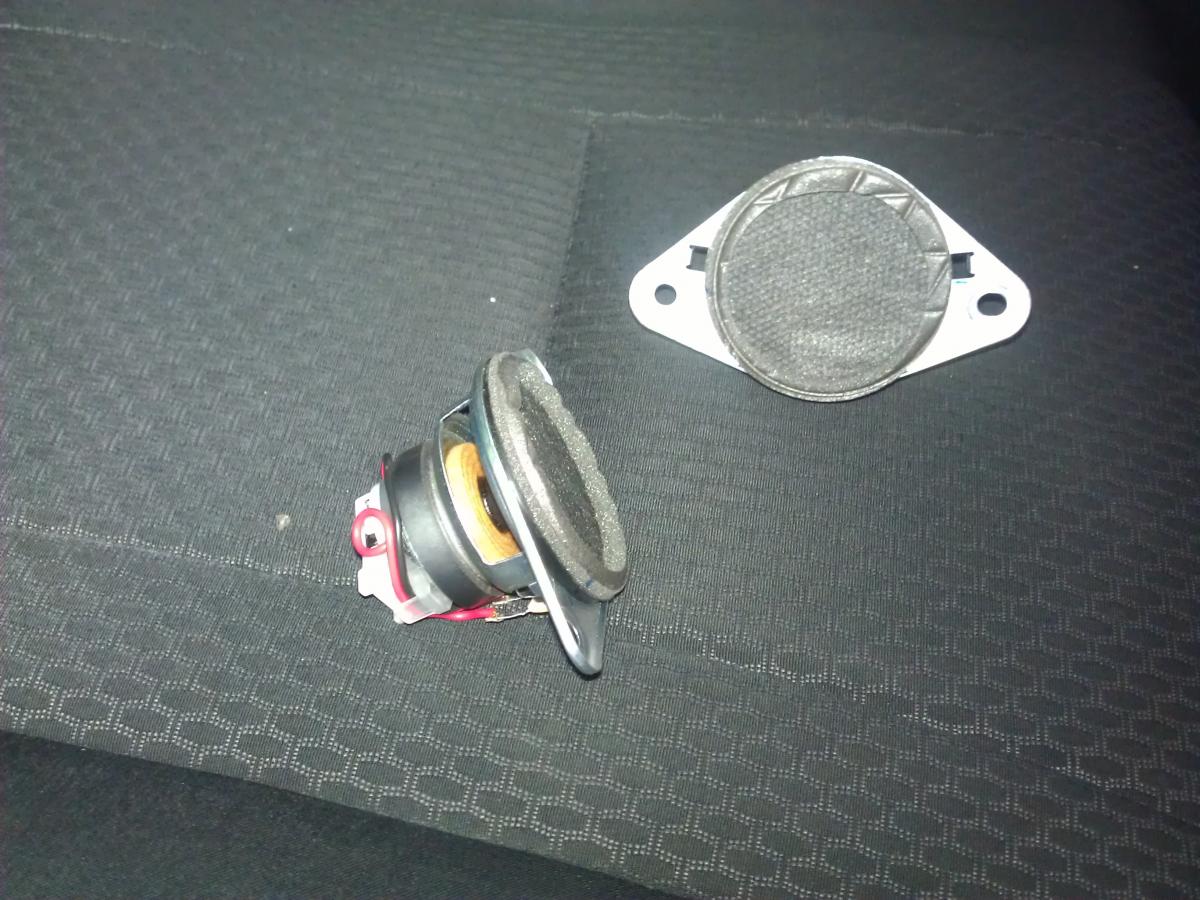

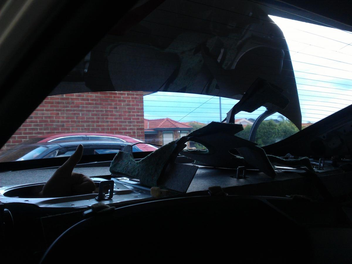

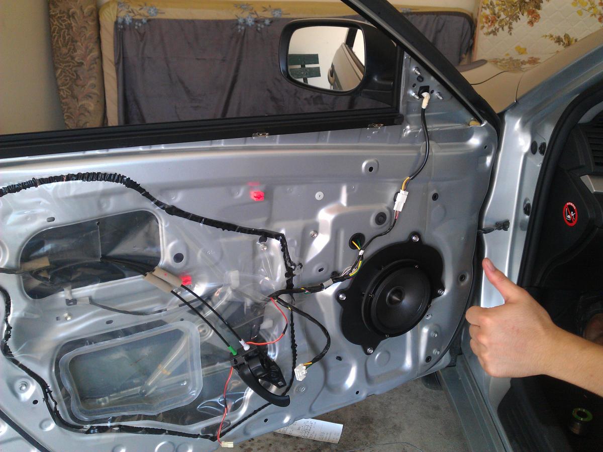

so today, for the first time i've installed speakers into my car and it was my beloved aurion :)
it was such a difficult task, but very very satisfactory
big thanks to my mate for helping me
things i noticed:
the huge factory tweeters
the near impossible task of running a wire from the kick panels to the door

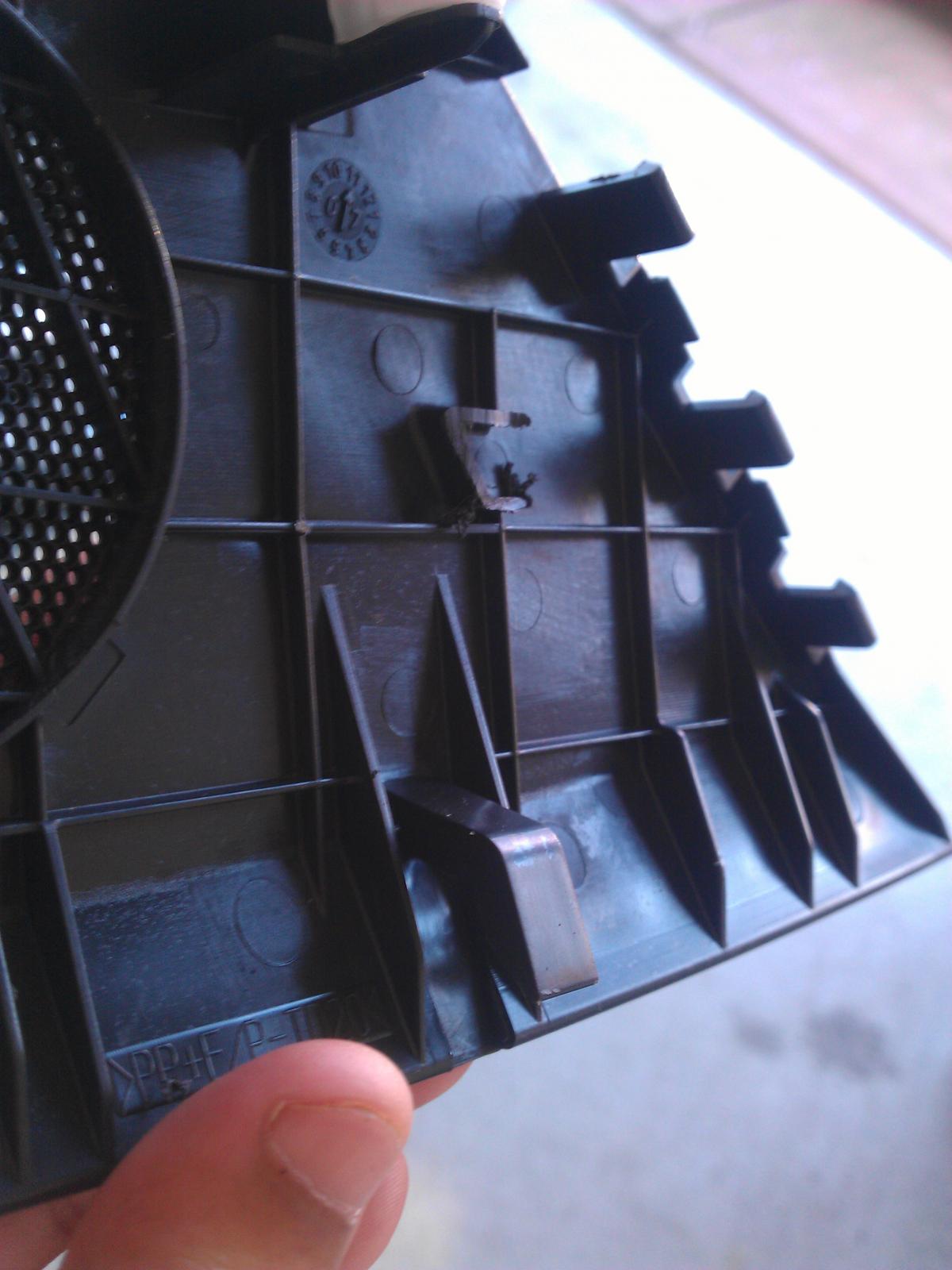

due to the mounts i made for the tweeters, some cutting was needed for the tweeter grills
here are a few pictures attached of the install, hope you like

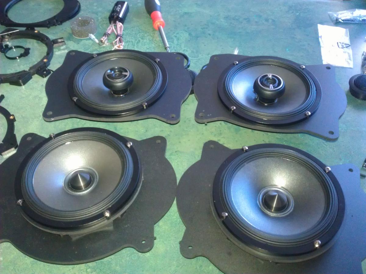

specs of what i put in:
Alpine Type R Component SPR-60C
Alpine Type R Coaxial SPR-60
Alpine PDX-F4
Looks good from what I can see :) where did u get the speaker spacers from?
if you check my other post about speaker sizes, you'll find the link to the ebay seller.
i recommend buying from them as they sell all the speaker mounts for aurions, front, rear and tweeters
also, if you provide them with minimum 10 photos of the install, you will get 50% of your money back

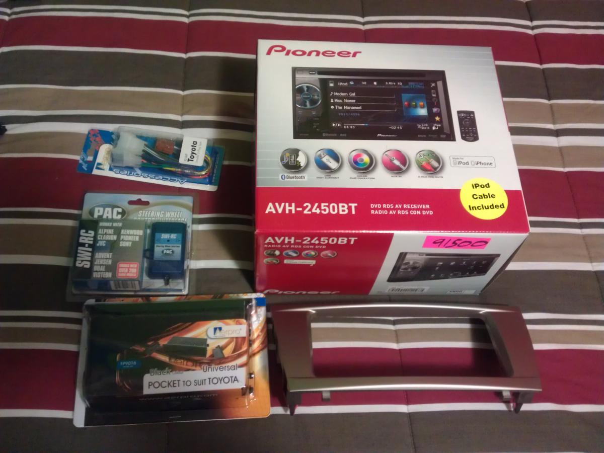

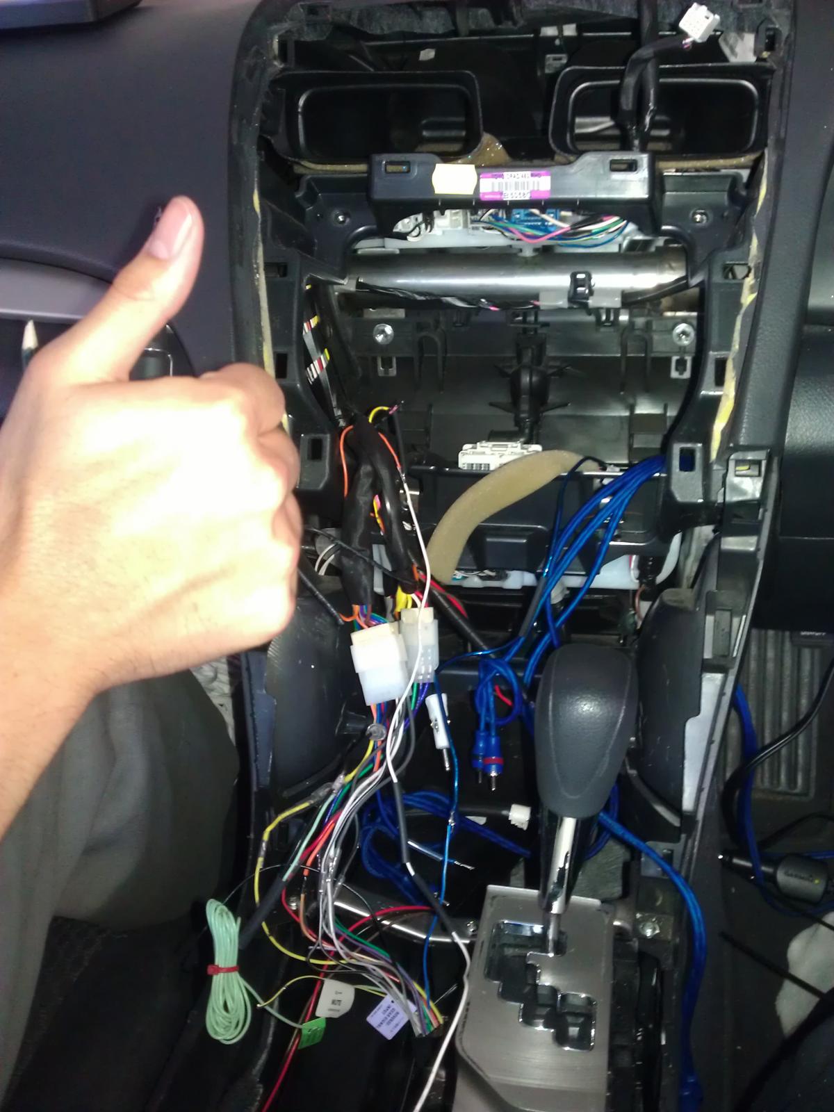

its a pioneer AVH2450bt
post-22021-0-85474300-1354330279_thumb.j
my beautiful dash during the installation of it :P

Looks nice, in your pic what is the PAC SWI-RC thing, I can only read 'Steering Wheel' on the packet from the angle? Is it a remote control for the head unit or an adaptor for the steering wheel controls to work with the Pioneer unit?
Edited by SATORI893
its called the steering wheel interface remote control, it lets you control the head unit with your steering wheel
however not sure if ive programmed it wrong, but the up and down arrow on the steering wheel only goes next and previous in the FM tuner :unsure:
the functions i've got working on it are, vol up and down, next and previous for certain input modes, and the mode button decreases the volume by half
Edited by xCalibur_
little interested on why didnt go 6x9's since the origanals are
i didn't get 6x9" because there is barely any difference in sound quality, they are more expensive and either way you go, you'll need a bracket.
for the front, there are very very few companies which make 6x9" component kits, so 6.5" component was the choice.
as for the back, 6x9" give a TINY bit of extra bass (alpine spr-69 is 60Hz - 29KHz, alpine spr-60 is 65Hz - 29KHz) which i dont need seeing as i have a sub installed which is doing all frequencies below 100Hz
its all choice really. in the end, you wont see them.
when i installed mine i didnt need any bracket ... and my speaker magnet is big also i cut the stock speaker out and reused the bracket Edited by Shadow_
see i would have cut the factory speaker, but if i do plan to sell the car, i'll have all the original parts

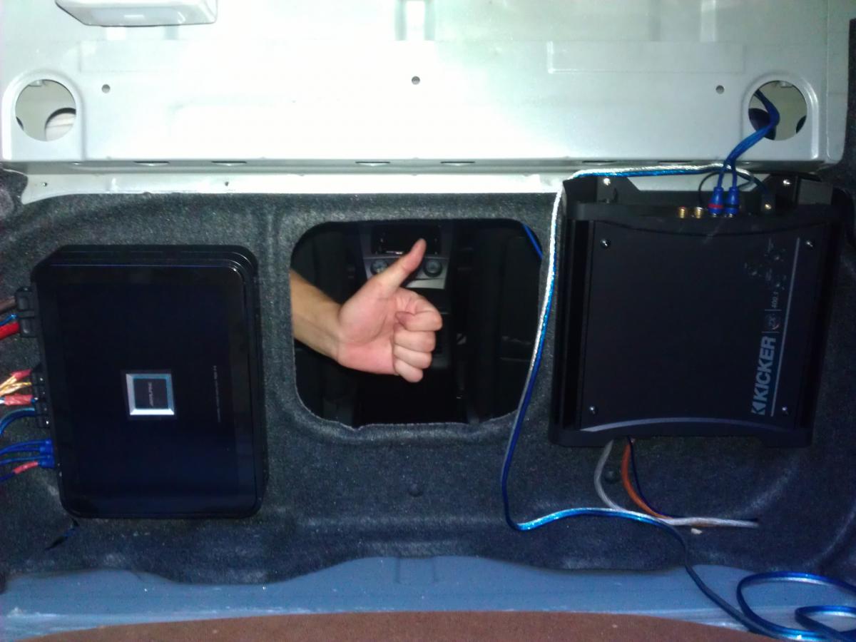

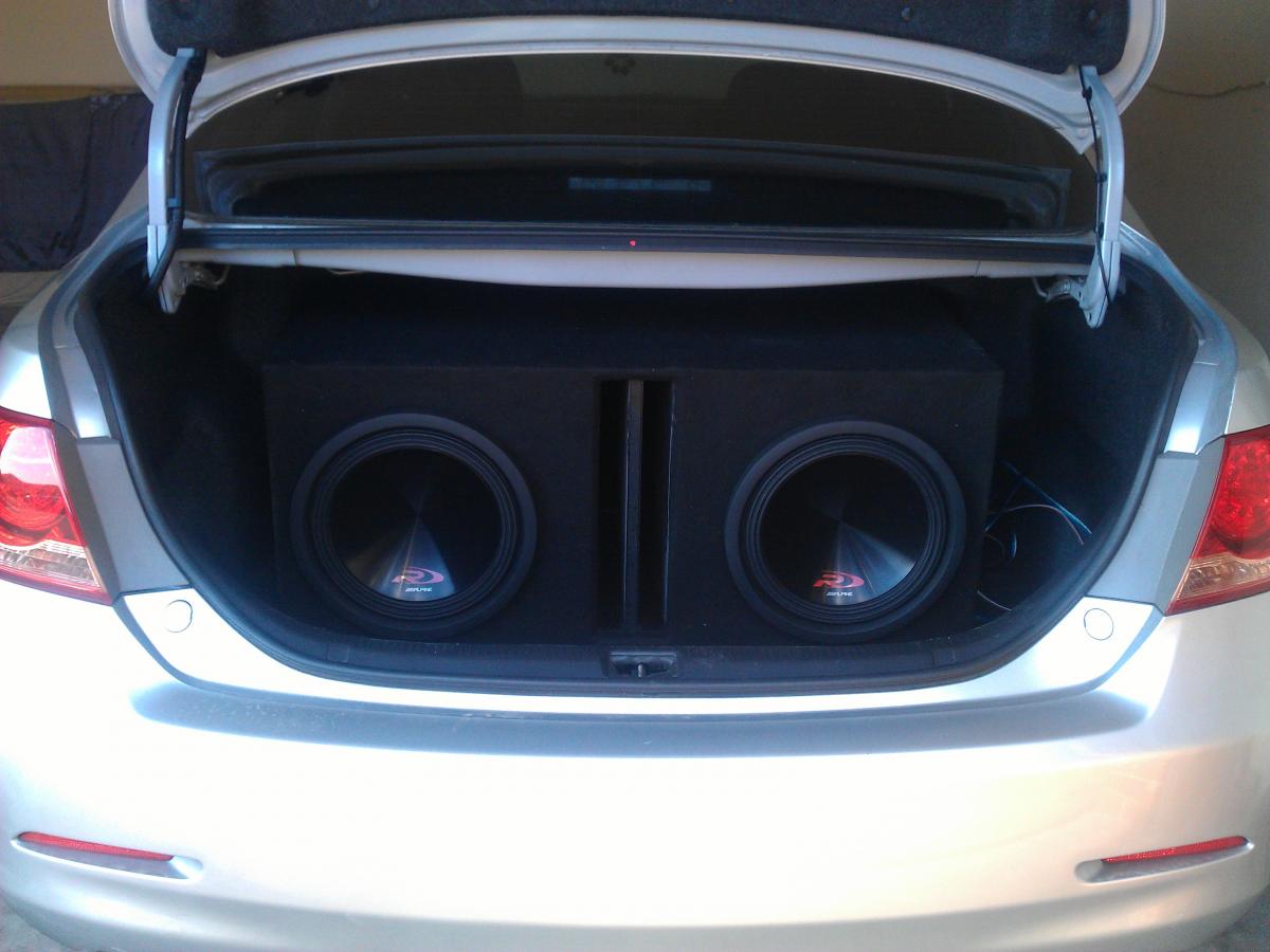

update:
finally finished the whole audio system upgrade
just installed my new subs, and let me say, bootspace in non-existant :P
just getting the box in was a slight struggle, i probably have about enough space for one bag
post-22021-0-18332600-1357198005_thumb.j
final specs:
Alpine Type R Component SPR-60C :- front speakers and tweeters
Alpine Type R Coaxial SPR-60 :- rear speakers
2x Alpine Type R Subwoofer SWR-12D2
Alpine PDX-F4 :- 4 channel (front and rear speakers)
Alpine PDX-M12 :- monoblock (subs)
Pioneer 2450bt :- headunit
Optima Yellow Top Battery
as you can tell, i went with a near full alpine system, head unit to be upgraded in the future :D

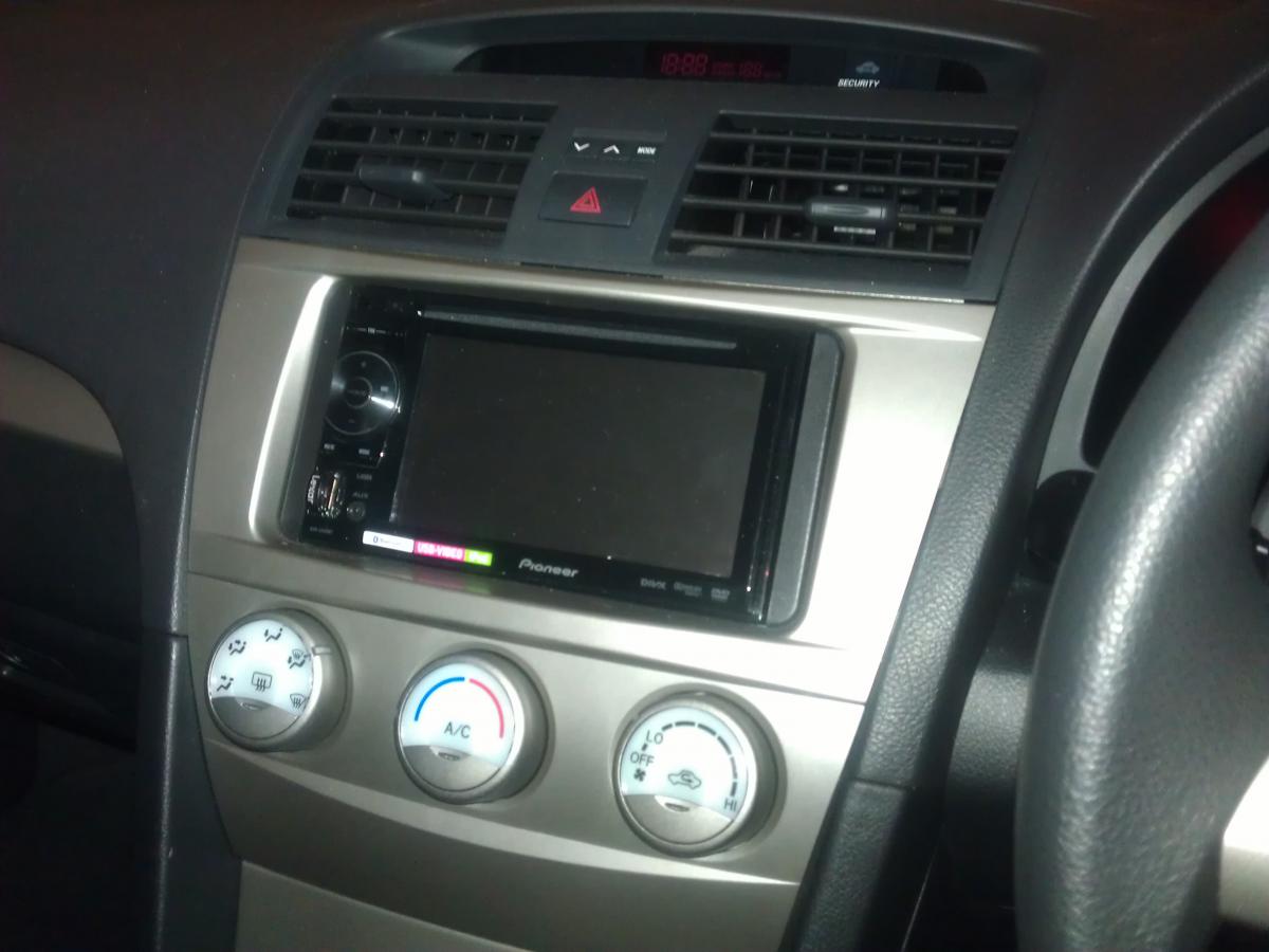

Nice.... got a finished pic of the stereo install?
How much did this gear cost? Did you install yourself or get it professionally done?
Did you need a new fascia panel to make it look right or is that the stock one in the pic?
Looks amazing by the way
there are some progress pictures with the speakers in the door panels and parcel shelf, and tweeters in the dash, and amp mounting. cant really show more due to the panels all being on, its all hidden. looks all stock apart from the head unit.
i cant remember exactly but it would have been around the 700$-800$ mark.
this is what the head unit looks like in the dash. yeah there's a fascia panel around it. i installed it myself with a mate.
