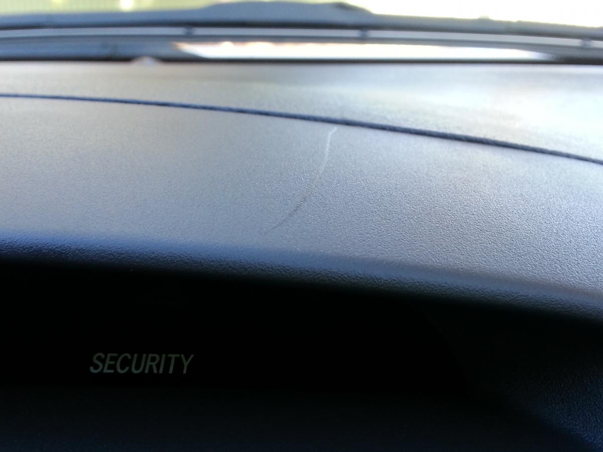

Hey all,
I have an issue with my 07 Prodigy.
I have a rattle in the top vents area.
I am pretty sure it's located in the vents themselves, as when I put my finger in the dash, the rattle almost stops.
Has anyone experienced this issue? any advice on how to stop it, as it's very annoying.
Also, in the process of finding the rattle, I scratched my dash!! I am FUUUMINNNGGG at myself. :'(
Does anyone have any reccomendations on how to fix this? Because if I don't fix it, I will probably go to Toyota and get a cost on a new part.
Please let me know.
Thanks

Hi everyone.
With this vent rattle I mentioned in the first post, I read somewhere that Toyota fixed it... Is this right?
If I order a new dash piece with the vents in it, will I get the vents that don't rattle?
