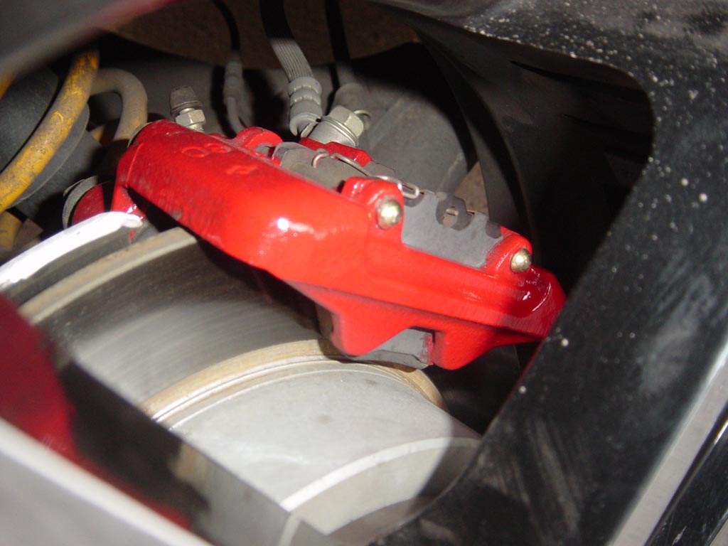

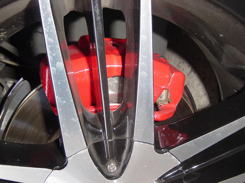

And the end result...
p.s The end result will really depend on how well you tape the surrounding areas of the caliper so make sure you spend the time taping it up properly before spraying.

stupid question.. what part of the caliper can i spray and what part u cant i spray? i noticed you have left sections untouched on urs...
well u can pretty much paint over the areas that i didn't paint as well, but i didn't want to paint them for a more cleaner professional look.
you caliper will be a light greenish/blue colour, so basically cover everything that isn't that colour :)

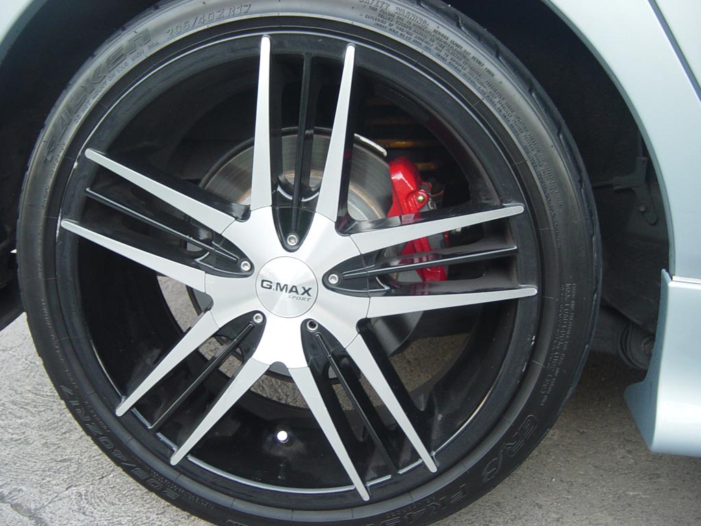

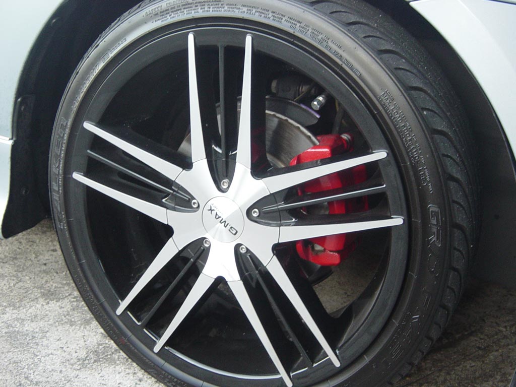

Here's a pic of a set I did on the weekend:
the proper way to paint the calipers is to remove them from the car, dissasemble, clean then paint.  It's just that most people aren't equipped or skilled enough to do this so they do the dodgey way of painting the caliper while on the car.
Also, if you use a wire wheel to clean the surface rust and brake dust off, the paint gets a much better key to the metal.

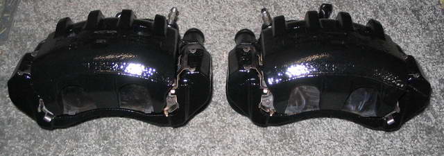

I made the mistake of just spraying the calipers on the car.......then i ended upo pulling them off the car and redoing at a later stage. I'm glad i did ...it looks 500% beter ;)
As Jason mentioned' if you are skilled enough'  alot of people are daunted by the idea of removing the whole caliper assembly and having to bleed brakes etc.
