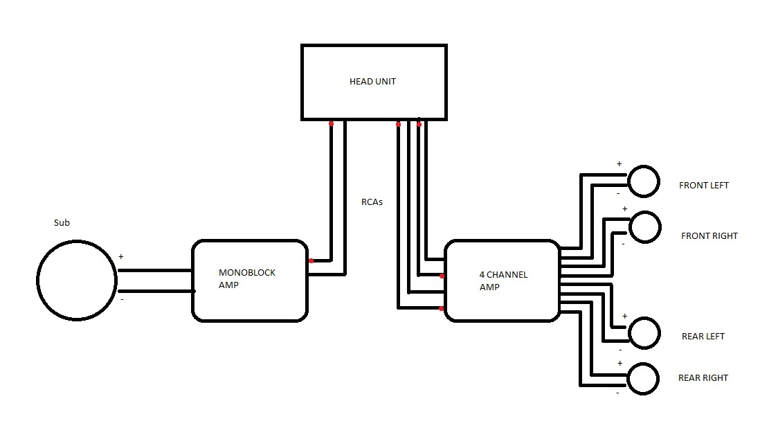

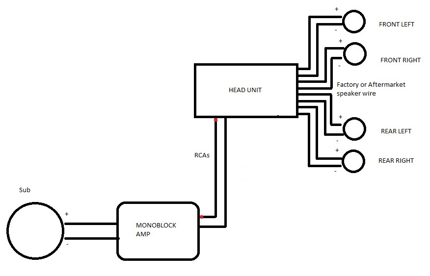

i've attached two diagrams of possible system solutions which i had made for a friend last year
i suggest if you're budget is smaller to use this setup
post-22021-0-19332100-1358957023_thumb.j
or this if you've got the money
post-22021-0-22730500-1358957034_thumb.j
