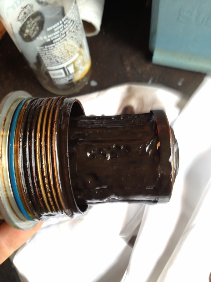

Sludge is a wonderfull thing.It usually results from leaving the oil in the engine well past its use by date ( To save paying for a service) Not what oil is used
If you know you are not going to pay to have it serviced at least go and buy 6lts of oil,a new oil filter and do it your self.Dont wait until it starts to die and then suddenly panic and think (all will be o.k once I have the service done ) too late damage has long been done!!!
This is a picture of a VE engine oil filter due to trying to save a few dollars on a service.

Quote;[ I wont trust a mechanic who wont tell me what oil he uses]
If you say so. I still don't trust abovementioned mechanic. And I refuse to use cheap sh!t oil.
