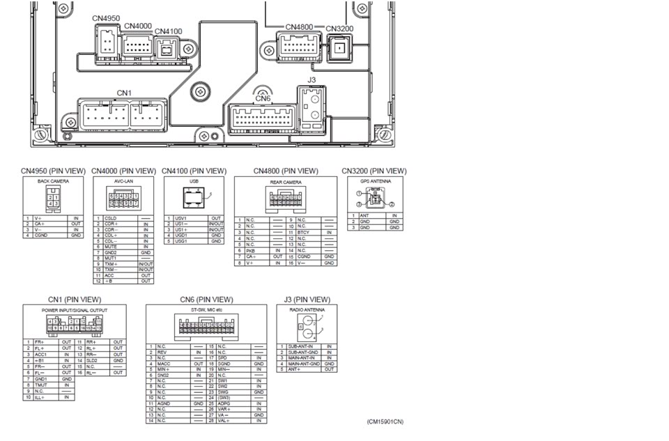

After much looking around, I found the attached picture detailing the back of the head unit.
I note that there is a USB port out the back named "CN4100."

Does anyone know if that port allows a USB (iPod) to be plugged into the back of it?
Secondly, does anyone know where I would acquire such a cable to fit the back?
