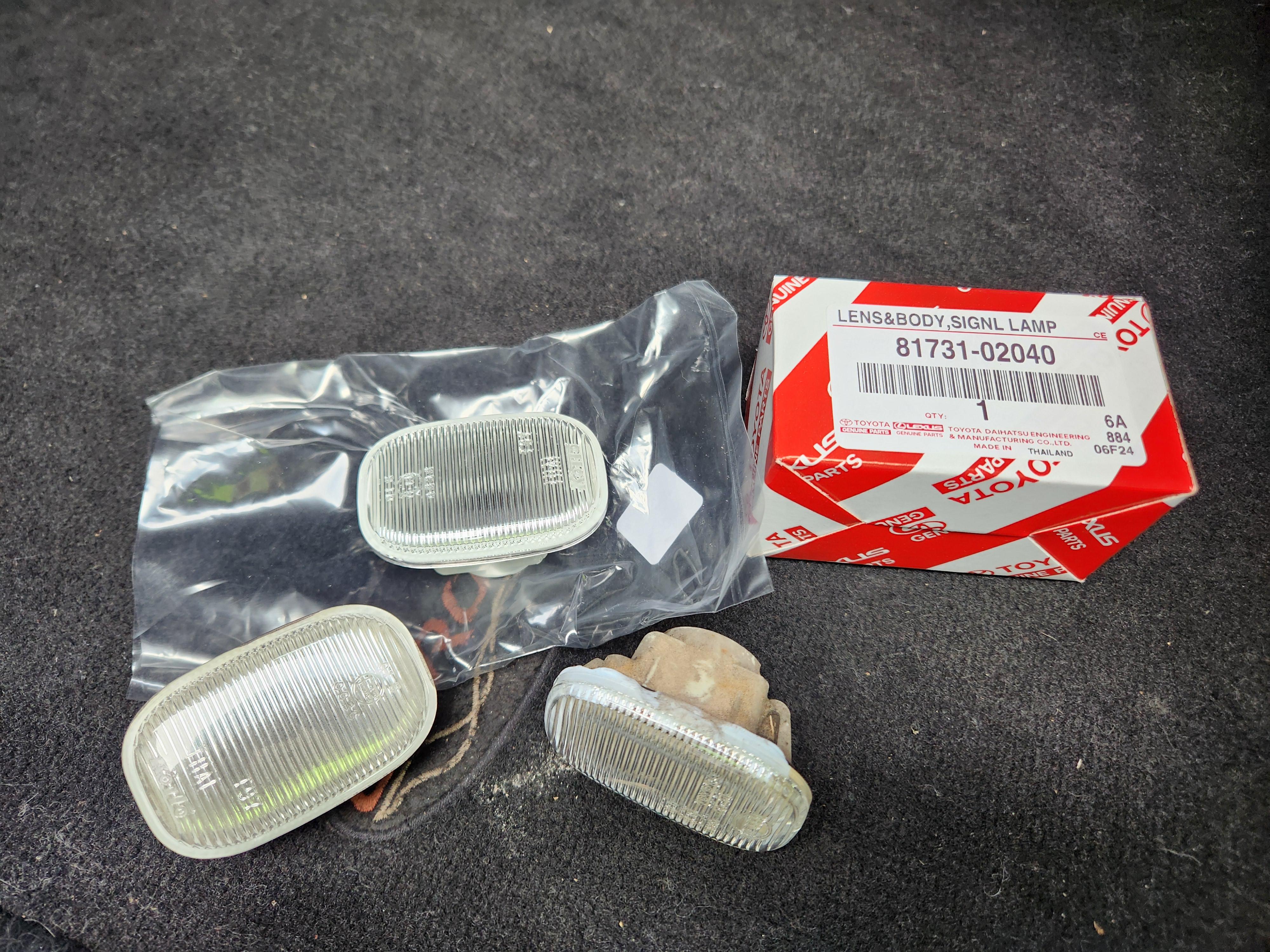

Back in April, I noticed for some time my drivers side guard indicator had not been working. I went ahead and attempted to remove the indicator cover and the whole lense came off. I found the bulb had actually split and required replacement. I got handy with the blutack to get the lense back on until some new OEM replacements arrived and got some new bulbs. I have to say, I didn't notice the lack of orange on my indicators before changing the bulbs. It's a nice little change and found my current bulbs which I'd never changed before had all the orange film basically peeled off.
New indicator lense vs the 2 old units. Part number for anyone needing any, of course in great Toyota fashion the part is shared across multiple models and I just went and found the cheapest shop that had the same part number.

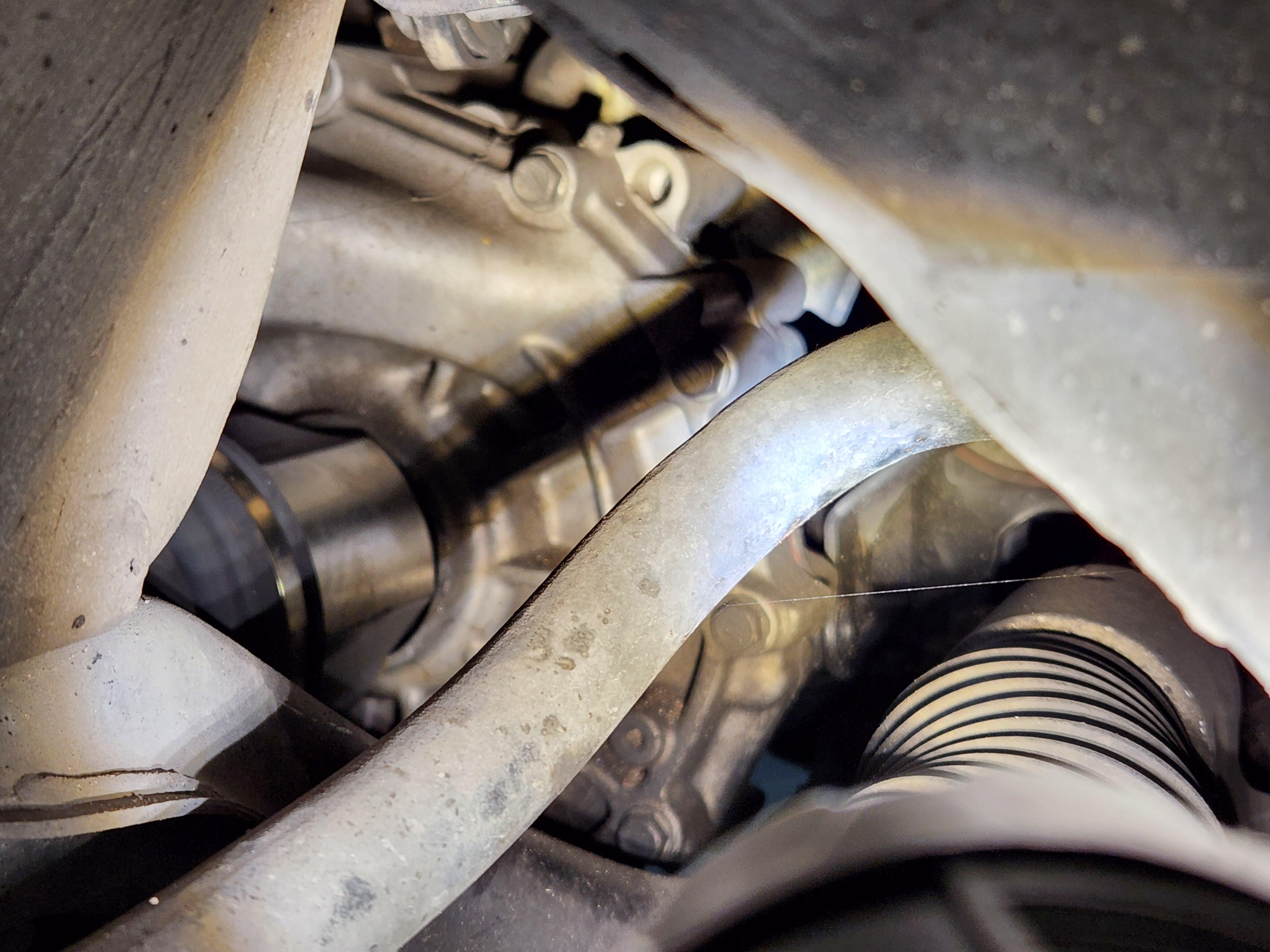

As I mentioned in previous posts, I'd had a clunk like noise for some time and I noticed it kept getting worse from the first time I noticed it. One weekend when I finally had some time available, I decided to jack up the car and have a look and what I found wasn't totally shocking. I found that the rear engine mount bracket that is attached to the gearbox, was not attached there anymore. 2 of the 3 bolts were missing and the only 1 left was sitting there dangling. With the help of my mates Alec and Richard, I was able to get some spare identical bolts of Richy and Alec was able to re-install them as it was a job I was able to explain what I needed to do but couldn't get my head around doing it. Alec ended up having to take out the engine mount, jack up the engine/gearbox to line if all up before putting it all back together.
After chatting with Alec about it, he mentioned what likely happened was someone hasn't done the bolts up tight enough which meant the bottom 2 fell out leaving the last single one on the top to take all the force before it let go. Once he mentioned this, I realised I started noticing the noise after I'd got my clutch changed before my wedding in 2023 and he agreed that it was definitely at that point it was likely one of the mechanics didn't bother checking the bolts to see if they were tight. A bit annoying but oh well we move on. All the bolts went back although, the single top bolt needed loctite as it's likely as Alec said, it was the last one held in and when it was forced out it's taken some thread out. I'm going to monitor this as for now the car is driving really well and feels great to drive again. If the bolt comes out again, I will have to get the gearbox out and get someone to re-tap the thread for that bolt.
20250611_175547.thumb.jpg.74ef6457bb69294c48f30b4847ea3f99.jpg20250611_175654.thumb.jpg.5e7686ff5acf57773a8ad0f3ed1a59f3.jpg
Best photo I could get but here's a shot of where a bolt should be.

I have to say that it was a good catch on those missing  engine bolts. I would have to agree that it must have been when the shop did the clutch. It's an easy thing to overlook unfortunately in a busy shop when mechanics are under the pump to get the jobs done. I bet the guy intended to do it, and just plain forgot. Lucky you caught it in time though. It always pays to check over the work once you get the car home. You'd be surprised what you'll find. I've heard some stories from friends who always check under the hood after a service and the little things they noticed.
