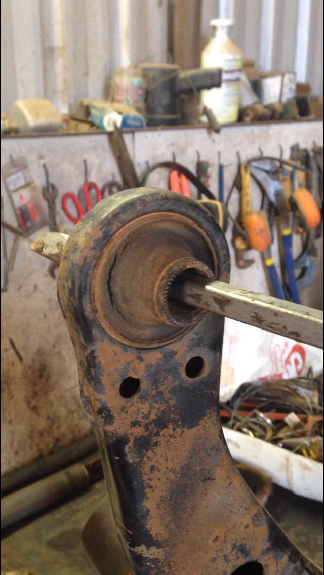

Took the lower control arm off this afternoon - this is what I found (see picture).
The bushing has a crack on both sides as seen in the picture. I'm guessing/hoping this will be the cause of the squeaking?
Thoughts?!
Replace the bushing or is it easier to just replace the whole arm?
Regardless of whether it's your problem, the bushes need replacing. It will be a better financial move to do the bushes only and the arm will cost a lot more.
