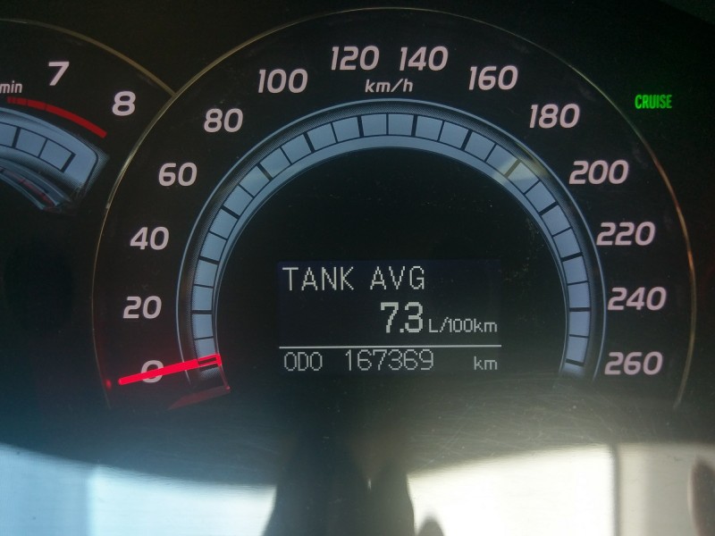

We're already up to 5000KM since aquisition. Had a good chance to experiment with fuel. On motorway (as opposed to highway) cycle sitting on low 7s on 98RON. Can't seem to push it lower than 9 on either 91RON or E10. Makes sense to use 98.
Highway driving (one lane each way, hillier, some overtaking) on 98RON consumption is in the high 8s. On 91RON/E10 around 10.
Urban driving 98RON is around 11.5 and ULP/E10 12.0. Given the added cost of 98RON it makes no financial sense to use it around town. No difference in consumption spotted between ULP and E10.
I've also found the consumption calculator in the vehicle over estimates actual consumption. FWIW when filling up with E10 or ULP the DTE reads around 560KM and 640KM on 98.
