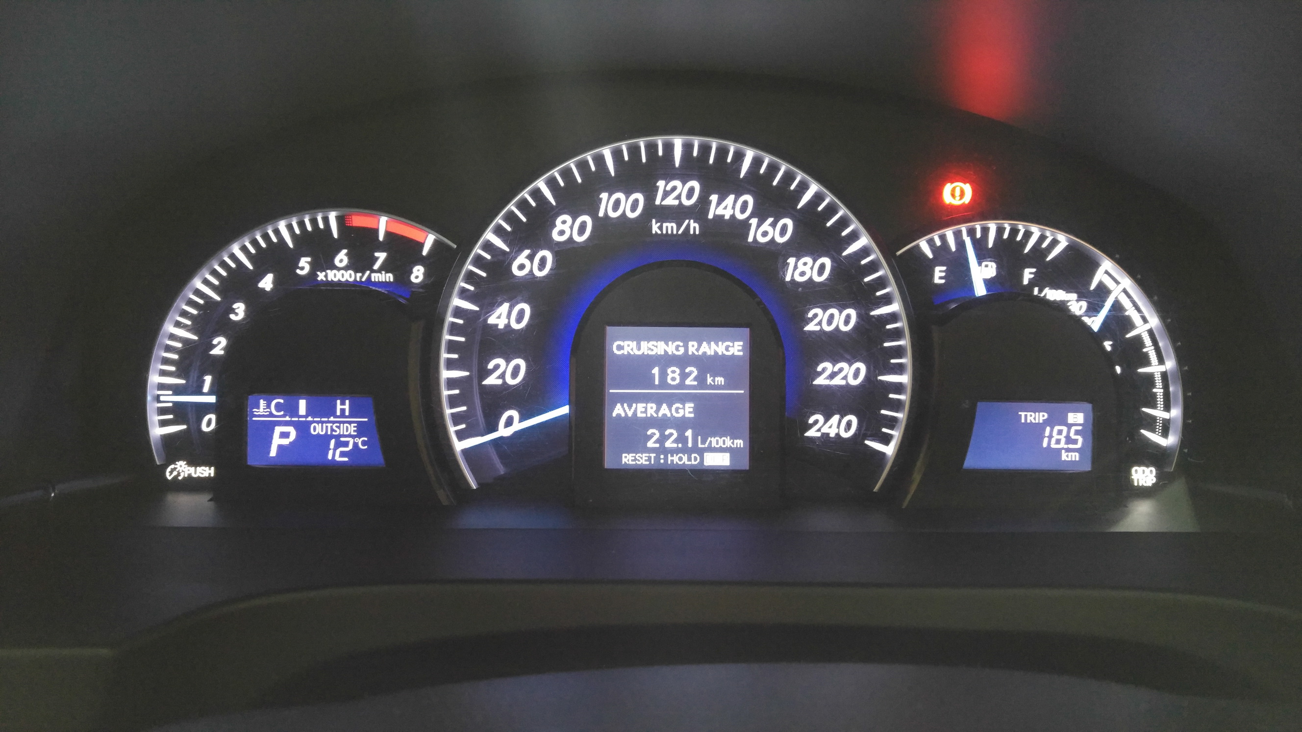

I am getting 22L, in the city I think it is a bit high. I will be going to the mechanic on Monday, is there anything I should point out to him. It is Aurion 2013 with over 100k on the clock. I'm been trying to use Eco mode, but it looks like the Eco mode gives the higher petrol consumption for me. Have anyone been using Eco mode with much success? The pressure in my wheels was 31 I pumped them to 36psi. Hope that will help a bit. I'm been using Premium 98.
22litres per 100km is pertty bad. But if you do lots of 5km trips in traffic it wouldnt be surprising
yeah at the moment it was just small trips around 5 to 10k in traffic. But I was hoping it would be around 15 liters per 100km.

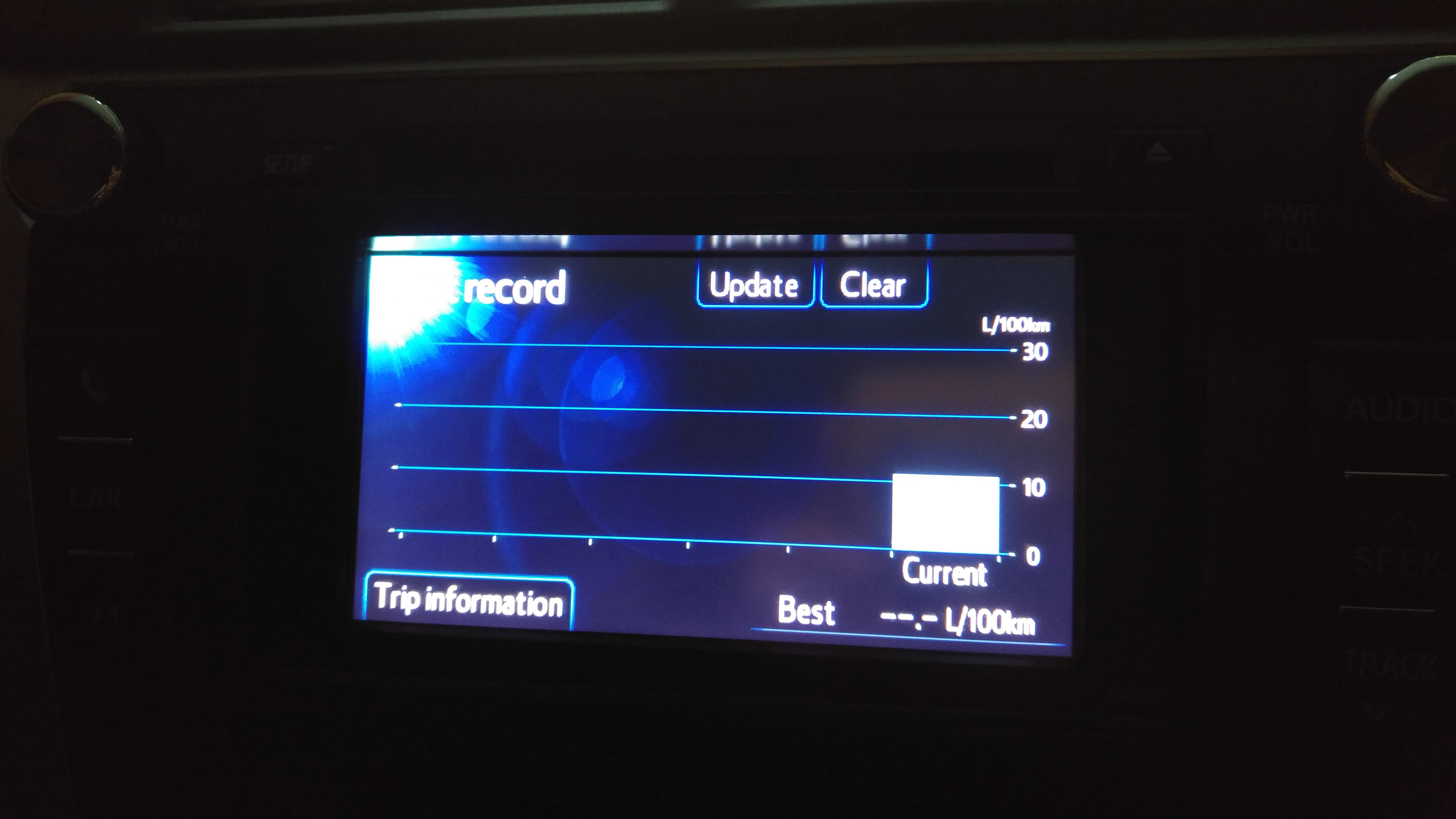

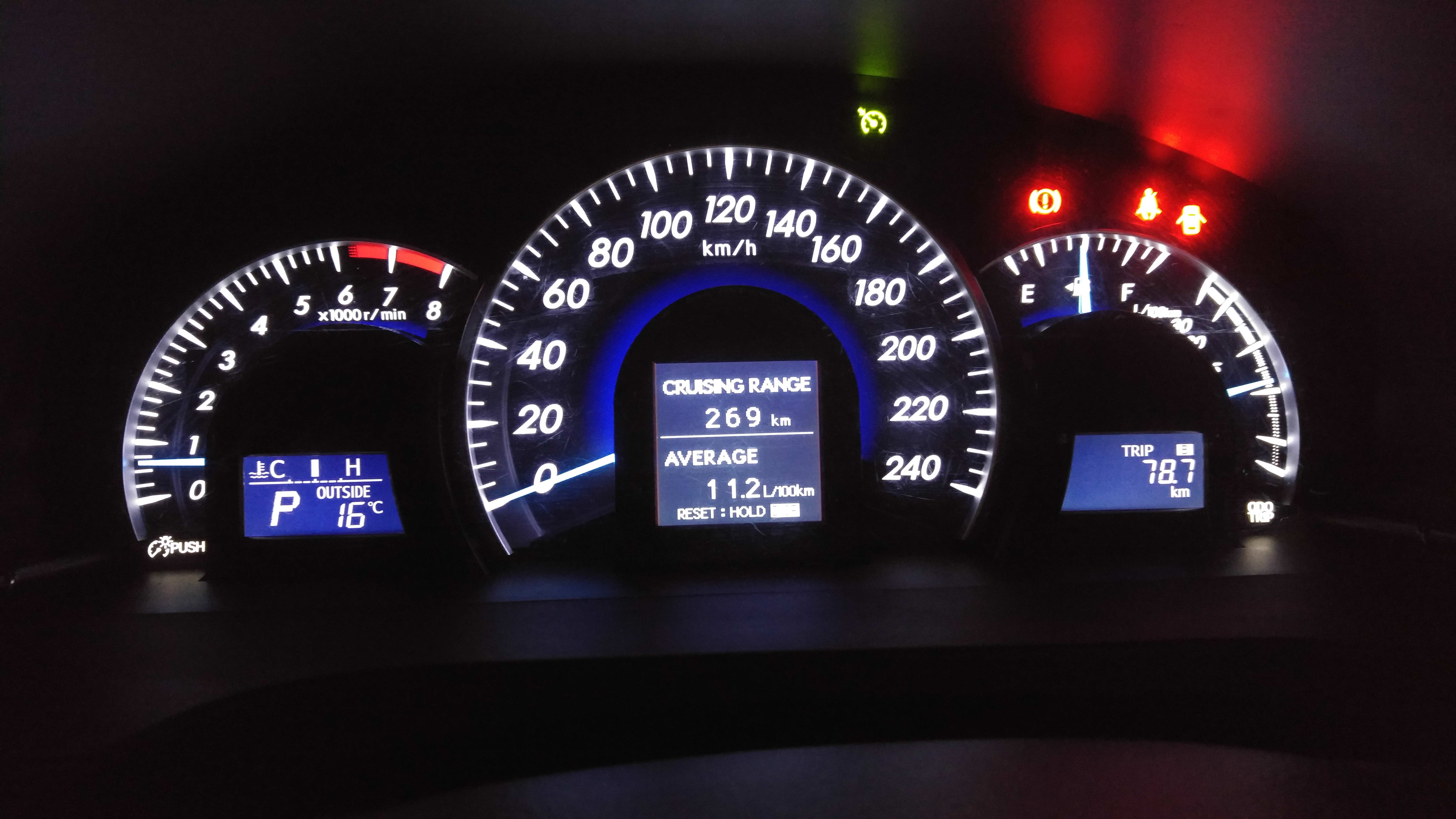

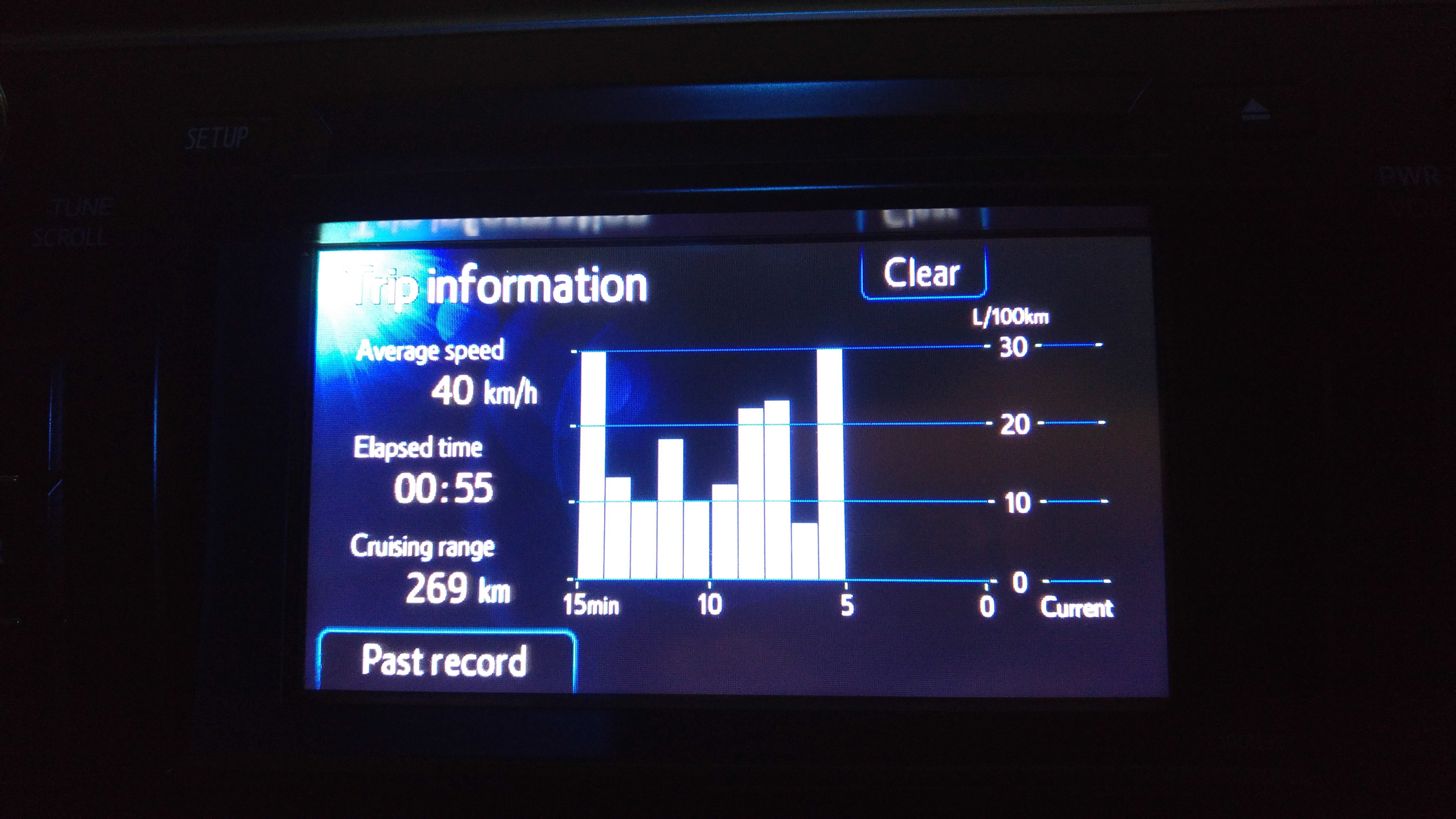

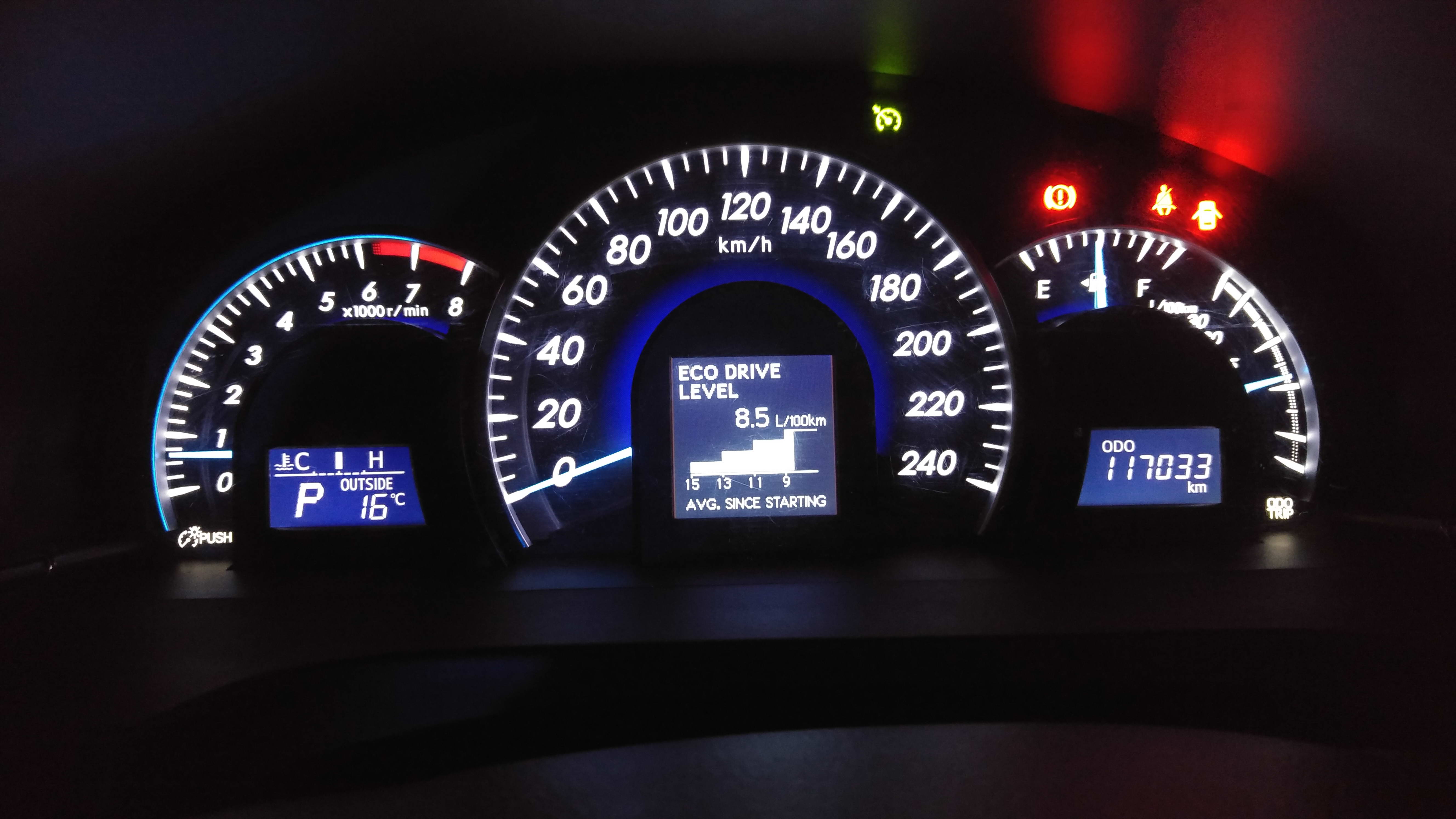

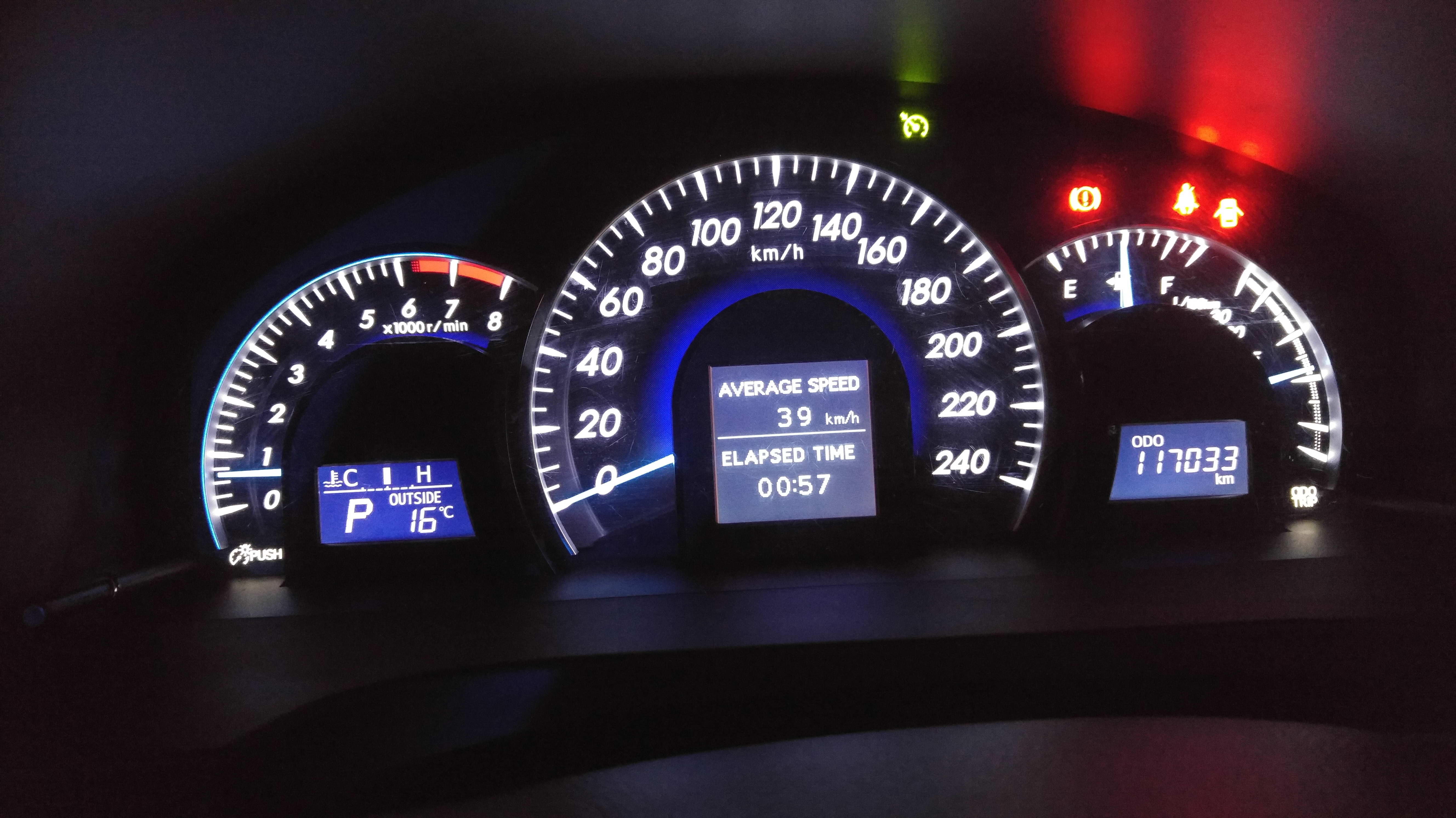

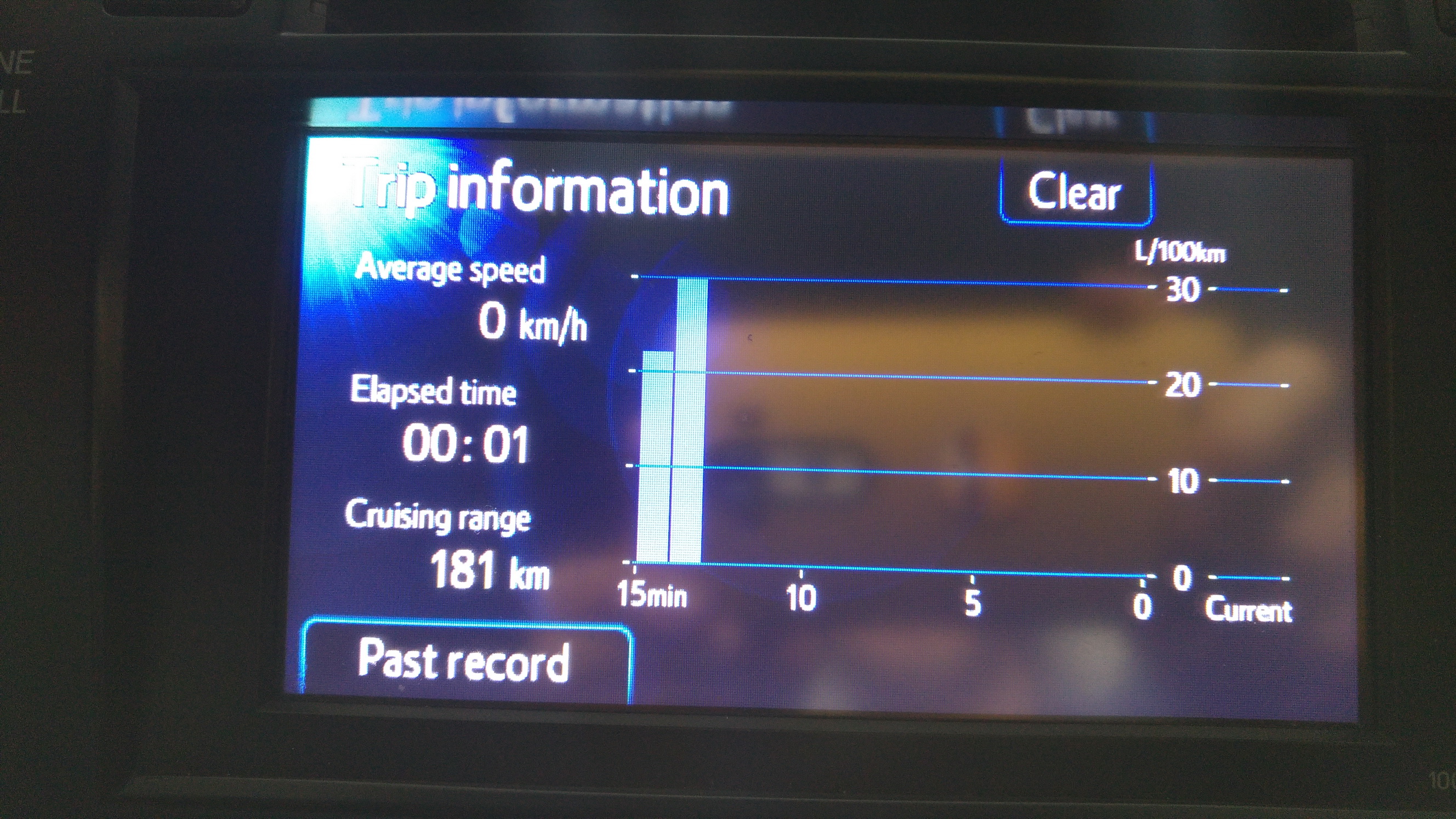

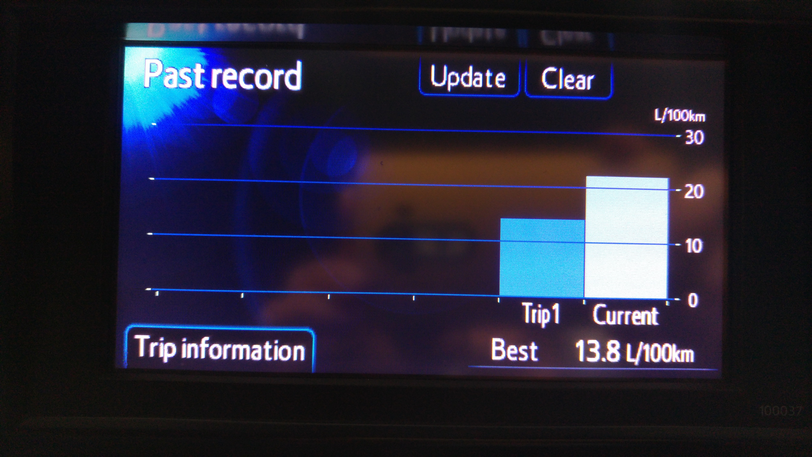

Ok, today i was driving a bit  around city area the speed average was 60 km/h and then going to my friends place on freeway, speed between 80 to 100 km/h for about 60 min going and coming back home.
The computer now showing average 11.2L /100km consumption and Eco drive 8.5L/100km. And average speed 40km/h. And I remember when i was driving around city area only with traffic lights. The average speed showing on the computer was around 6km/h. I think something is off.
https://goo.gl/photos/WqHgPudGWmJih6KN9
