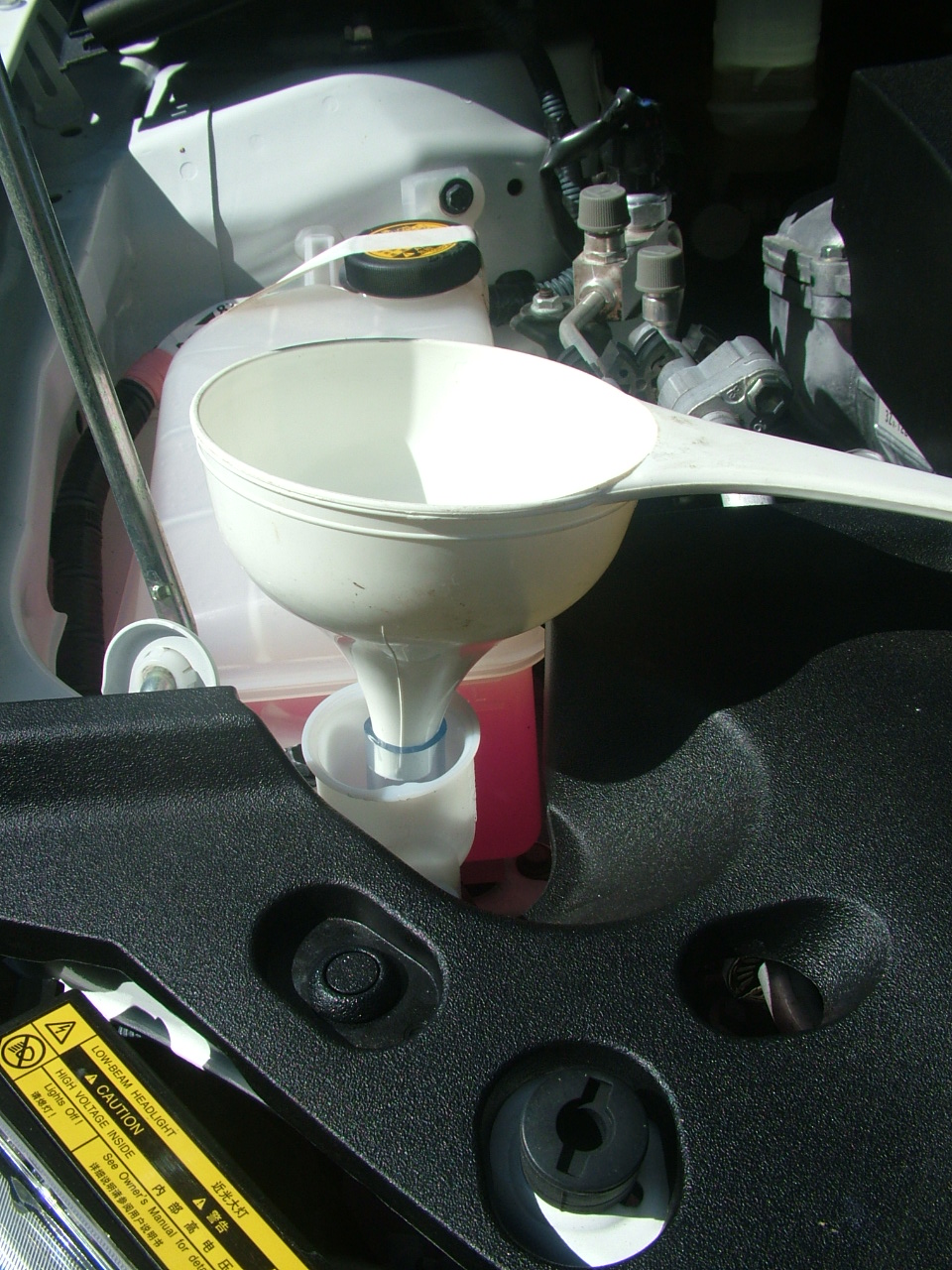

FILLING WAS SLOW
Filling my windscreen washer reservoir used to be slow, because of heavy foaming.

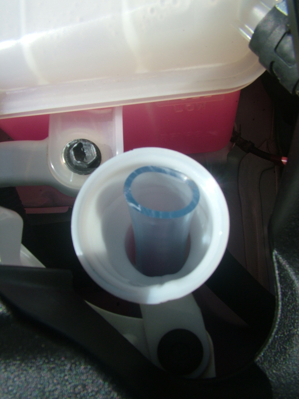

SO I MODIFIED MY RESERVOIR
I have permanently pushed some PVC tubing (thin-walled, 16-mm ID), all the way to the bottom my reservoir.
Consequently, I had to discard my filler cap’s sight-tube (no problems).
FILLING IS NOW FAST
I now fill my reservoir through the PVC tube, with a funnel.
This “Fill From The Bottom” method is extremely fast, as it eliminates foaming.
