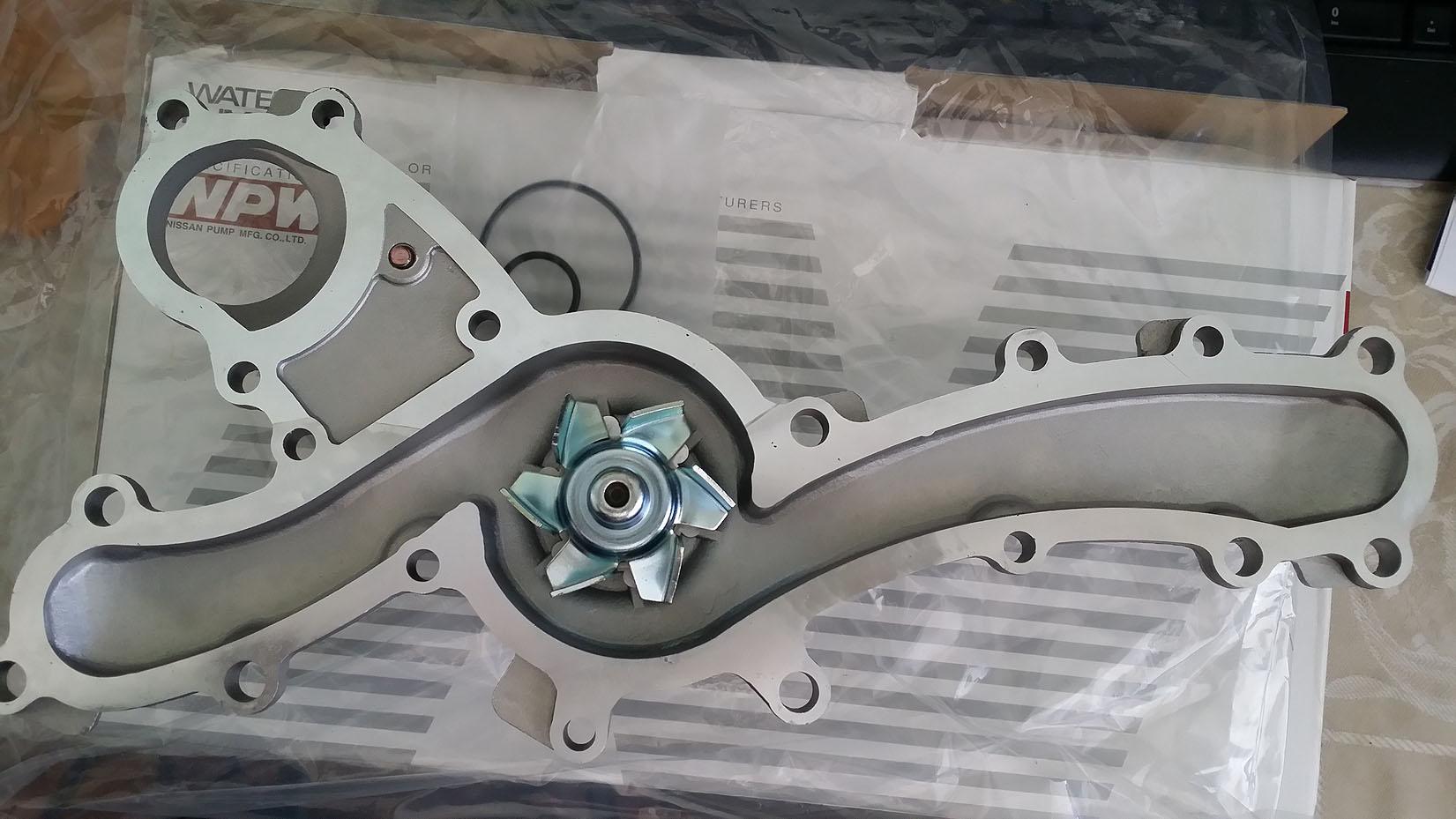

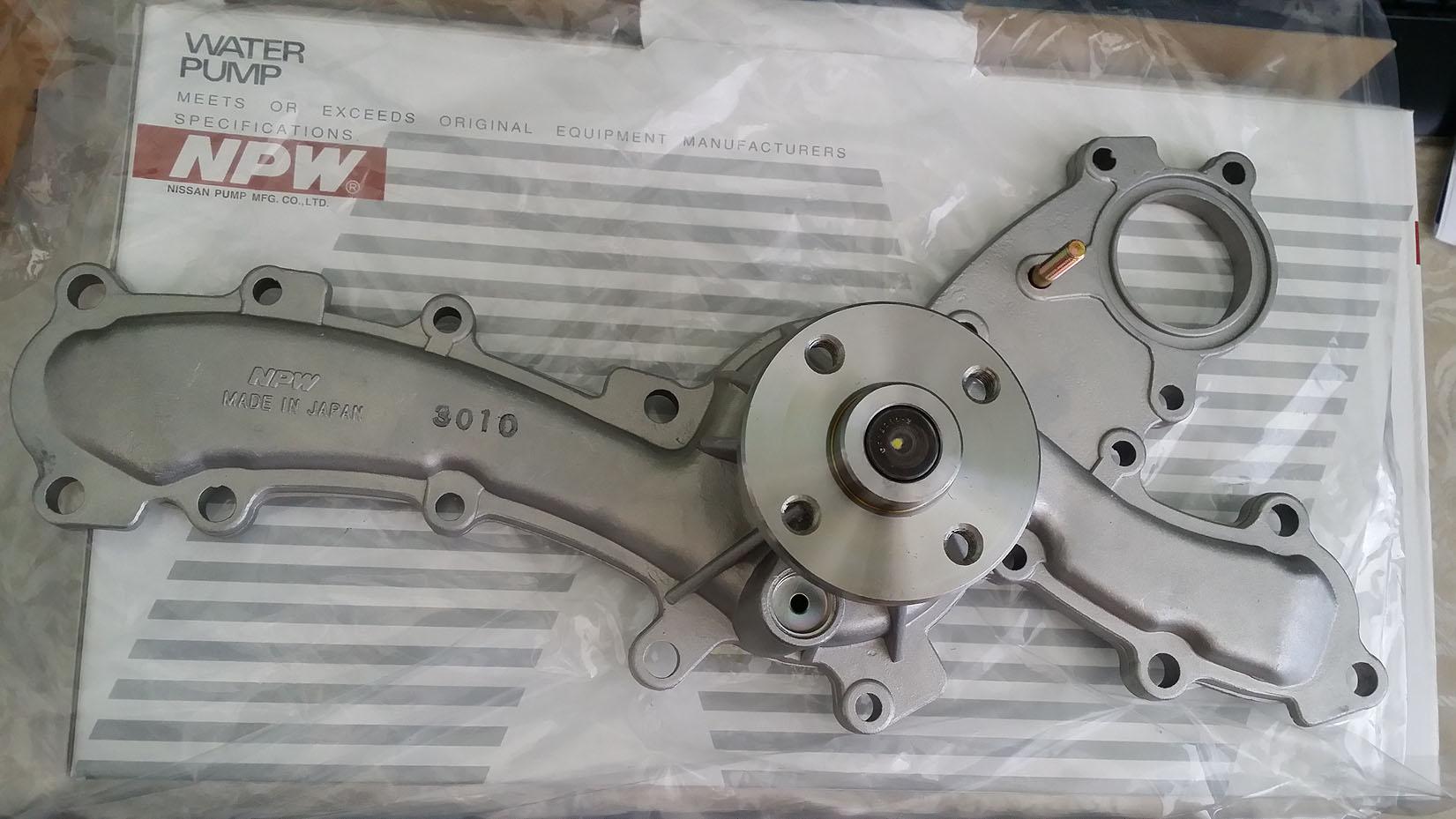

I decided to open the box up and inspect my new replacement water pump by NPW. It looks well made, a little rough in parts of the casting but overall looks like a quality item. Impeller looks to be zinc plated I think so it doesn't corrode ? Good coolant should keep corrosion away anyway.
It also came with the gasket and some O rings. I also have a Genuine Toyota Gasket too.
Does look good quality Tony..thanks for the Pic's, so how long can you contain yourself before fitting it?
Yes Robert it does actually. The fact it's also made in Japan gives me more confidence in the product too.
