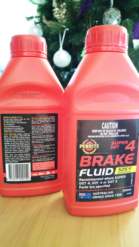

Yeah, I'm planning to do it with a friend of mine. Today went to Repco and got Penrite Super Dot 4 for $6.99. I think it is a very good price. I'll see how I go with it. And next time may be go back to Dot 3. There are some good deals happening with SCA, Repco and Autobarn at the moment :)
