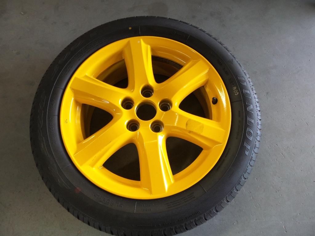

Hey guys I'm currently running trd aurion 19s on my 07 Camry sportivo. I'm not sure what the trd have but do you have 19s as spare wheel in the boot
question I wanna know is it possible to fit a 19inch wheel in my boot as my spare which currently has a 17 inch spare
The TRD Aurion has a Camry Sportivo 17 inch rim painted yellow.
Diameter-wise it should fit, provided you haven't altered the rolling diameter.
What size tyres do you have fitted to the 19's?
So I wanna buy a kluger wheel which is running same tyre what I'm running 245/45/19 but not sure if it would fit in my boot
Should have a rough overall diameter of 700mm. The width should be roughly 245mm. A quick measure from the floor to the masonite sheet should get you on the right track.
The other option is to pull one of the wheels off the car to test fit.
I only say this because I wouldn't expect that many people; if any, would have gone with a 19 inch spare.
