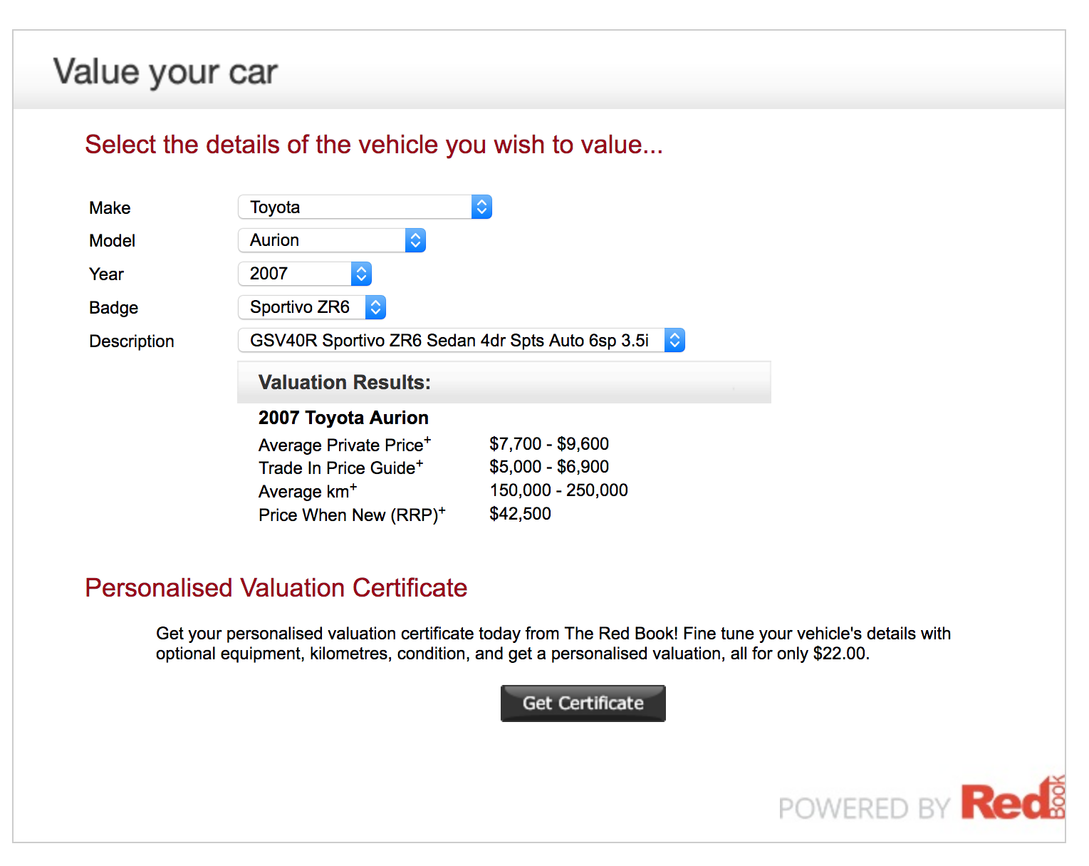

Thanks for the advice guys I was looking at the 2007 models this one in particular see link below but I think he asking way to much what do you guys think ? the hard parts is finding one that is not Silver or white lols, But will look into the later 08's and above
https://www.carsales.com.au/private/details/Toyota-Aurion-2007/SSE-AD-4547796/?Cr=11
No chance for anywhere near $15K. That being said, I'd personally never own one again.
The other issue to be aware of is the melting dashboards.
Had the melting dash board in my Camry nothing a dash matt could not hide trentmeyer23  what issue did you with your Aurion ? the one I was looking at I was going to offer him something $7500 if its still for sale when the time comes
Edited by Buddah Kahuna
Personally, I wouold not have difficulty puirchasing a 2007 model, provided it has been regulary serviced.
Also I consider anything under 150K on the odo. would be OK. However a transmission oil change ( see previous discussions) may be in order.
My guesstimate is something around $8-9 thousand would be a fair price. What do others think?
