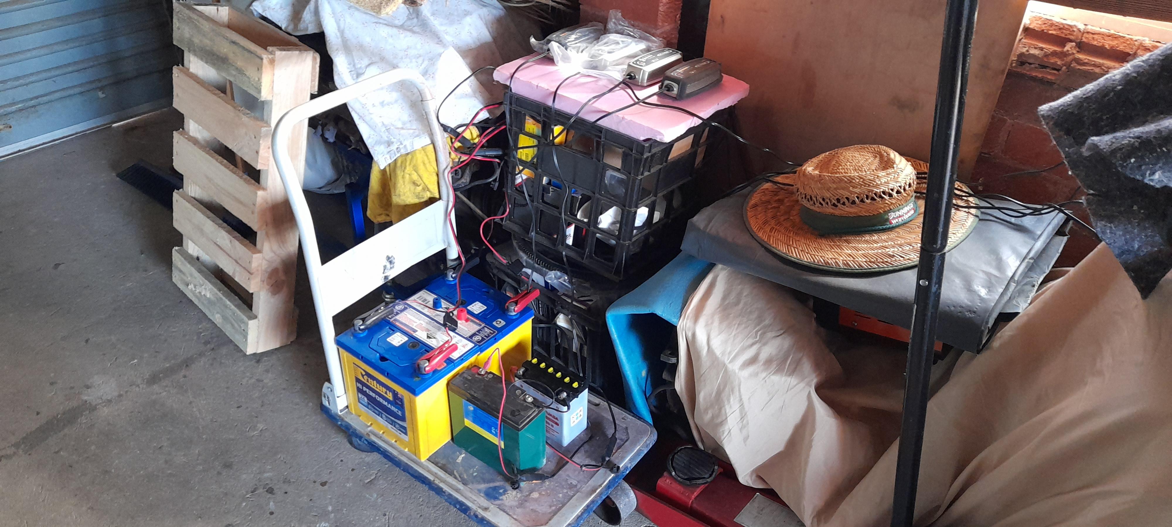

I did end up swapping out the leaky post battery with that spare new one I purchased last November. It kept playing on my mind, especially when you see the powdery residue trying to eat the battery terminal clamp. I have since retired it to the garage where it sits on a trolley with 4 other batteries doing time on individual C-Tek chargers.  I keep them trickle charged for best health.
Pictured here are 4, but have added another since, so 5.
My Century NS70L MF battery was actually purchased back in May 2017 and went flat again Saturday so the new SuperCharge Gold Plus Truck Battery - MF80D26L has now been fitted.
My Century 75 D23L MF battery was purchased in June 2019 and it now needs to be re-charged.
Looks like I am going to have some fun over the next few weeks/months using my C-Tek charger to try and rejuvenate the NS70L MF battery.
