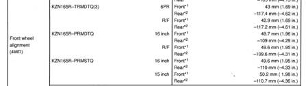

Spent some time playing with lifts on my KZN165R.  Ended up back at standard height as lifting it ruined its ride,  handling and flex off road.  I found it very difficult to find what standard height is but finally got measurements direct from Toyota (attached).   At least it will give you a starting point as most Hilux’s have been played with but as I said best ride and handling is standard.
Standard diameter tyre is 738mm diameter (29.1 inches). You can legally increase diameter by 50mm  so 31s (788mm) are the largest legal tyre you can fit.  Bigger than that and there is no point insuring it as they can knock back your claim due to your vehicle being unroadworthy.  That includes comprehensive and third party.
I do believe 31s fit with no issues. No lift required although legally the speedo has to be recalibrated.
