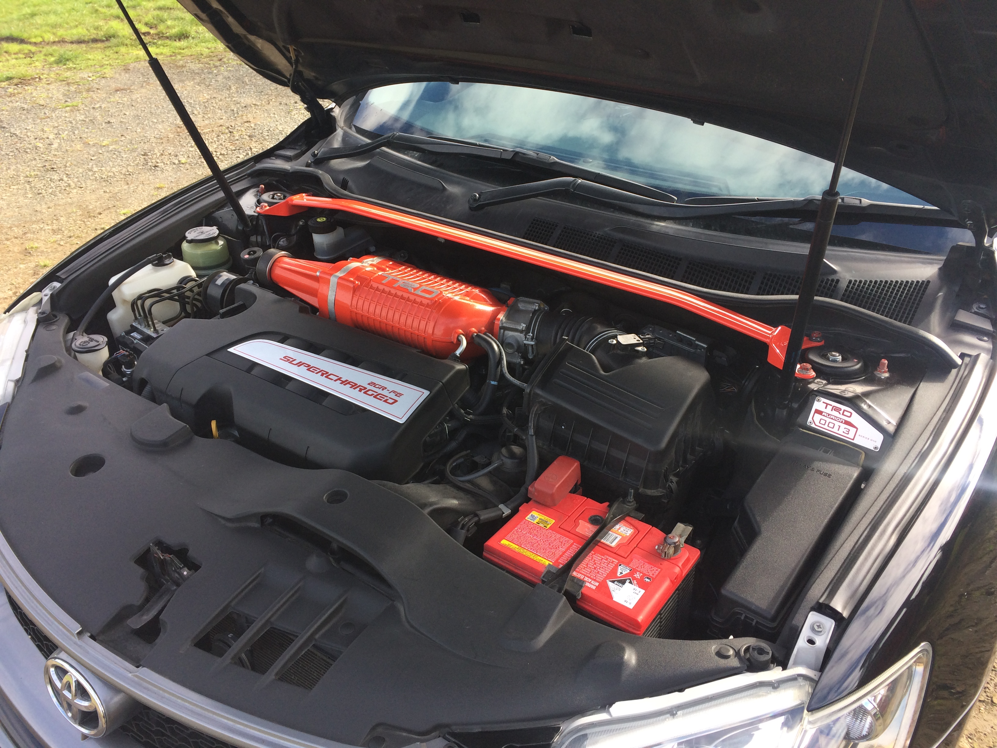

My TRD Aurion is at 138,000km right now and increasing at 60km daily.
I live in a rural area so my TRD Aurion is driven enthusiastically and it has not missed a beat.
The only component that did get changed very early on was the automatic belt tensioner, and that was done under a mechanical warranty. In NZ the automatic belt tensioner was roughly $300.00. My TRD Aurion doesn't seem to use any oil or hasn't needed a top up between the 12,000km service intervals.
I would also recommend making sure your wheel alignment is correct, as the front tyres are working very hard. The 245/35/r19 tyres are also an odd size so it could be expensive. Currently I run Goodyear F1 Asymetricals and they are now down to 3mm tread depth from approximately 20,000km worth of driving. Please note I am not sure how long the previous owner had the tyres on before I purchased the car.
If you are looking for power modifications I would not bother as it is expensive and the gains are generally not there.
I do recommend you upgrade the front and rear sway bars as I found this assisted with the torque steer, in my opinion. I also had a strut brace installed. The automatic transmission sometimes does not kick down as quickly as you like, it almost seems like turbo lag, in certain situations.
Fuel economy for my TRD Aurion is between 10litres - 11.5litres per 100km and it must be filled with 98octane.
I really like my TRD Aurion, it is definitely a compromised (slightly flawed) vehicle but it is a lot of fun because of this.
