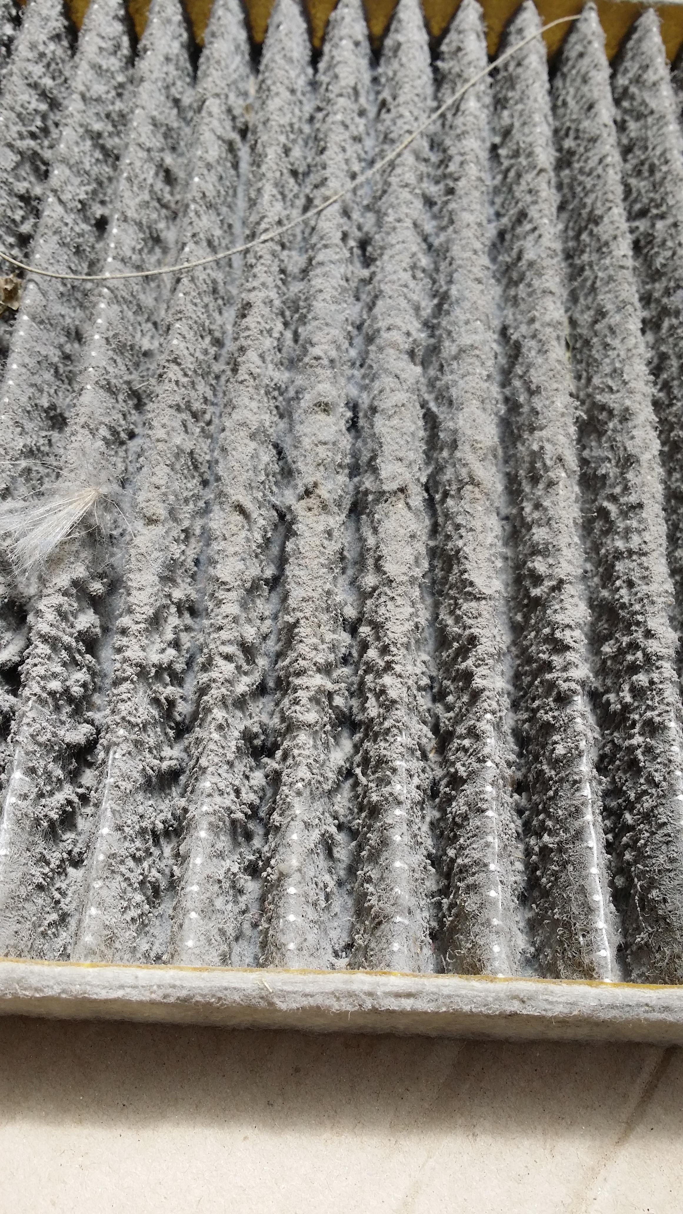

Just checked mine. Not too shabby. I gave it a vacuum for the meantime pending replacement.

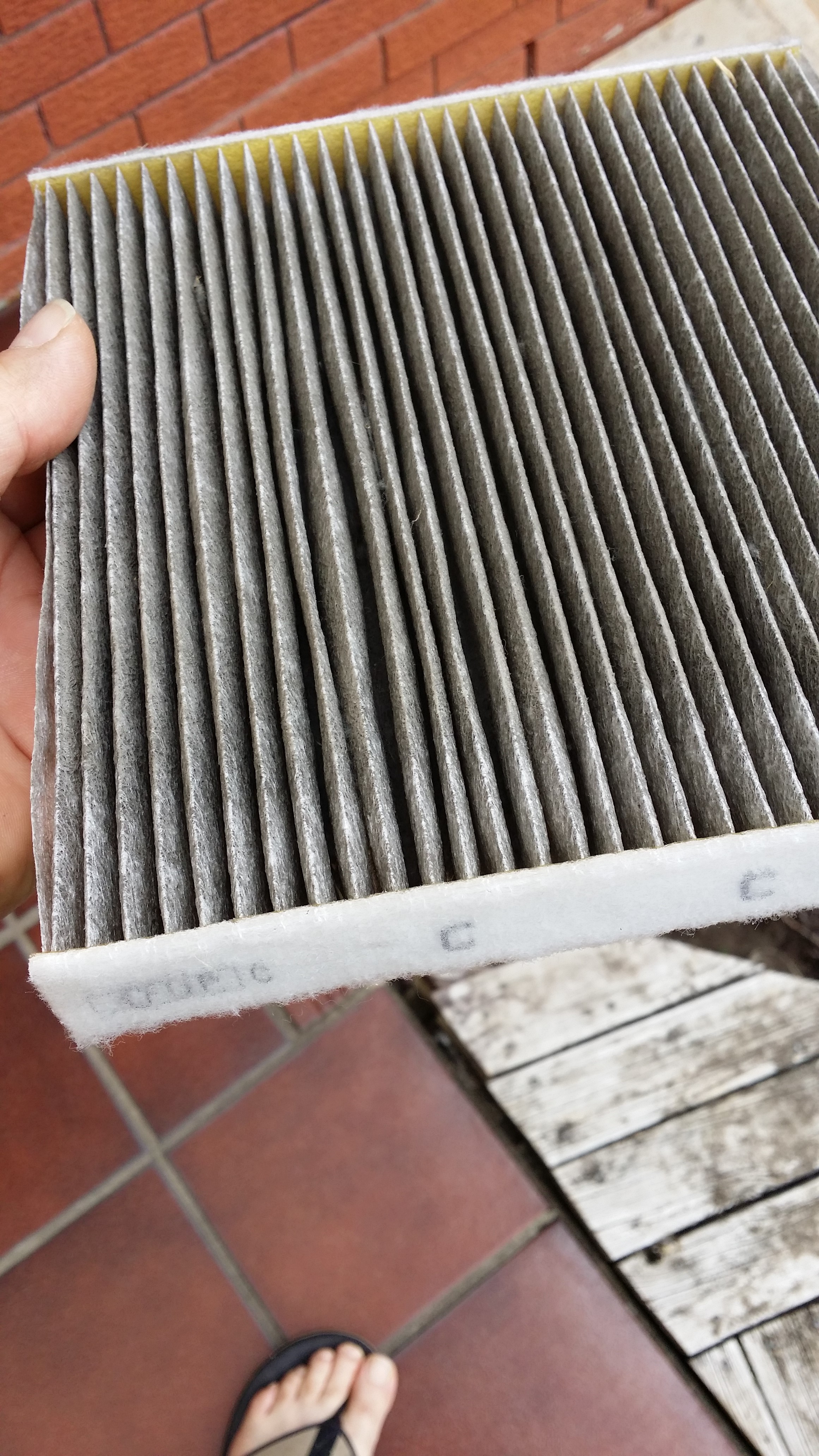

Removed and cleaned the filter material. It used to be white but now a slight grey colour. Airflow appears to be a lot better now. I decided to buy that cheap AliExpress filter reasoning that I can replace them about every 12 months or so.

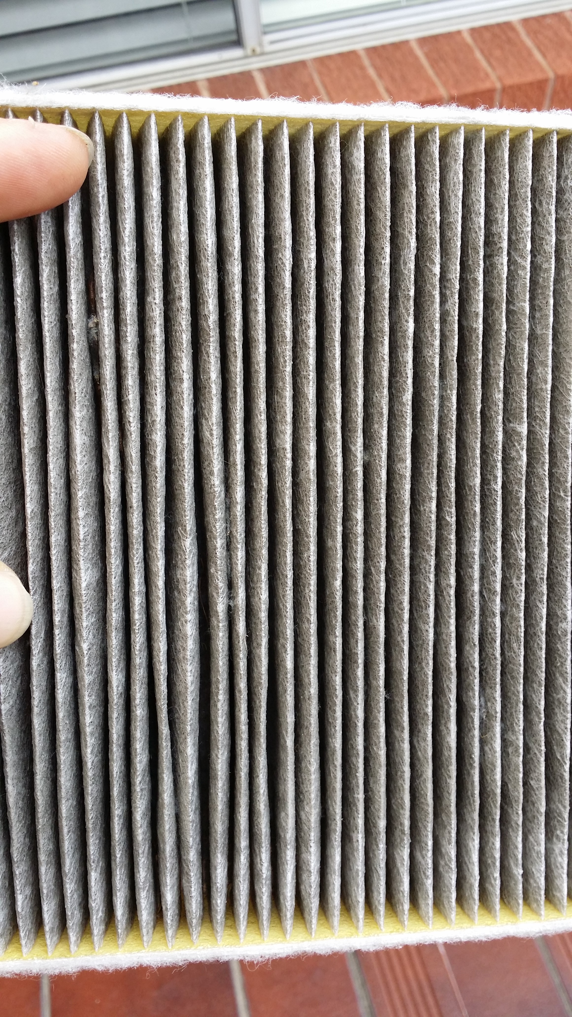

Just as I suspected the cabin filter in my Hilux was pretty bad. I gave it a vacuum and then cleaned it with the garden spray hose. Hung it to dry and was fine after this. The air off temp improved by 2 degrees Celsius.  Was dishing out around 7 before, now a solid 5.
So a blocked filter will not only stifle the airflow but affect the air off temperature too.
This is very heavy used, looking filter, :ohmy: spraying with a garden hose, I don't think would be enough. I would soak it in some kind of antibacterial soap or spraying it with Glen 20 or something similar. Also can soak it with vinegar.
