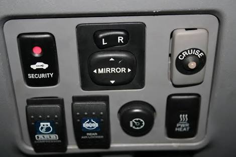

Do you not have the rotary switch, second from the right on the bottom row? My 2013 SR has it and this is the dimmer switch.

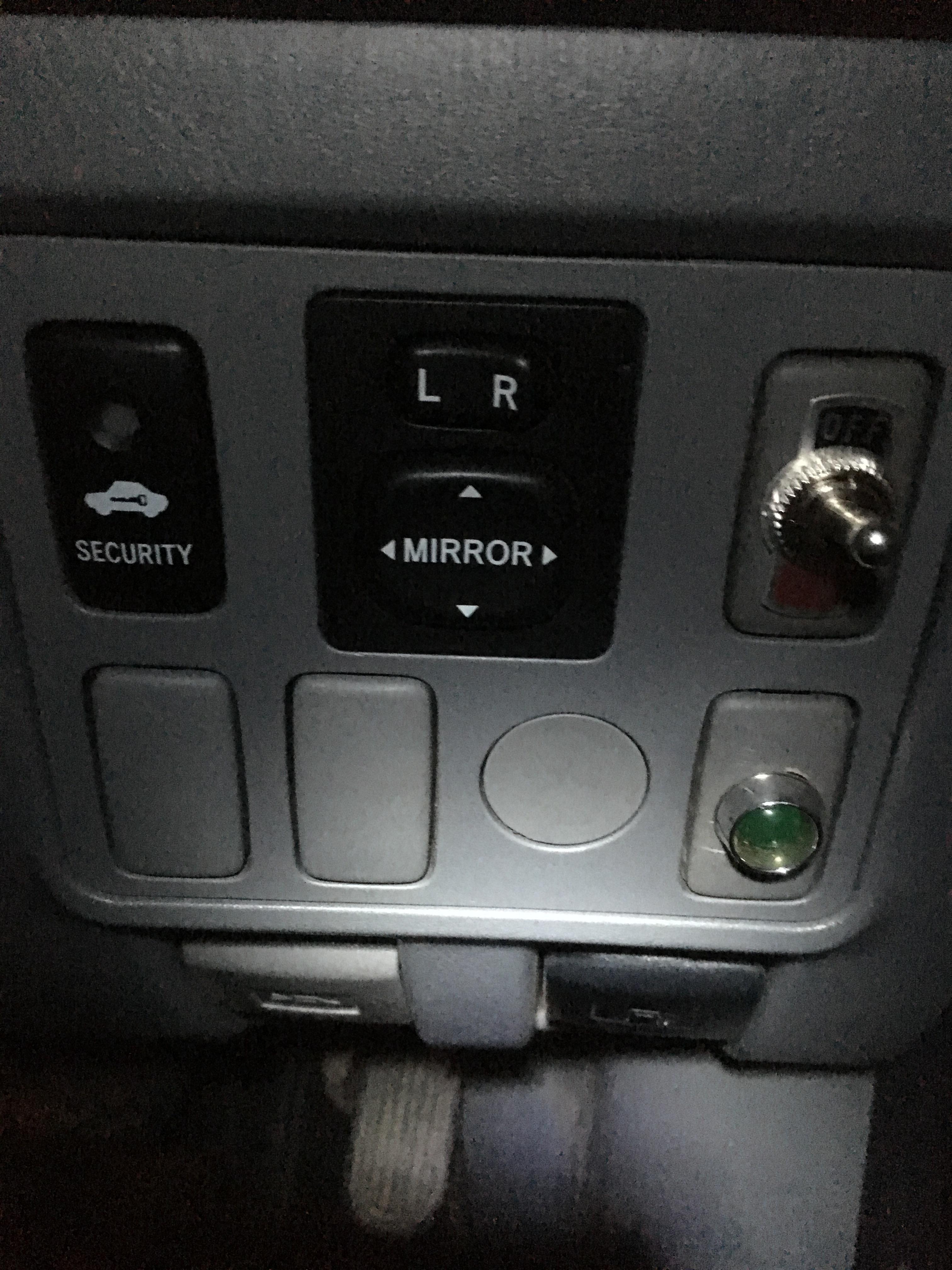

The 2011 SR doesn't have the rotary dimmer even though the provision is there.
I wonder if the wiring loom to connect to a switch might be there though because it would seem odd to not have the same basic loom across the three models even if every lead isn't connected.
Thanks for those replies. I see that they are earlier dates,..2008, 2009. etc that cover the subject.  My SR is 2011so obviously Toyota still chose not to have this rotary dimmer switch seemingly until your 2013 model.  It will forever baffle me why it was never fitted right from the start.
