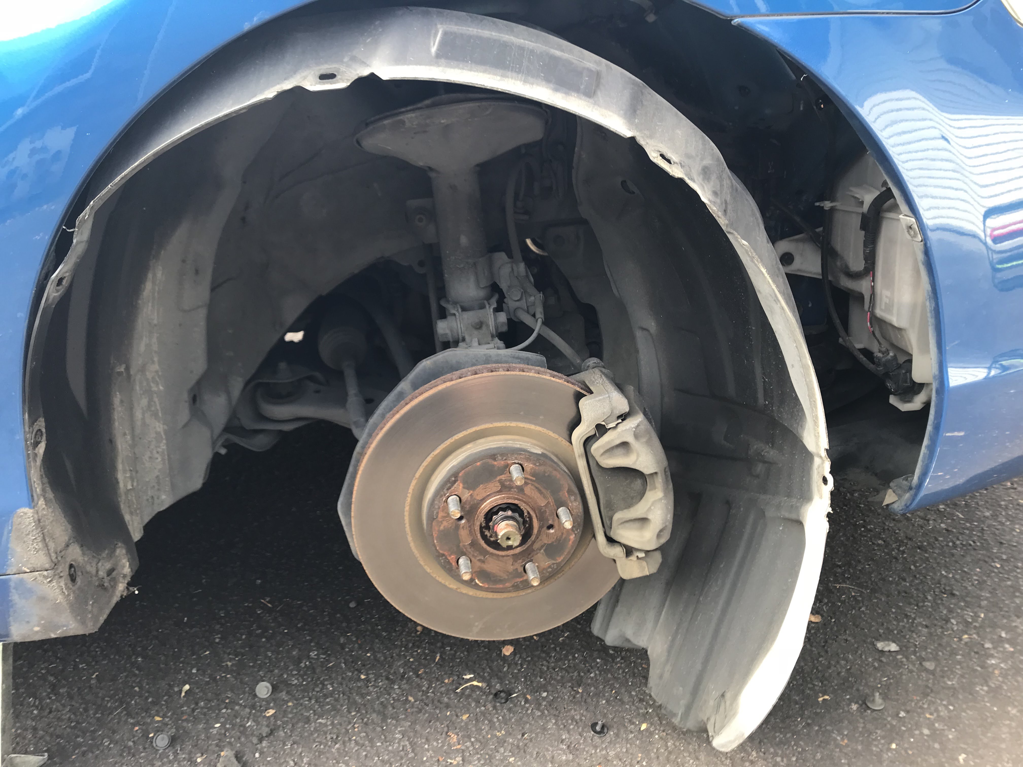

I am planning upon replacing the front W5W parking light bulbs with LED bulbs. Possibly also the door light bulbs with upgraded halogen bulbs.
It looks like I will have to remove the plastic inner wheel guard to gain easy access to the headlight connections. Is this so?
I also want a whiter light so I have ordered on eBay both white light halogen bulbs and canbus error free LED bulbs with 10 5630 SMDs.
Has anyone had experience with fitting this type of LED bulb?

I replaced the park lights with cheapo super white LED one's off eBay.  Can't remember brand but they were very very cheap and they're great.  Pulled plastic wheel arch covers off and probably took 20 minutes a side. Less time next time as I know what I'm doing!

Finally fitted the right length LED bulbs. These ones with a 34mm length just fitted as parking lights.
https://www.ebay.com.au/itm/2x-T10-501-194-W5W-5630-LED-SMD-Car-HID-Canbus-Error-Free-Wedge-Light-Lamp-Bulb-/232705017248?hash=item362e4cc5a0
Light is a bright white colour which is what I wanted instead of the original yellow looking [warm white] colour from the halogen bulbs.
