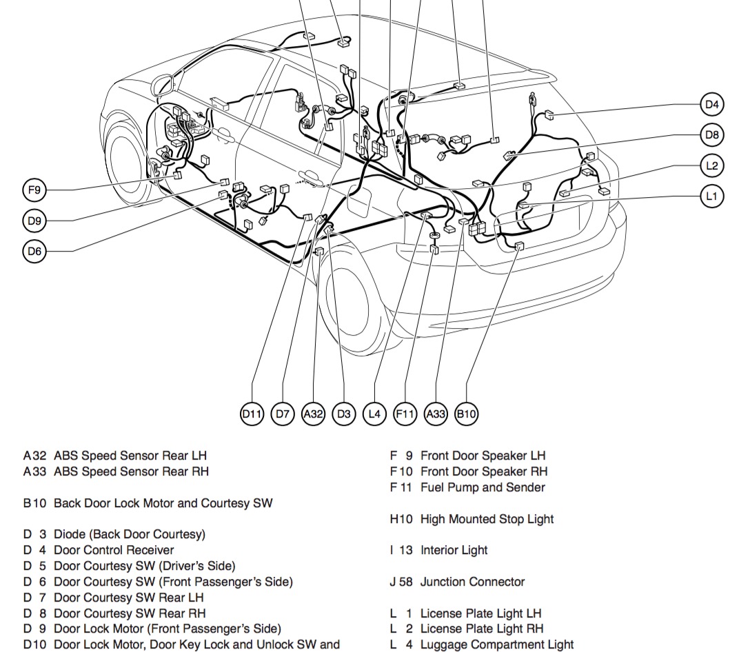

The workshop manual shows the receiver in the rear pillar behind the rear passenger pillar on the driver's side.
Looking in there, there is no receiver, and no wiring harness for it. See Item D4 in the attachment.
Is it possible it could be located elsewhere?
It's not necessary to install an alarm on this car. I don't want to go to that expense. I want my missus to be able to walk up and unlock the car so she doesn't have to fiddle with a key on a busy street for example.
