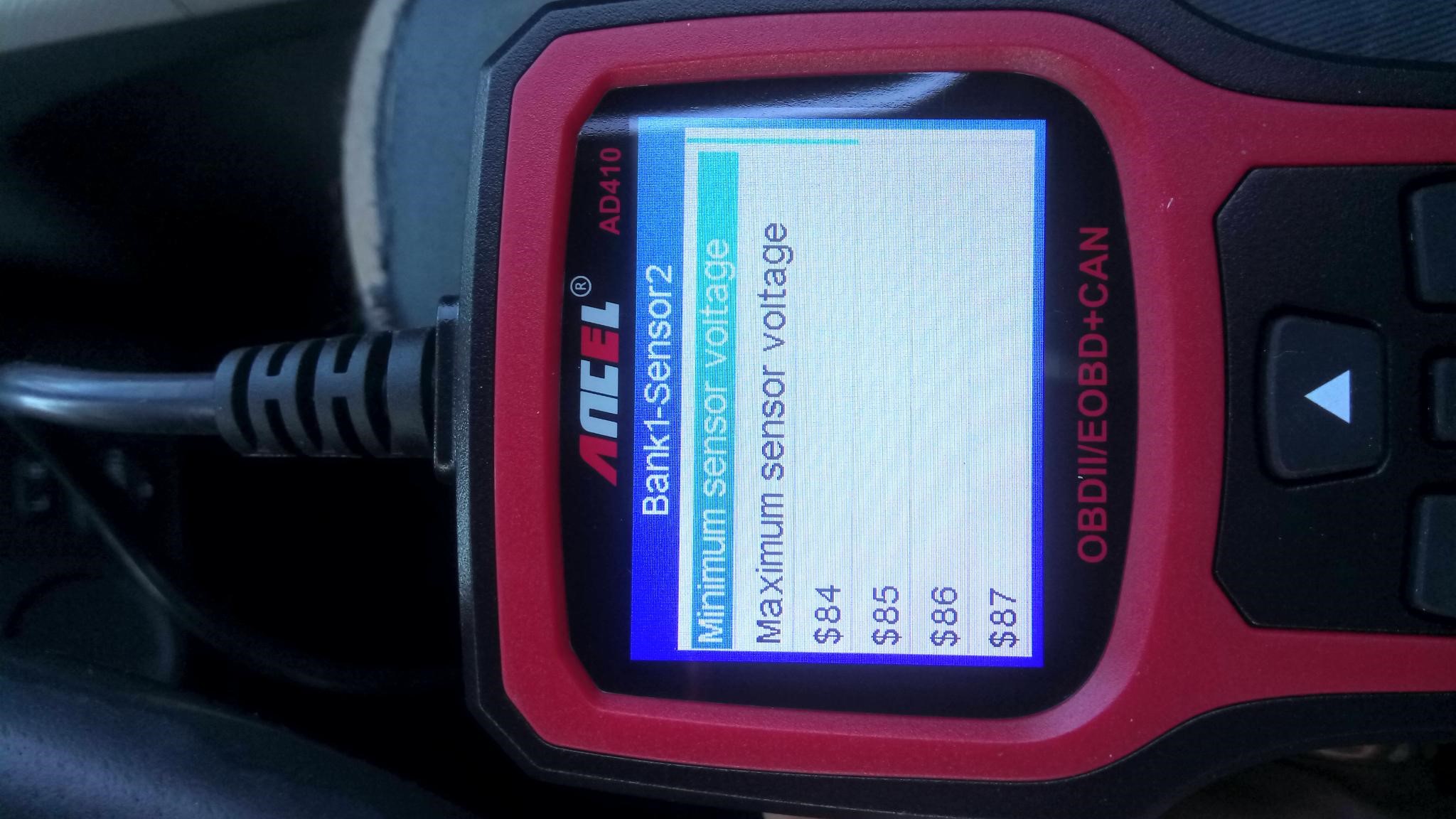

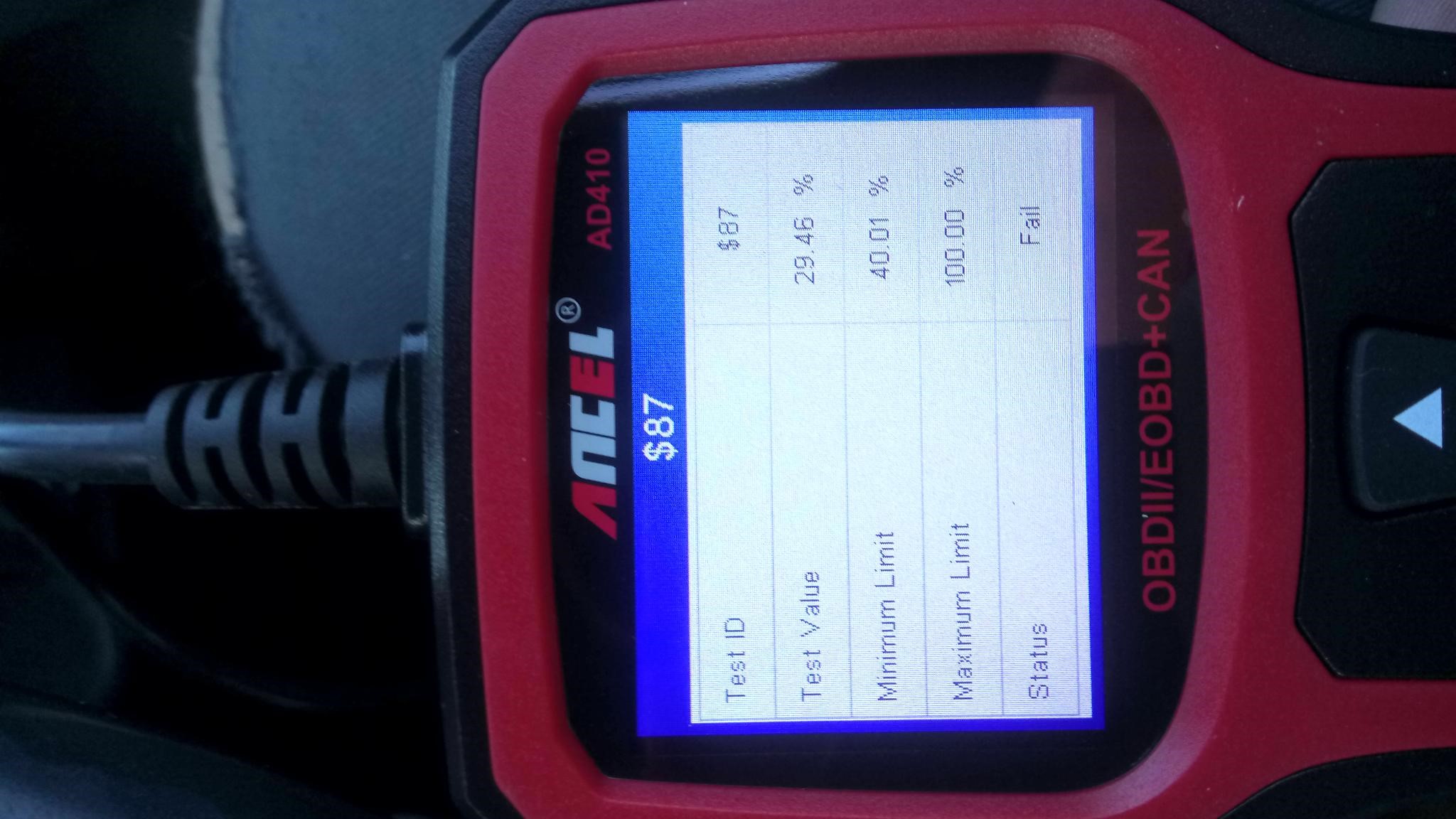

I have bought myself an ancel scan tool, which is really cool, and it shows no codes, but did show a fault with o2 sensor 2. Doing the test it shows 7 or 8 values that it tests. Although I have absolutely no idea what they mean, the values $86 and $87 are a fail while everything else is a pass. I'll post pics of the fails.
I did the scan tests on absolutely everything when the engine was cold but the power on, then again while the engine was running but warming up, then again when the engine had been for a drive for approx. 20 minutes.
Without codes being thrown, does this show definitely that bank 1 sensor 2 is up the crapper?
