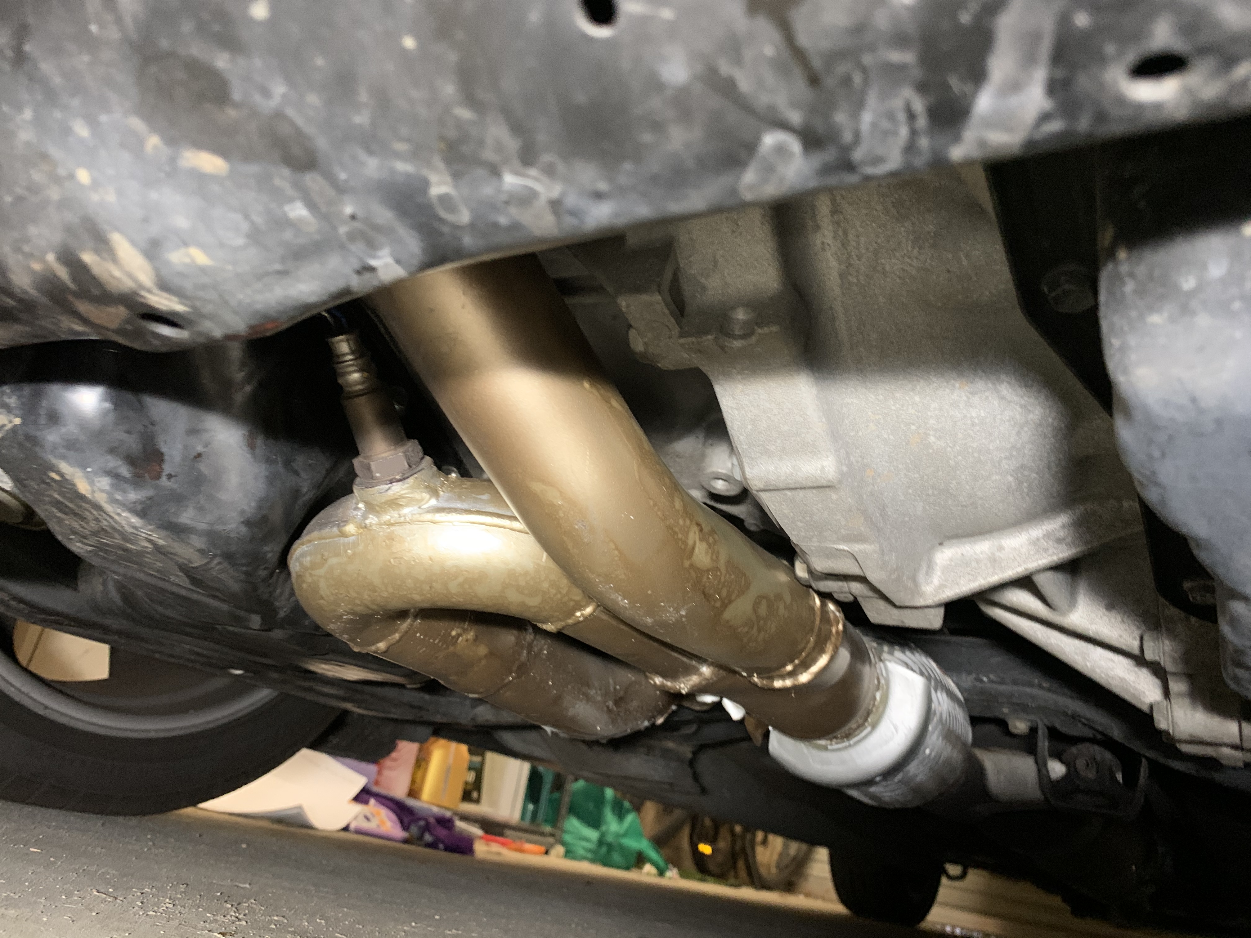

Well...y pipe and mufflers are done! Have done a couple of pulls and in all honesty, can’t notice much of a difference in the power/torque curve (possibly pulls slightly harder in 2nd gear?) - may need to give the ECU some time to accommodate. Can’t seem to generate any axle tramp so there’s certainly something wrong 😄
As for the mufflers - was hoping they’d add a bit more to the high end, but they’re slightly too boomy for my taste. Can’t hear any difference at all over the intake once the car’s past 3000rpm (even with windows down), but no drone on the freeway at least! A bit drone-y in city traffic... Will try and get used to them but may end up palming them off to my brother and swapping the stocks back in (yay for flanges!)
Will post another update once I’ve had it running for a week or two with much more accurate findings!
EDIT: added image.
EDIT 2: Unpluggged the battery, reconnected and gave the car a couple of longer trips. Starting to get used to/enjoy the sound but still can't really perceive any power gains up top or down low (in all honesty, feels like a bit of a power loss 🤔)
Edited by donnot
Y pipe looks good. While the rears should free up the exhaust a bit, it's only gonna flow as good as the bottleneck exhaust behind it.
A single 3" starting from the last cat all the way to where it splits for the rears is ideal for for this engine.
