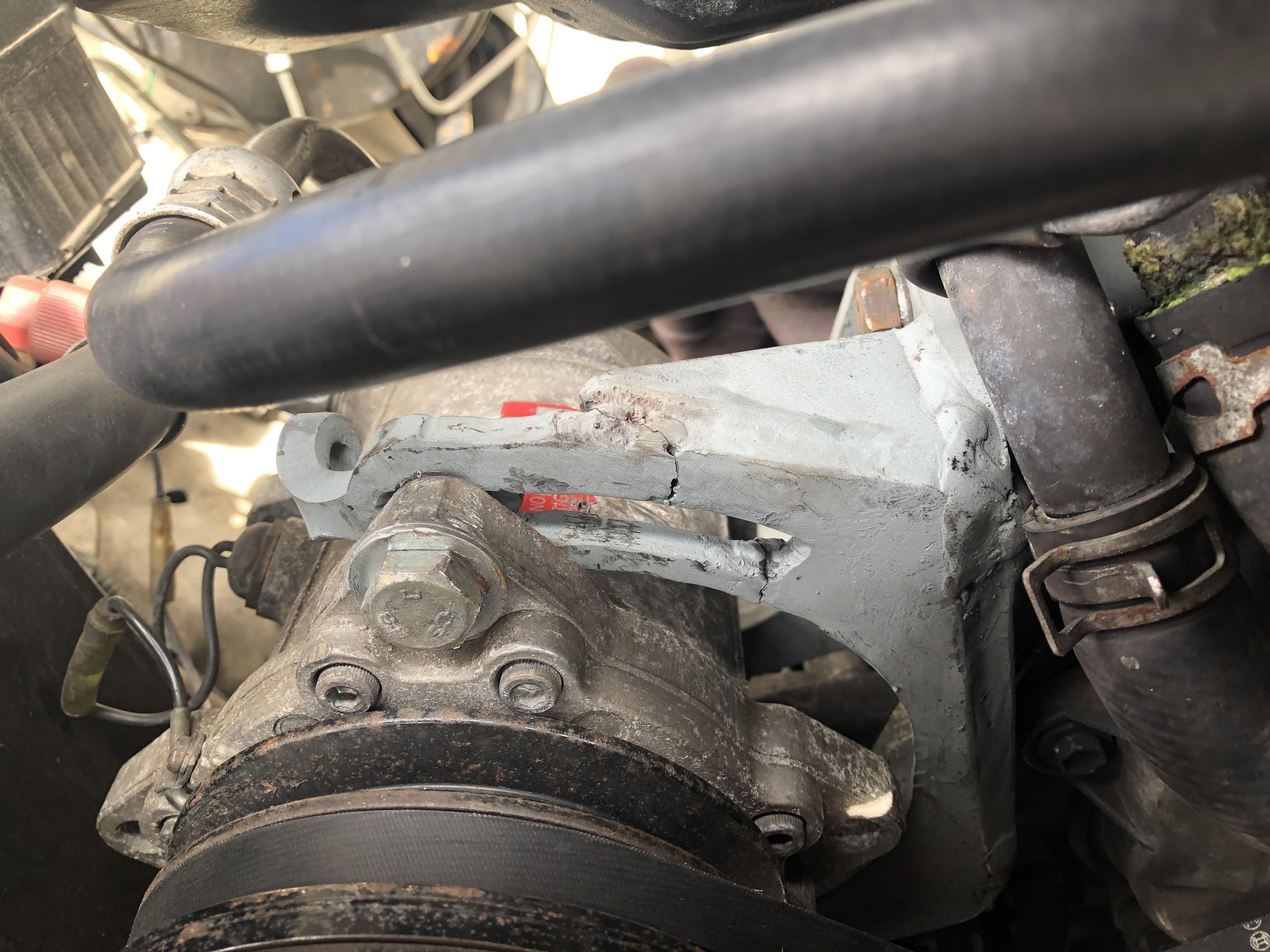

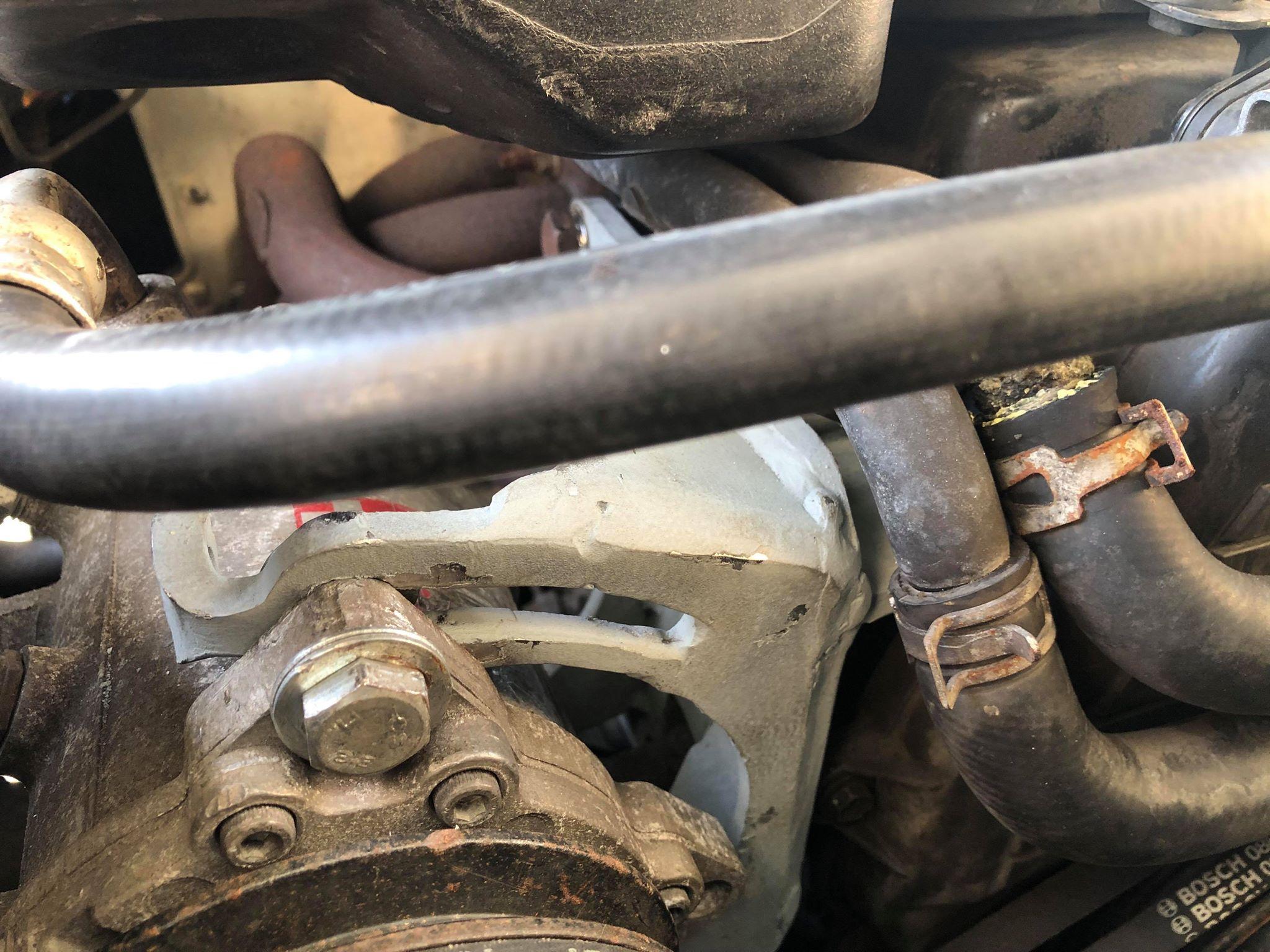

Hi all, recently bought a 98 dual cab diesel ute the previous owner had air conditioning installed as it didn't come with it from factory anyway the bracket has cracked
does anyone know if i can buy one from another model that will fit? Ill get better photos today after i take it out
Thanks
Sorry to tell you mate but that bracket looks custom made. All Hilux use a direct mount compressor and the one used is what we call an ear mount. If you want to keep your setup you will be best off taking that bracket off and taking it into a local fabricator to make a new one. Alternatively if your willing to put in the extra effort find a wreck with factory air con and take the bracket and compressor out of that and adapt to yours.
Any Hilux with a 2L, 3L or 5L diesel with factory air con will bolt up to the same holes on the block.
Edited by Jwaye2
As is my air cond set up, I too was under the assumption all compressors are direct mount fixed brackets and the belt is held snug via an idler pulley. That bracket looks like my alternator bracket on my little workmate
Ah righto good to know my options thanks for the info Jwaye2
