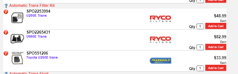

On the supecheap auto website, one of them says " Toyota U250E Trans" - just wondering when they say "Toyota" is that OEM? and better than the RYCO? ( even though its cheaper than the RYCO?)
Edited by 20ten

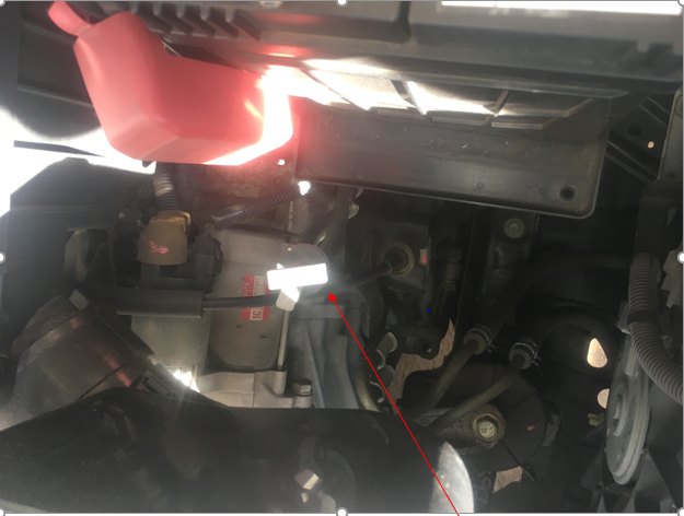

20ten, u250e should have a dipstick, from memory you'll find it on the passenger side in the engine bay and you should be able to refill through the dipstick hole using a funnel if it's the same as the 4 speed version.
And that 33.99aud filter kit isn't Toyota OEM. Don't bother with it, for the filter and gasket I'd go with Toyota, try to get a quote from your nearest dealer.
Thanks heaps for pointing that out. Adrian... i just assumed the 4 speed transmission didn't have a dipstick aswell
is this the ATF dipstick? the one beside the battery
would you know where the drain plug is for the ATF on the U250E transmission?
