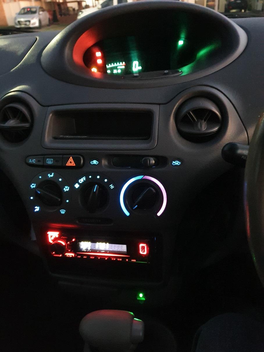

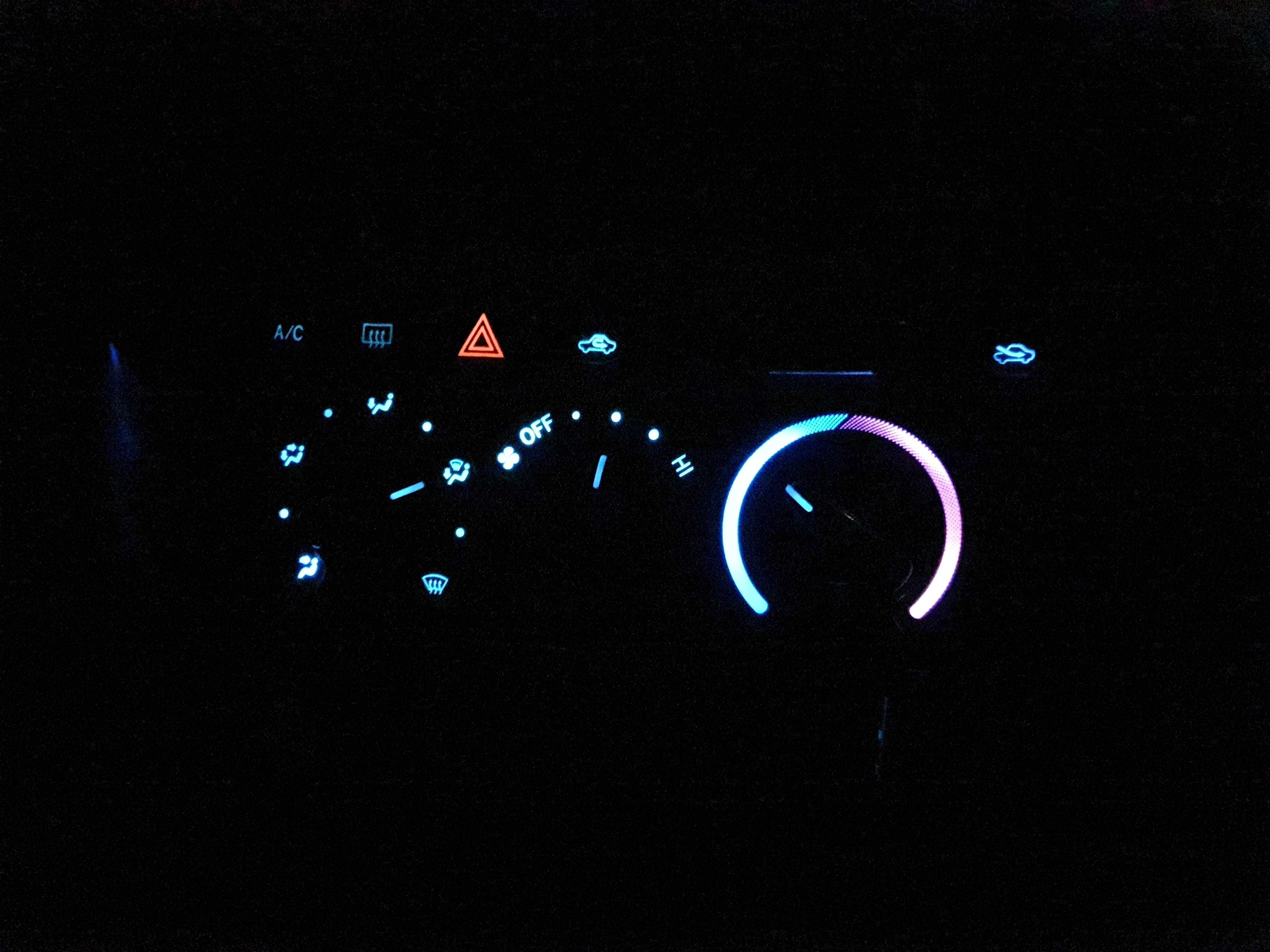

The heater controls look good with the blue LEDs, but I also had to add a few LEDs as the LEDs are very directional and tend to point ratehr than spread.
It was as simple job of finding the positive and negative feeds on the flexable PCB and then soldering a feed to them.
Then I glued in some additional LEDS. Ill take a picture of the back when I get the chance.
It even lights up in daylight now, looks cool.

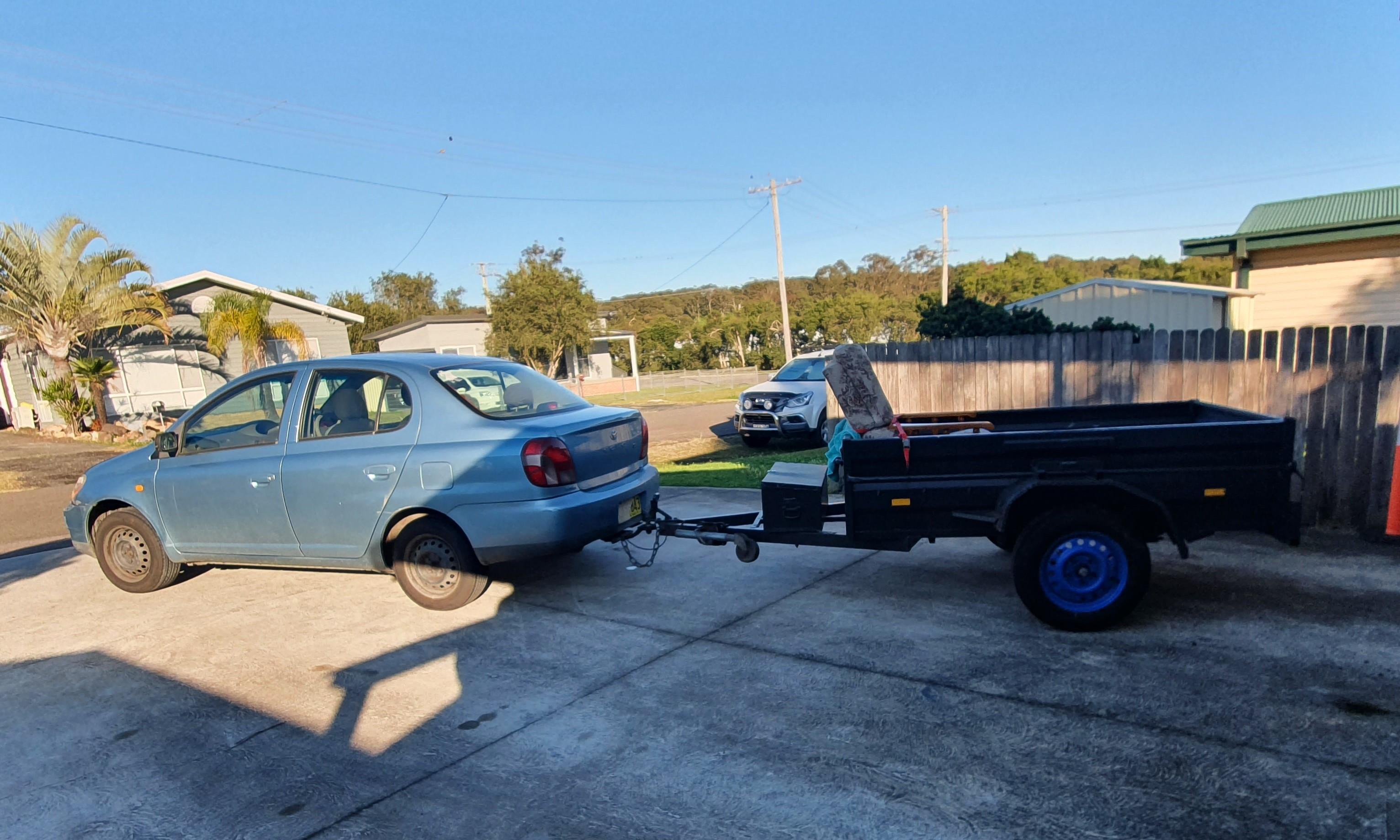

I hooked up the trailer and did a trip to the tip yesterday.
Surprisingly, the old ECHO towed it quite easily, and even braked quite satisfactorily and safely.
I towed without the overdrive engaged and I'm not sure about fuel usage, but it didn't notice the trailer all that much.

Those blue lights are looking really good in the center console!

Never thought that the Echo could cope with towing! Is your Echo an automatic?

But for a lark , and the fact that I have a tow bar on the Echo, I thought Id give it a go.
My Echo is an auto, so I turned off the O/D, but overall it didnt seem too worried.
Wouldnt like to tow anything serious though.

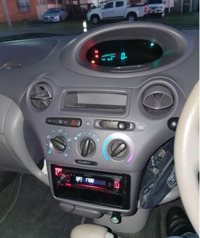

Works a treat, but it has RED back lighting, I think I can change it will see tonight.
Talk about easy, its a 20 min job to get the old radio out and the new one in.
But my dash now looks like a xmas tree.

 It looks very colourful. Red backlighting on the radio certainly is different.
