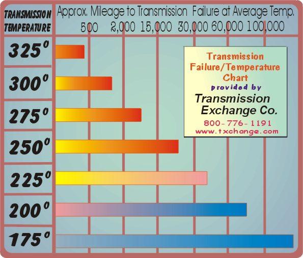

I am not an automatic transmission specialist but I do know how to do internet searches.
Following URL indicates that the speed sensor can fail due to the transmission overheating.
https://maktrans.net/Dattchik-skorosti-AKPP-U660E-Toyota-Camry-06-up-RAV4-09-up-Avensis-09-15-Highlander-13-up-Avalon-07-up-Lexus-ES350-06-15-NX200-14-up-RX350-09-up-8941333030-B-U
Bad news is that this component is internal. It is most likely located near the valve body so hopefully can be accessed without having to remove the transmission.
If you have overheated the transmission then the ATF will also need to be replaced.
You will be poorer in $$$ from this experience. If you want to do stupid, then get yourself another car e.g. Ford Turbo XR6 then blow up the turbo [like my son].
