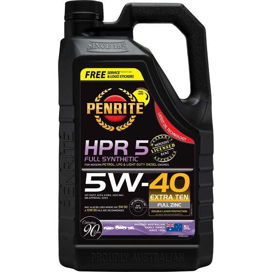

Greetings Gents, I cannot find the other topic about Aurion Oil and spec, I know I've seen it but can't locate it. So I'm starting this topic about my experiences with Penrite 5w40 Engine oil. I decided to go with Penrite based on 2 things, it's Australian made and owned and Because of the spec of fully synthetic 5w40. This will be the first oil change I have done since owning it for 2 months. Don't know what was previously used in it, probably multi grade I'd say. Bought 6 litres of this penrite for $72 at repco, also bought a 1ltr. So have 7 ltrs for the mechanic to fill the 6.1 Ltr  oil requirement. I will post my observations periodically about how the car feels and the  consumption,etc.

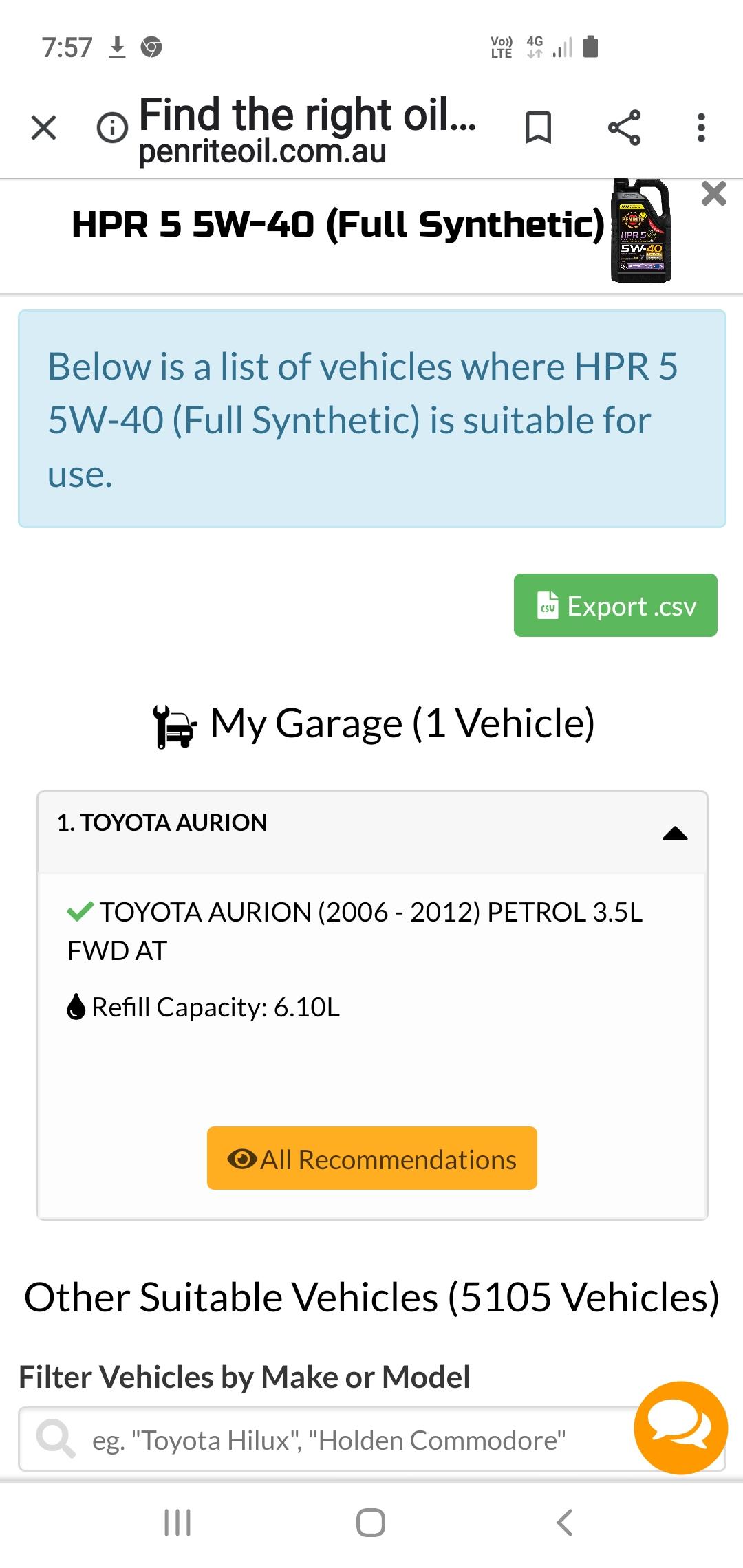

Hi everyone. I've been using Penrite HPR 5 Engine Oil - 5W-40 6 Litre https://www.supercheapauto.com.au/search?q=Penrite+HPR+5+Engine+Oil+&lang=en_AU for many years now, first in my Aurion and now in my Kluger. It was recommended by the shop staff and to be honest, it does the trick for me. I don't know much about oils but to me, the car seems to idle/drive smoother when I change to this oil.
It's a little expensive at full retail but you can often pick it up on special for $45 - $50 and I think it's the most cost effective way of maintaining the Aurion's engine.

Good to hear that Penrite 5W40 has been going well in your Aurion and Kluger. It's been a hard choice with s o many allegedly good full synthetic oils out there. Buying Australian was important to me, even though there were cheaper alternatives. I look forward to driving the car with this new oil.

Yep, that's exactly the one I use, I buy the 6 litres one. I am not mechanically minded at all but I can change the oil at least.
In between 6 monthly servicing at the dealership, I change the oil myself (but not the filter). This means my Kluger (which uses the same engine as the Aurion) gets it's engine oil changed every 3 months and oil filter changed every 6 months. Needless to say, I've never had oil sludge issues and it may be just my imagination but I do feel the engine is a bit smoother when I change to this oil.
Yes, it is overkill to change the oil 4 times a year but I only buy it when it is on special and I think it's a much more cost effective way to look after the engine than some other methods such buying premium unleaded petrol which I don't do anymore.

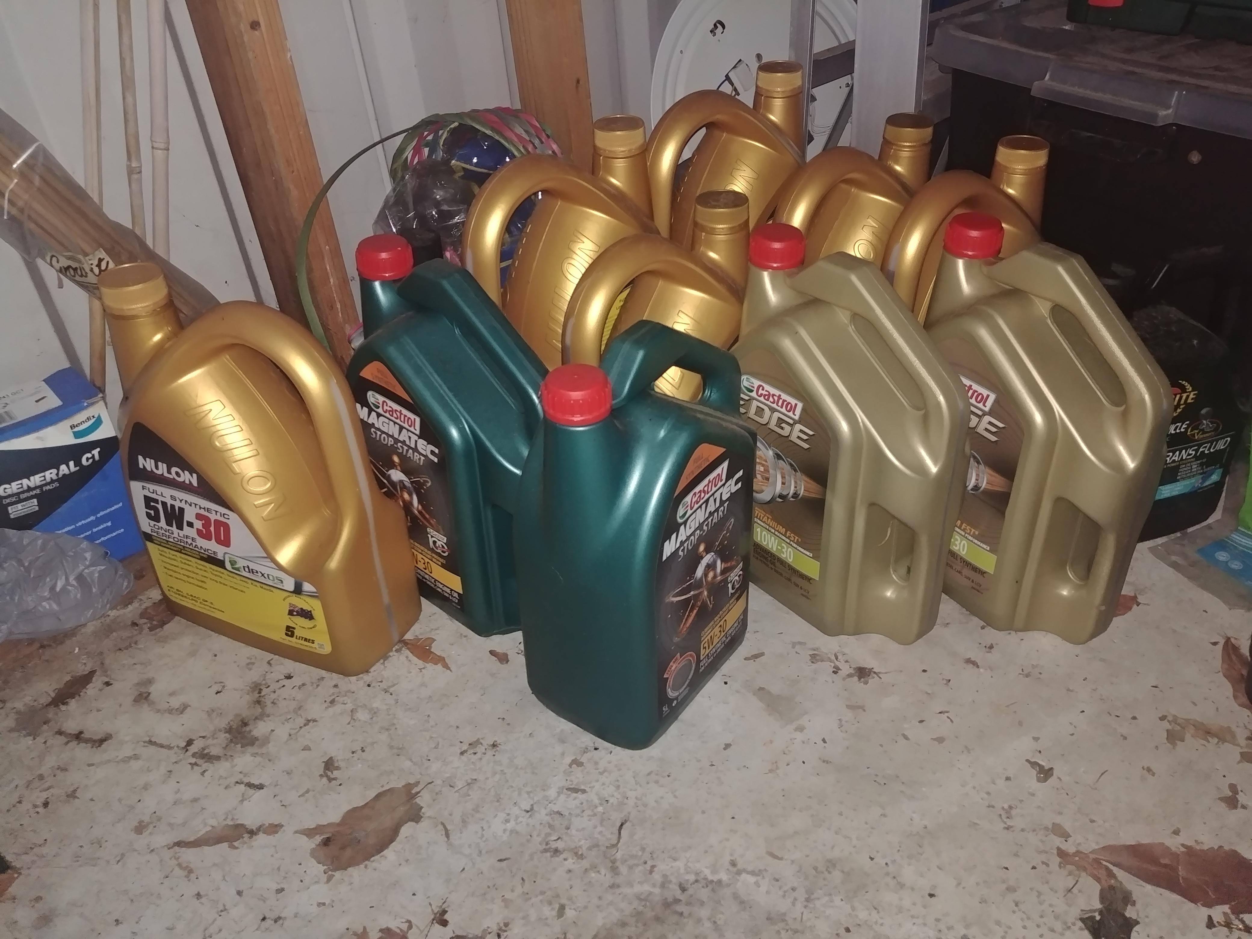

I recently checked my remaining oil "stash" for doing maintenance over Easter.
I now have lots of 5W-40 and 5W-30, various brands on special over the past few years all with the ILSAC GF-5 oil specification.
Is it OCD? That's after going through the Valvoline Synpower 5w30 and 5w40 bottles. Very good oil this Synpower btw. My wife's 2013 is on Nulon 5w30 exclusively, but on mine I put whatever I can get my hands on from the stash, almost always end up with frankenbrews from 2, sometimes 3 different grades or manufacturers. Damn 6.1 litres, whoever came up with this capacity :))
