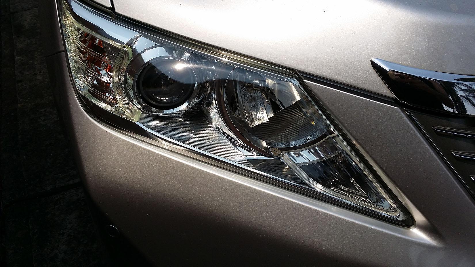

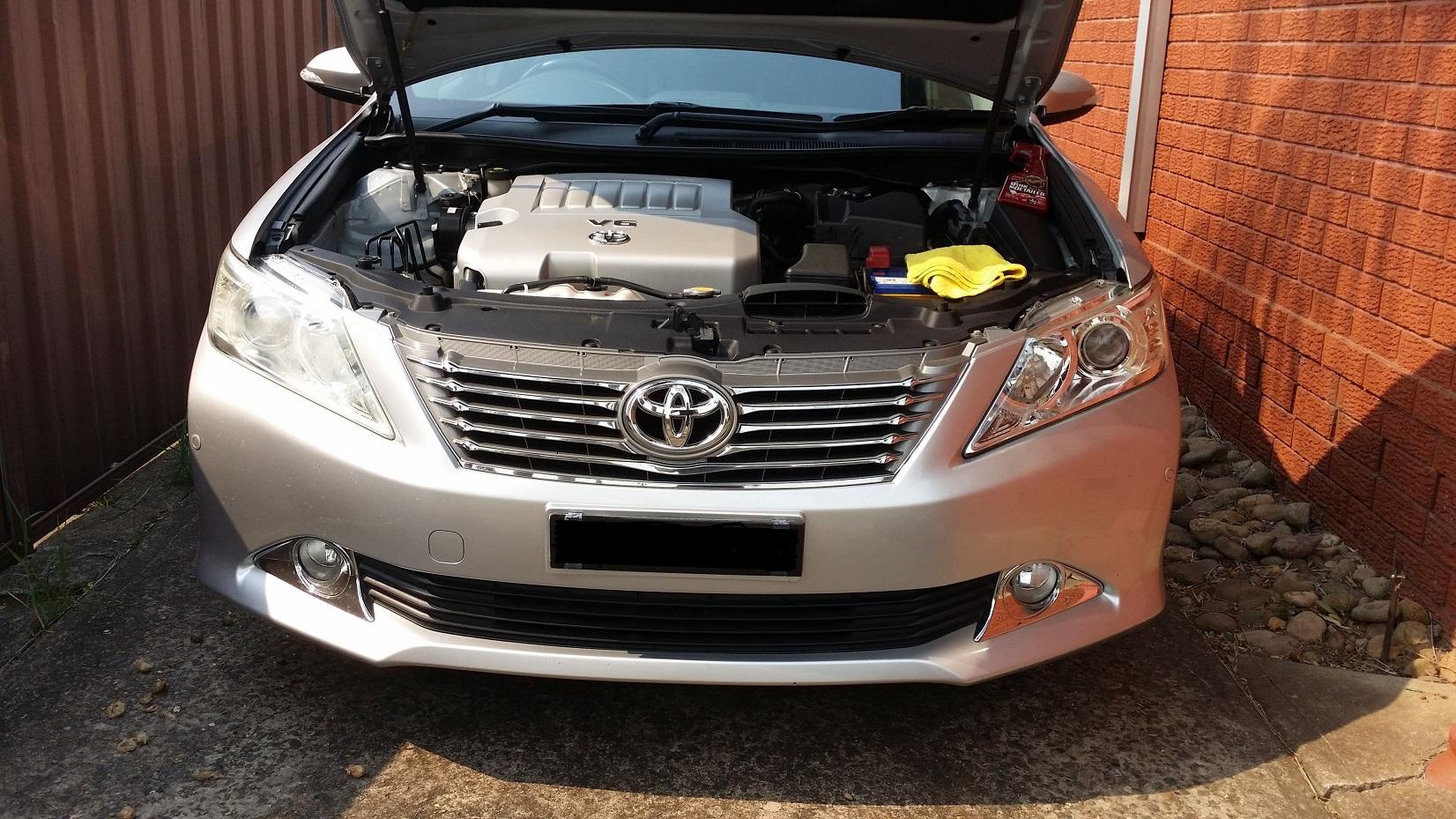

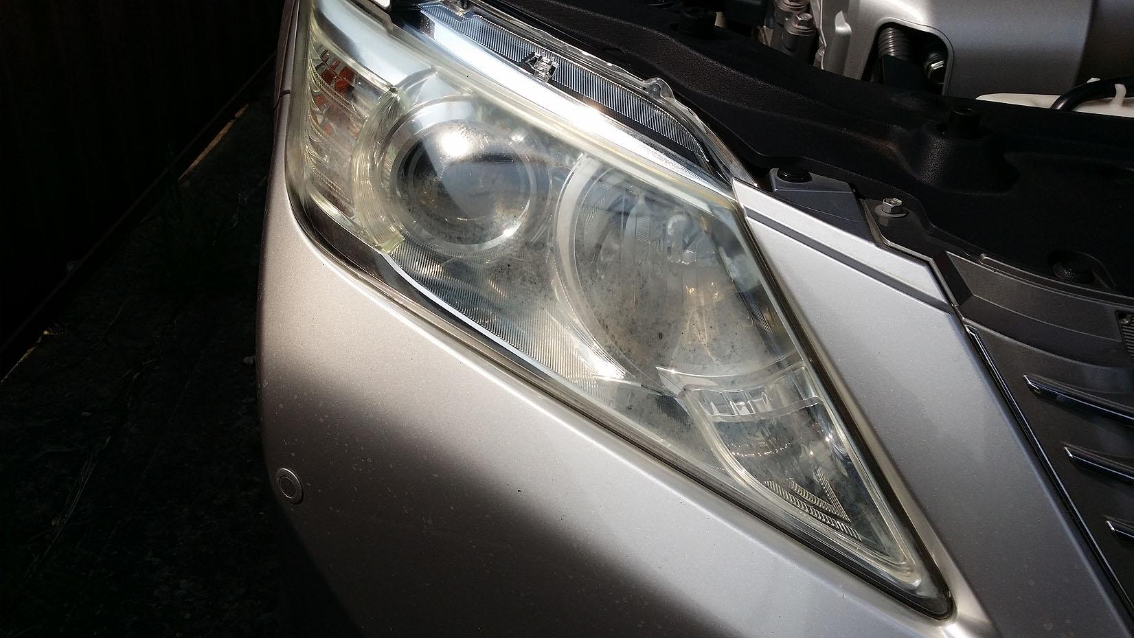

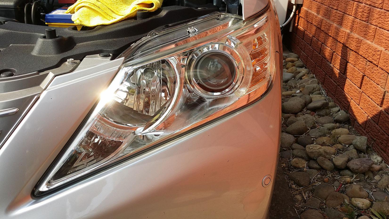

This was my situation a little while back. I only have a 'before' shot of the drivers.
Edited by Tony Prodigy
A picture is worth a thousand words. Certainly setting a platinum grade standard.
Looks like I have got a lot more work to do to really clean the headlights before sealing them.
