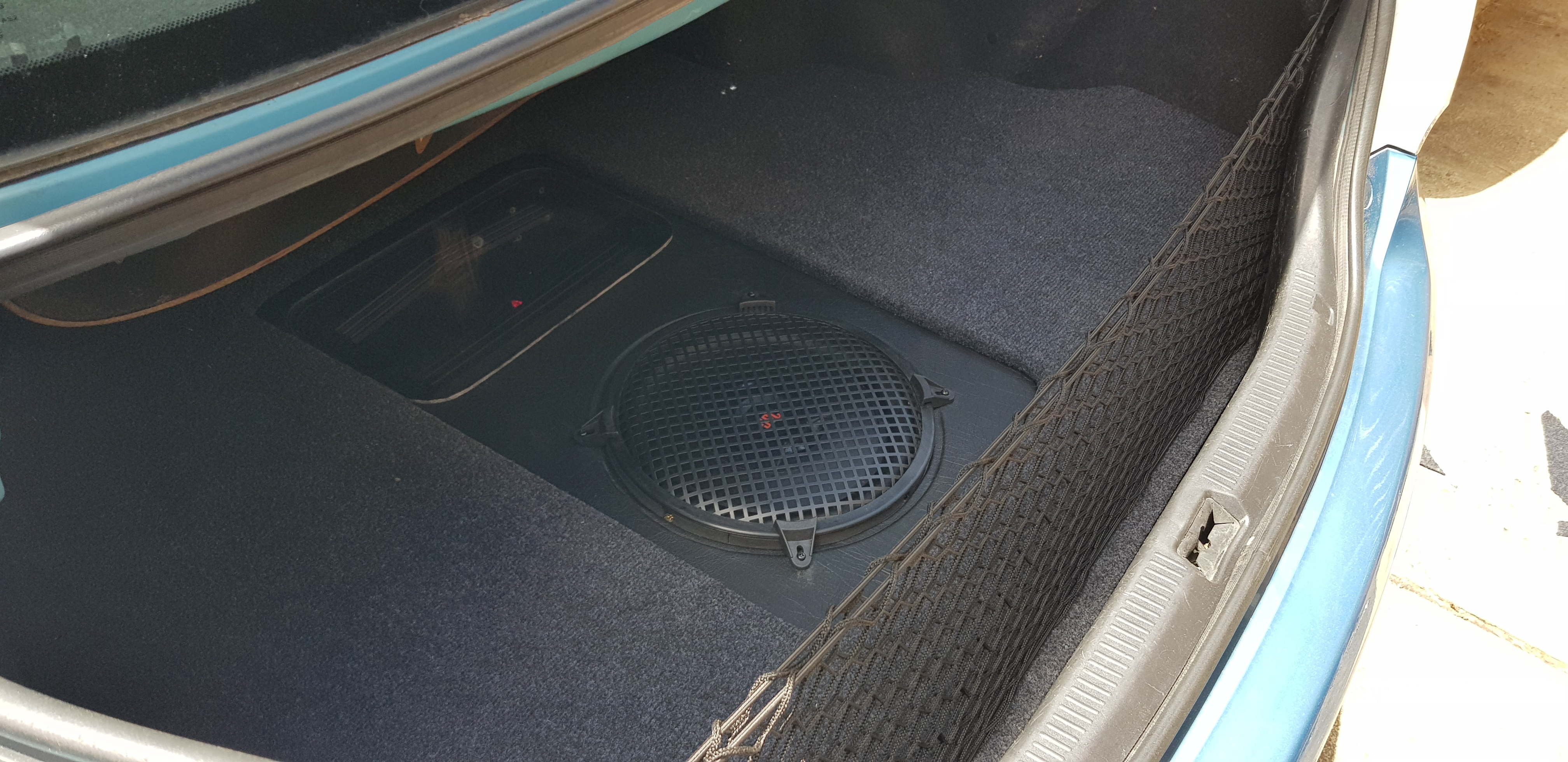

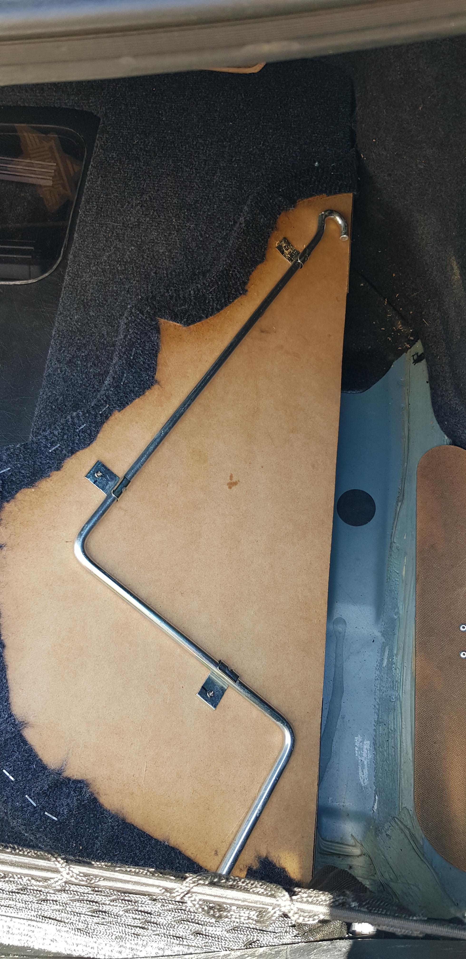

Rmackres 0 Posted January 14 Report Share Posted January 14 This is what i did. Turned the spare wheel upside down. Made a cylindrical enclosure with a jbl 12" low profile sub. Then raised the boot 100mm to accommodate the amp and some storage. Quote Link to post Share on other sites
Tony Prodigy 567 Posted January 14 Report Share Posted January 14 Very nice Ryan. Thinking outside the box. Pun intended At least you don't have an imposing box in there and still have room to carry stuff. Just need to be careful not to damage the woofer's mesh cover. You can probably make a protective surround that fits over the top if you need to use the boot to it's fullest. Nice work mate and welcome to the forum by the way Quote Link to post Share on other sites
Metal_Head 46 Posted January 14 Report Share Posted January 14 I would be more inclined to fit a slimline woofer under each front seat. You would still get audible bass, whilst remaining out of sight & no loss of storage room. Having said that, the above boot install is very creative, nice work👍 Quote Link to post Share on other sites
Rmackres 0 Posted January 14 Report Share Posted January 14 Thanks. The slimline sub installed requied a .75 cubic foot sealed enclosure. So might have been a bit tight under the seat. Both the front door and parcel self speakers have been replaced with kenwood 6x9's. Have built in storage compartments under the raised floor for jump lead ect, so i havn't lost to much room, and it does help to keep the space clean. You can still get to the spare, though it is a little painful. There are plans for a cover. At the moment just using some left over carpet for protection when the boot is in use. Quote Link to post Share on other sites
