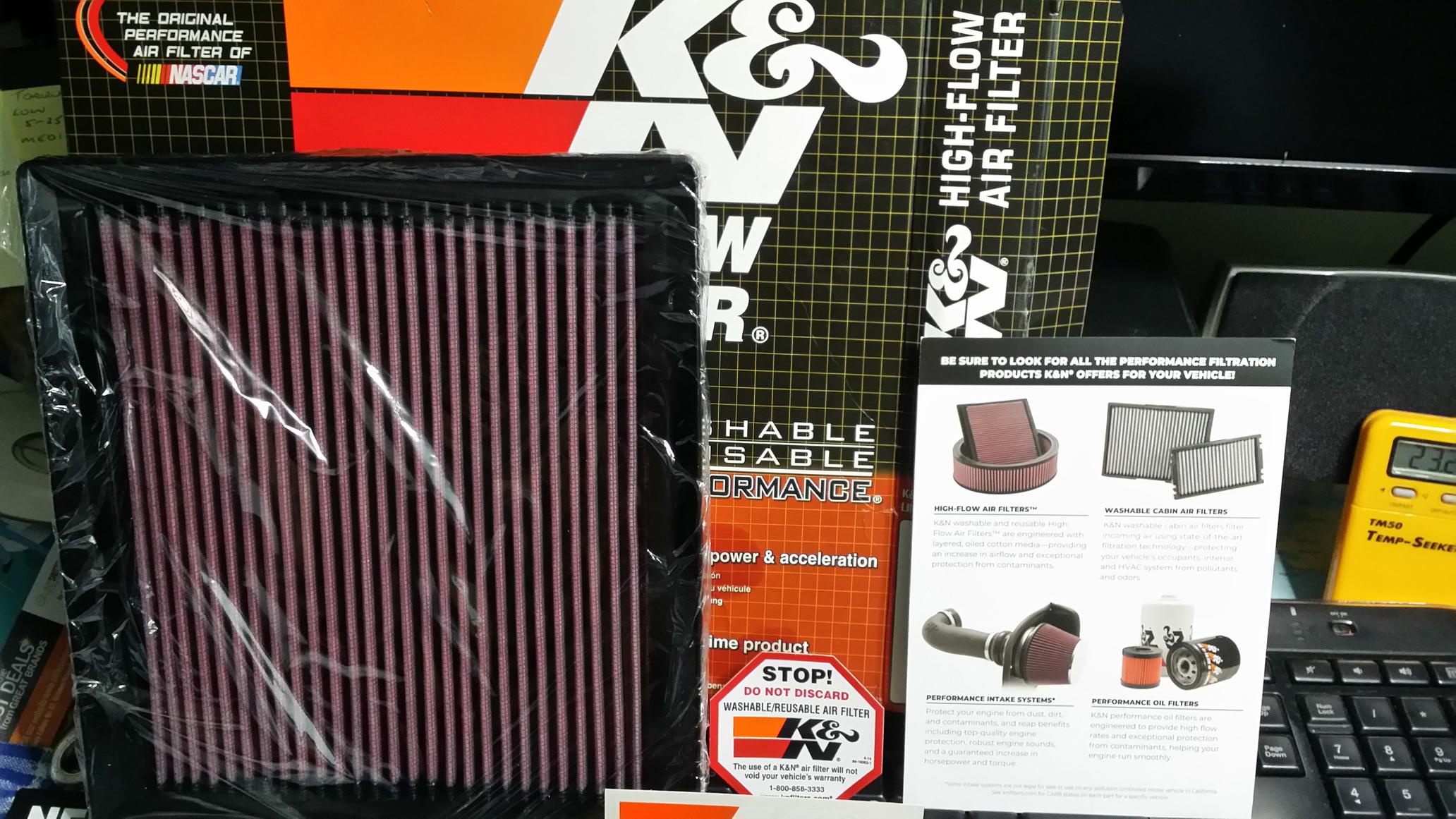

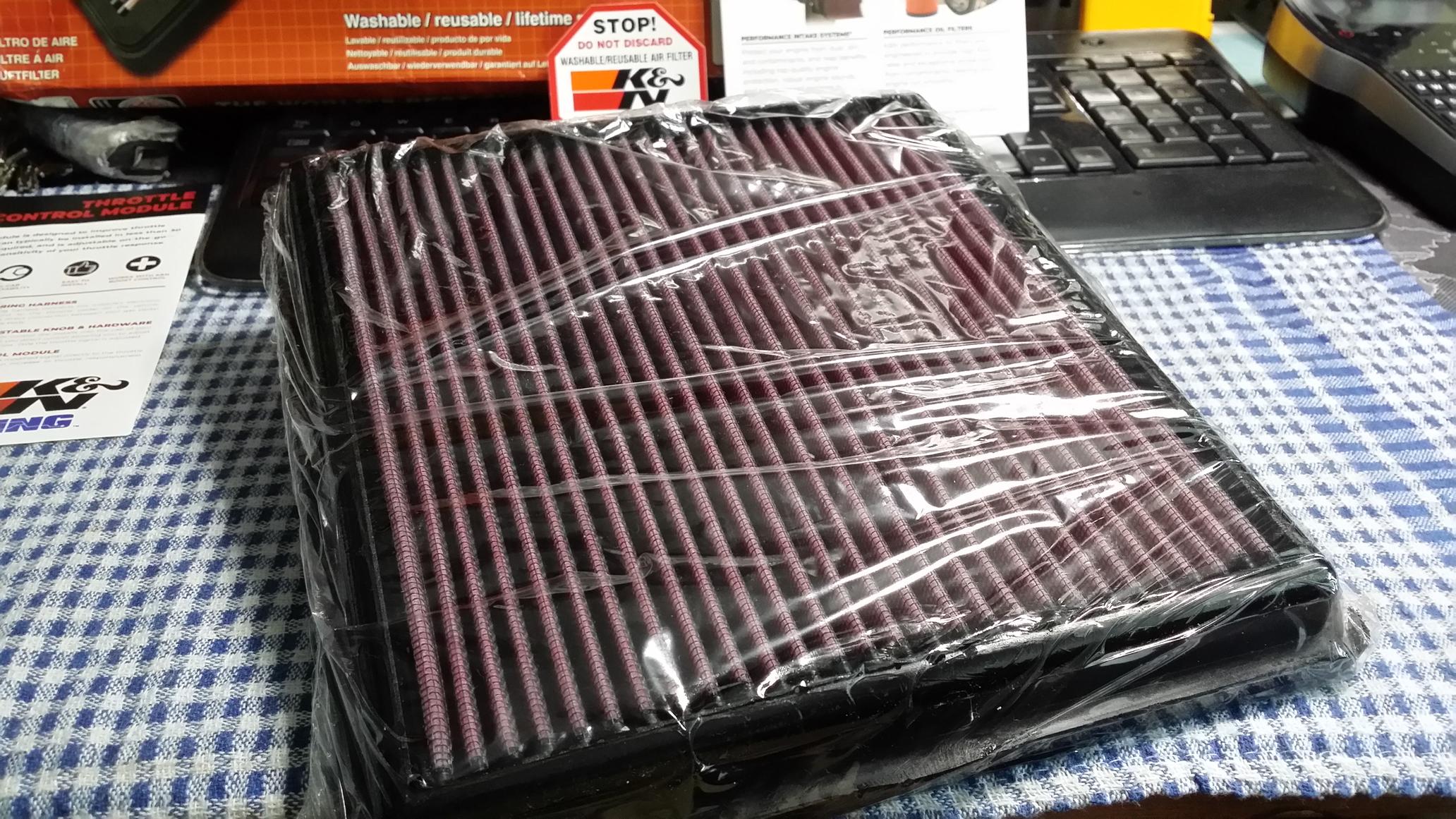

I have one of these on the way, hopefully receive it next week some time.
I also didn't realise that the 40 and 50 series air filters are different too. Lucky I checked before purchase.
K&N for 2006 to 2011 P/N 33-2355
K&N for 2012 to 2017 P/N 33-2443

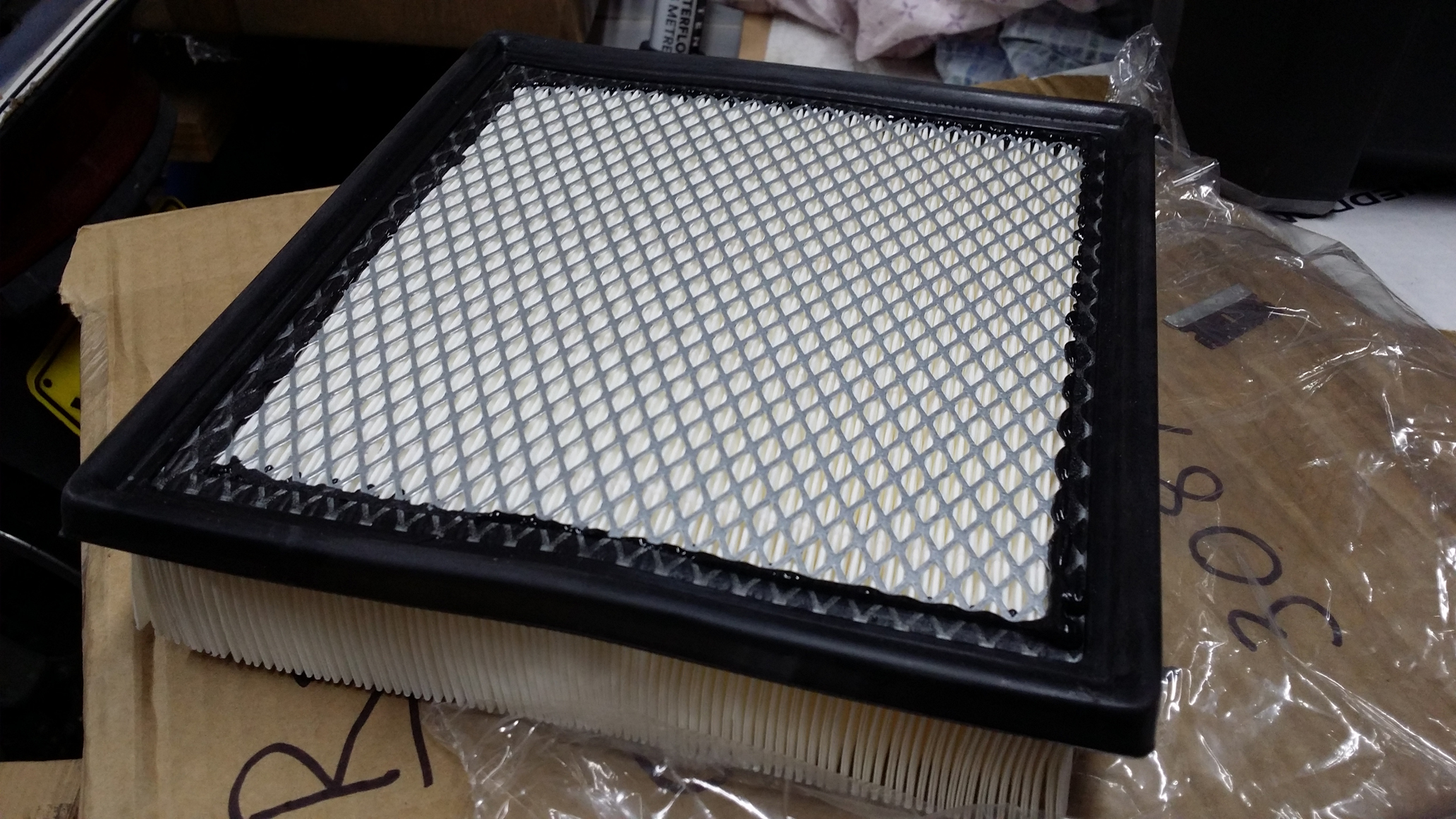

I always had K & N filters on my motorcycles and found they breath better than the standard filter and thought why not for the car as I haven't tried one before. In terms of the bikes, the filters that come with these were quite woeful. All they had was a sponge media sandwiched between two fine mesh screens. The K&N had more surface area due to it's pleated design. I also like the fact that it is re usable as it can be washed over and over again. It's of high quality construction too.
I recently saw this video and it tweaked my interest a little more. I figured that each time I have to replace the air cleaner, its costing between $40 and $50 and the K&N is only a little more than this and is pretty much a lifetime item with a little maintenance.

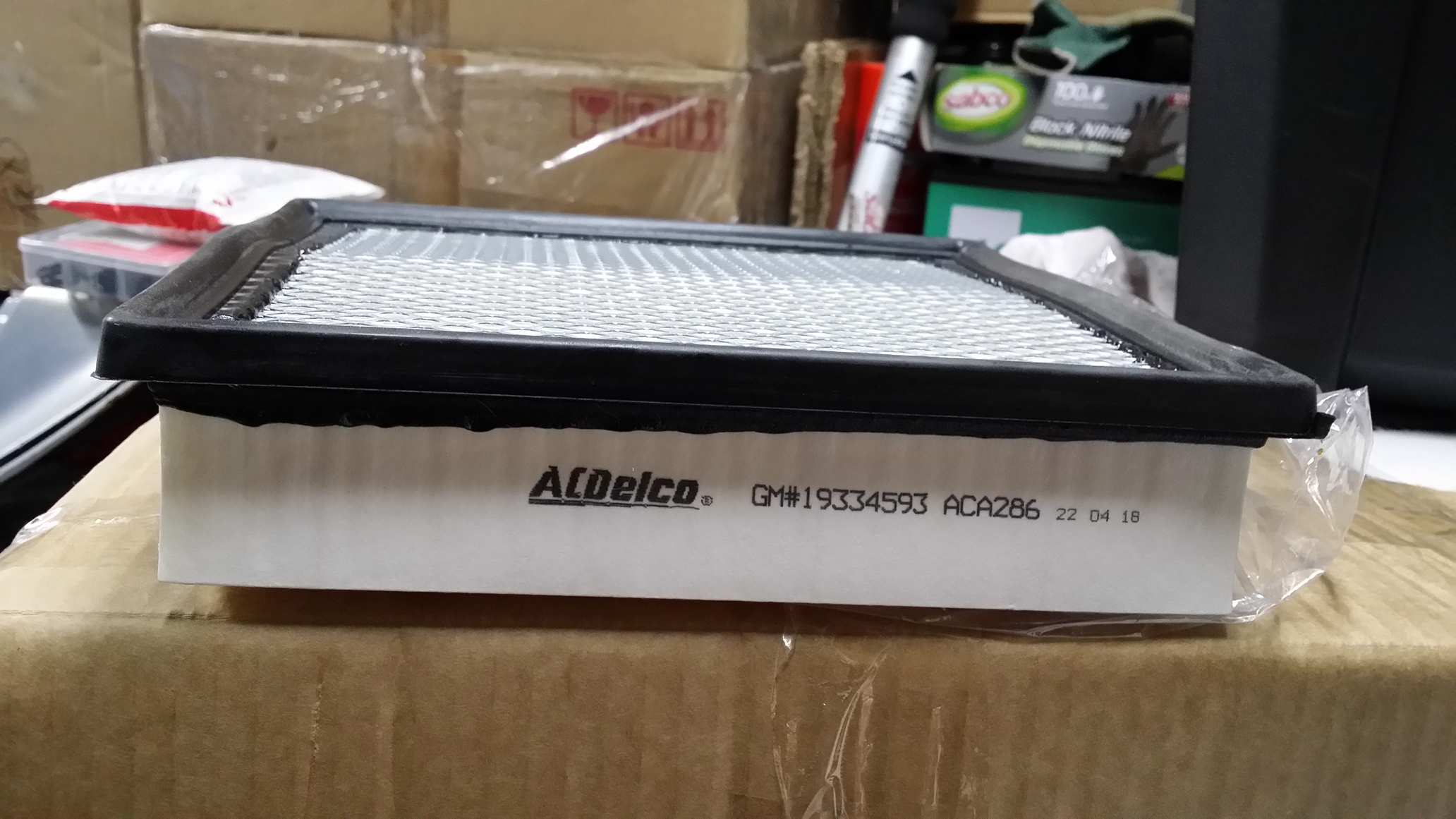

I should change the title of my thread to "K&N Filter- Yes or no ?" Looks like I messed up on this one. I was always under the impression these were decent filters. I had a good read of that info and it looks like it's a terrible bit of kit. Too late to cancel my order though. I'll probably just re sell it or just keep it as a monument of my stupidity lol.

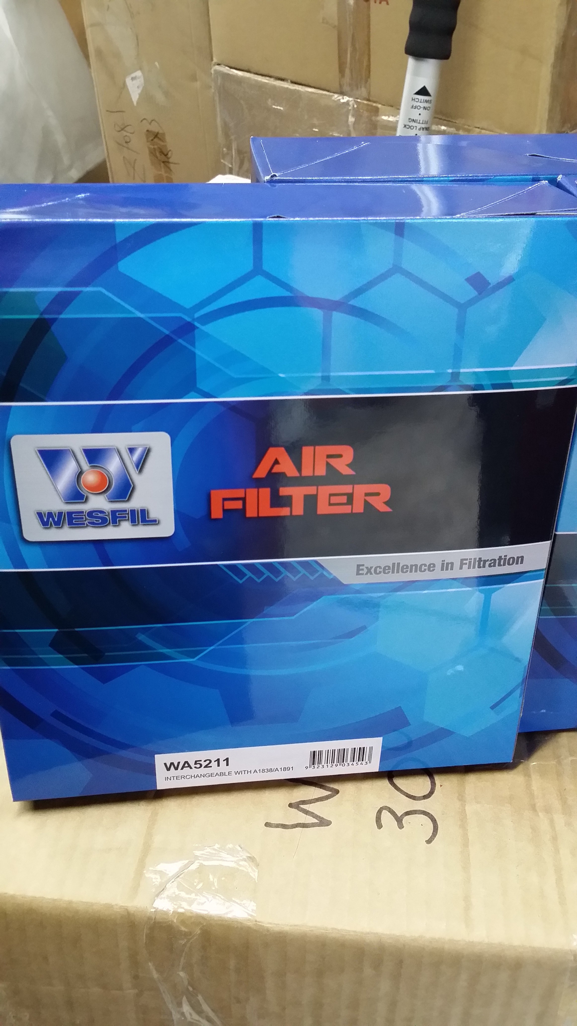

It looks like the AC Delco filter is a supreme item and after doing some searching I managed to find a supplier in the South of Sydney who actually has them. I have ordered 5 to keep in stock as I am now servicing my Dad's Aurion too.
Thanks G :thumbsup:
The K+N product is good, just not in filtration compared to stock. If you want outright HP for the track then it's OK but obviously at the cost of accelerated engine wear unless you're constantly cleaning the filter, then there's the oil that will eventually coat the intake & MAF.
The AC Delco in that test could be taken as OEM.
Maybe there are others here who track their cars or people with some experience re these filters who could chime in ?

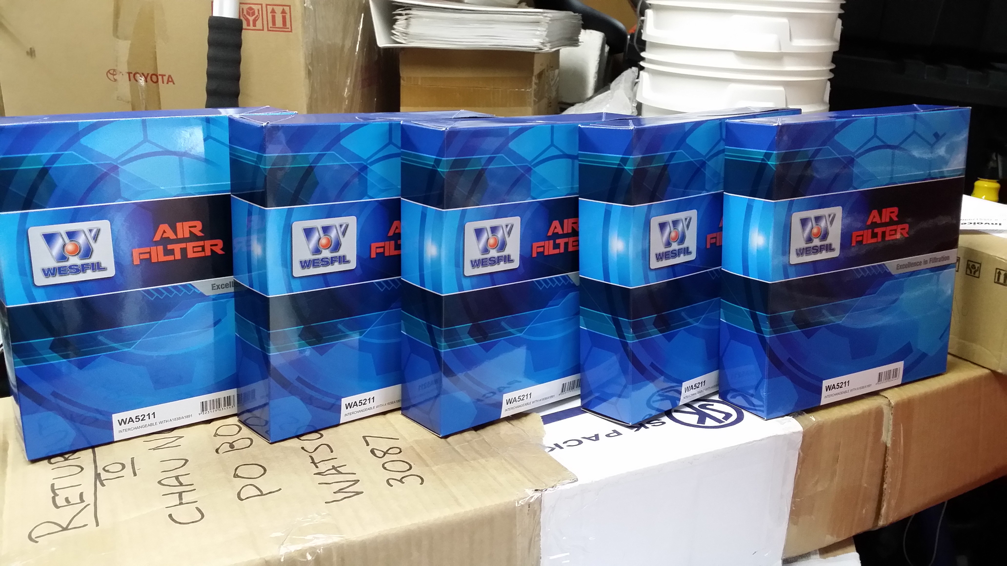

Thank you Adam. I will wait and see what it looks like when it arrives and make a decision then. In the meantime I have stocked up with acdelco air filters so I'll be good in the air filter depts for several years it seems.
Cheers :thumbsup:

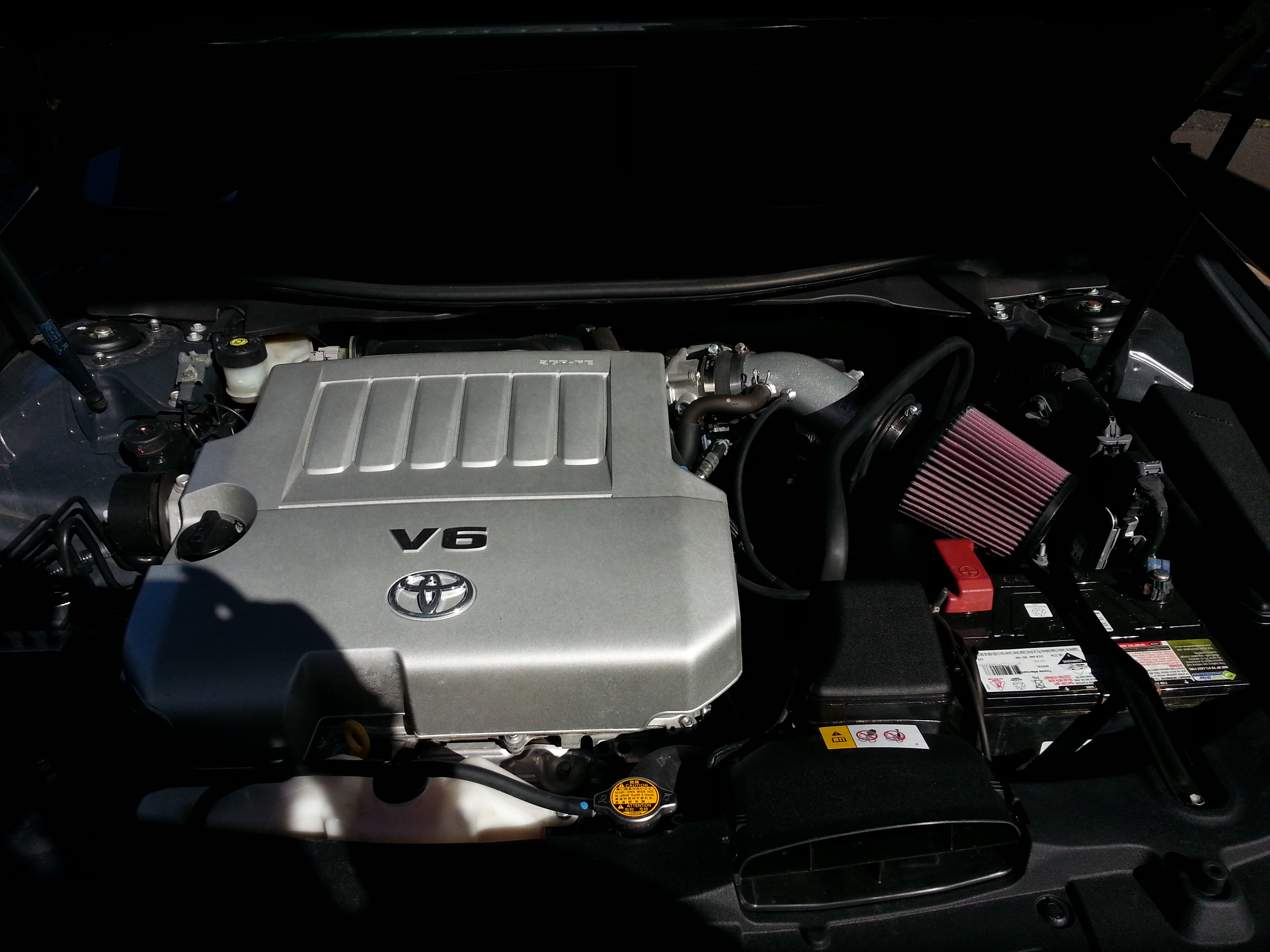

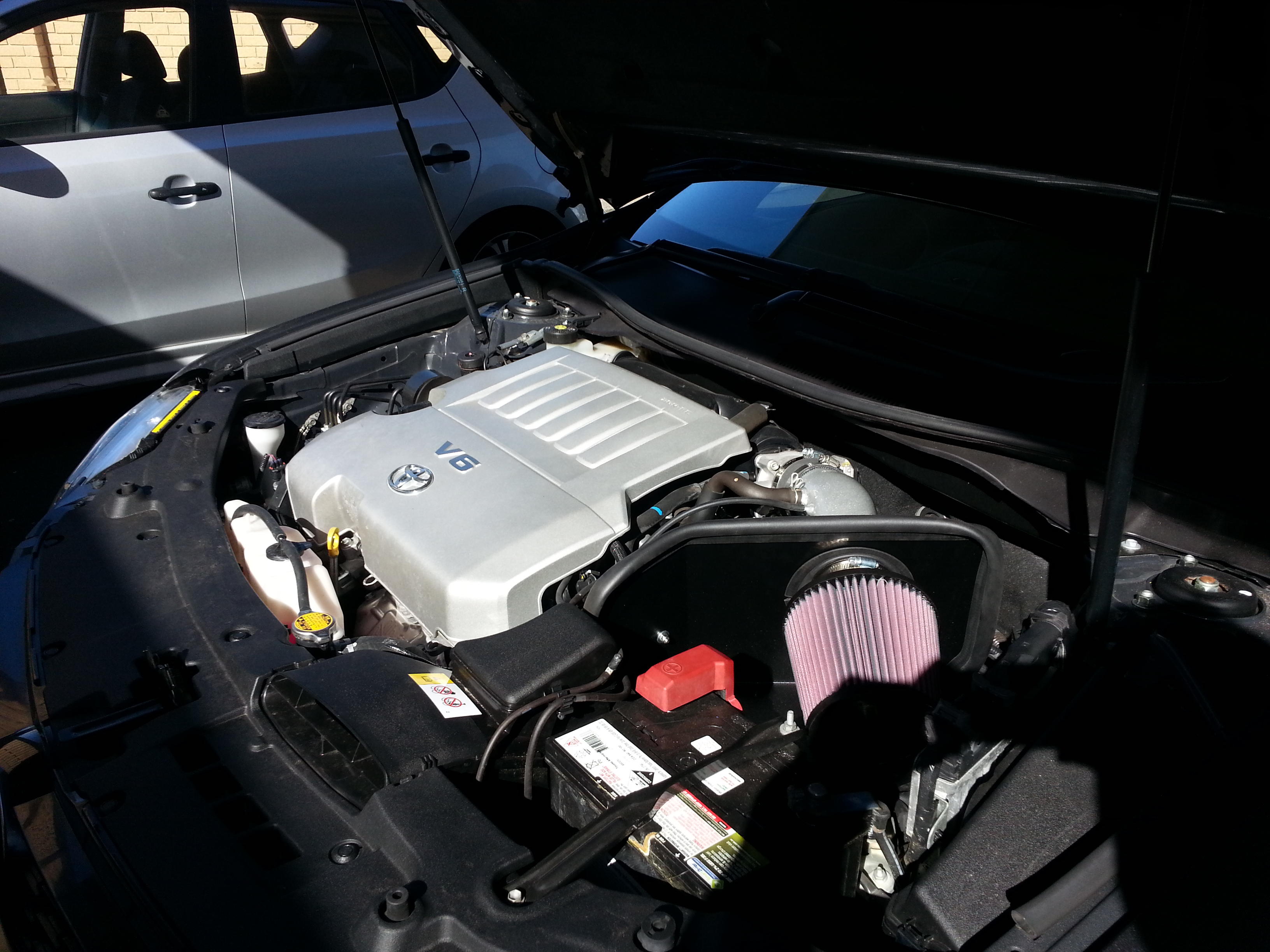

Saw this thread that inspired me to do some research on filters...then intakes... Seems like the K&N typhoon was quite popular for the Aurion but very pricey for a bit of pipe and a filter ($500-600!), so I bought one of these el-cheapo eBay universal intakes... Wish me luck 😄 Only really doing it for noise (which makes it feel faster, right?!) May switch out the filter to something nicer though.
Could've gone for the shorter style intakes, but this gives me a lot more options with the extra piping (not planning for a cold-air install).

Nice one Luke and damn that's very cheap. Pardon my ignorance on this subject, but where will the MAF sensor go ? Does it have a provision for it somewhere ?

It doesn't seem to have a proper housing/mounting port (other than the couple of holes), so I may do some dodgy metalwork or just buy a piece of pipe with an adapter 😄. Was a bit of a buy now, think later purchase in all honesty. Can't really complain at the price.

I'm sure you'll figure it out. Can't argue with the price either. You couldn't make one cheaper than that to be honest.
Post up some pics when it's done. We'd love to see it. :thumbsup:
4 hours ago, Metal_Head said:
From what I've read u will need to keep same spec diameter tubing around the maf to keep the tune in spec.
Yeah, will definitely need to step it down before it hits the maf sensor :/. EDIT: Maybe not
Does anyone know the actual diameter (outer and inner) of the tubing around the MAF (I can't find specs)...might have to measure. I don't think it'll be significantly different to the 3" piping. EDIT: I believe it's 3.5" from the throttle body.
