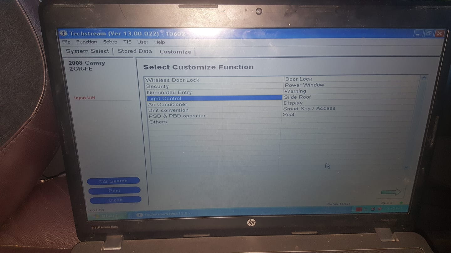

I don't want to say for certain, but, when I was messing around with Techstream on my car I saw some options for the parking sensors. Not sure if any of those control the sensitivity/activation distance. Can't remember. I didn't really spend too long on that screen.

Techstream
I'd be interested to find out more about this. Can you elaborate on what you have and where I could get it ?

I got one of these:
https://www.ebay.com/itm/Mini-VCI-J2534-OBD2-Diagnosekabel-fur-Toyota-Lexus-TIS-Techstream-V13-00-022/254563572560?hash=item3b452bdb50:g:7s4AAOSwJx1ejWvN

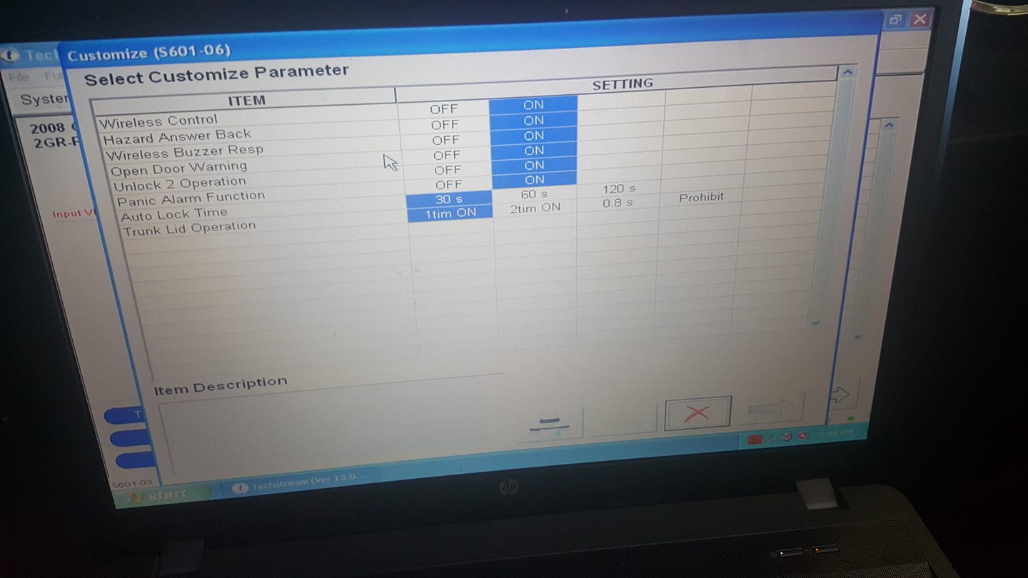

Used it to change my headlight sensitivity - they come on far too late in my opinion. Compared to the 50 series the 40 series options are pretty limited. I did change my keyfob boot release from a 2 second hold to a single press, and enabled double unlocking. I might have a look around today for those parking sensor options, I'm sure I came across them. It might have just been to change the volume of them.

I believe you can program new keys with Techstream as well 🙂
