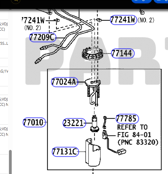

Talking to people I have been told there is a main tank and an auxiliary (sub) tank and both have a fuel pump.  My unconfirmed theory is the sub tank fuel pump is either not pumping the fuel continuously or not efficiently.  Either way I believe I have to remove the tank and test/replace the fuel pump.

Hi all, I have the issue as well. Also dropped into Broken Hill Toyota. They confirmed with my VIN that my vehicle has only a single tank and hence no transfer pump. Behaviour is same as others experience. Of note I find sometimes there is a lot of gurgling when filling and fuel comes out of the small side pipe just inside the filler. Tank then appears full but if you drive around a bit it will then take another 30L or so. I have found a reference to the system which indicates there is a lift pump and a high pressure pump. https://www.google.com/url?sa=t&source=web&rct=j&opi=89978449&url=https://www.service-engine.com.ua/webroot/pdf/TOYOTA%20LAND%20CRUISER%20(200%20SERIES).pdf&ved=2ahUKEwjyzrmD38uBAxUka2wGHcnICtUQFnoECEgQAQ&usg=AOvVaw10YFUjvRnVSsQE0pvI8PFC.
But I don't think the problem is related to the above as all operates normally.
Could it be related to some problem with any EVAP or breather system ?
