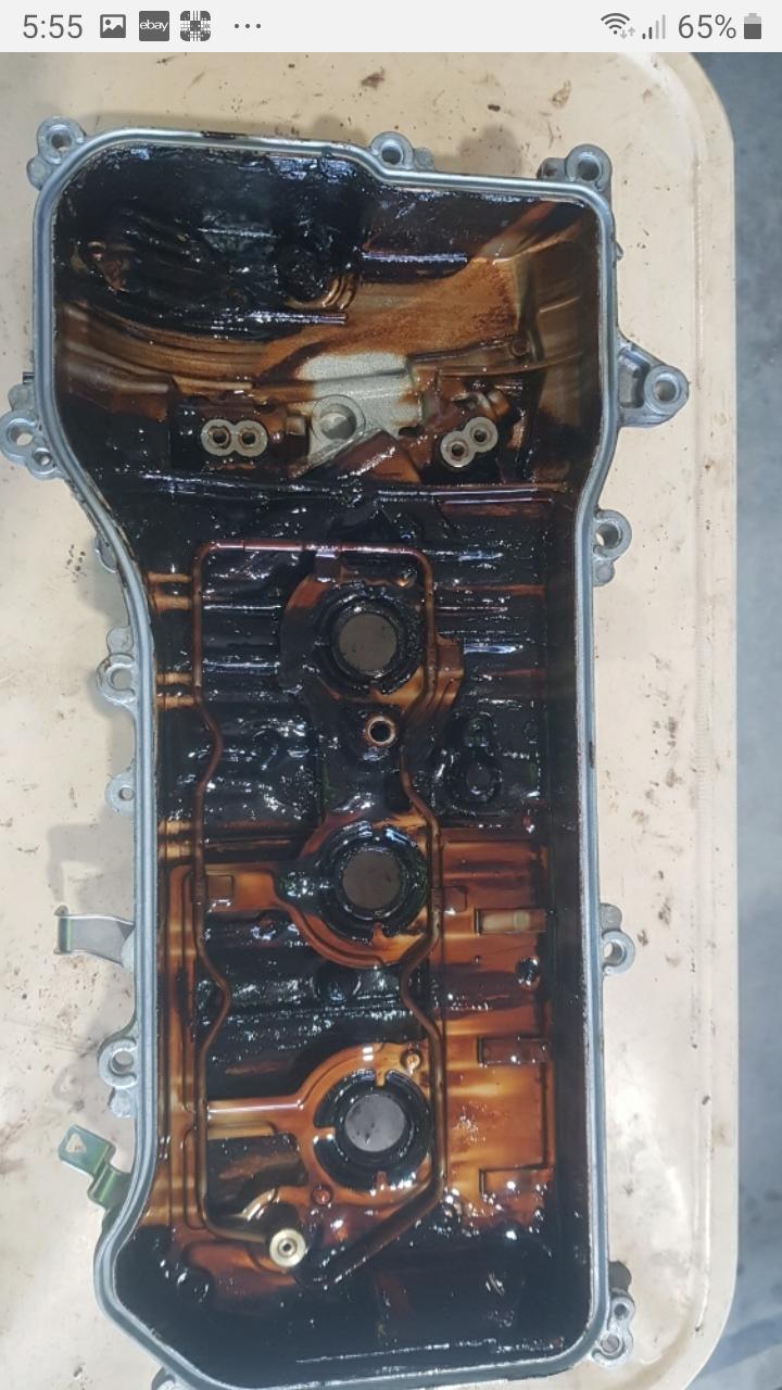

Afternoon all my mechanic sent me some pics. There was a lot of sludge and took 6 goes of degreaser  and kero and pressure wash to clear out all the sludge, the other pics are the sensers before and after. I don't have the car back yet, looking forward to a drive and see how it is.Screenshot_20210706-175501_Messages.thumb.jpg.3fec55276ab98d6a5a9bafd2f36f8839.jpgScreenshot_20210706-175234_Messages.thumb.jpg.a85d0cd7cdff25f025e768488c62f953.jpgScreenshot_20210706-175251_Messages.thumb.jpg.b344e4824ee24e17c0870c11d670443b.jpg
Pics of heads ? Out of curiosity what was the service history like & with whom ? Did they use dino, semi synthetic or full synthetic oils? Looking at the valve cover it certainly looks like owner neglect. Real pitty as the Kluger is an awesome truck.
Good God that's sludgy. It's a good thing you caught it now. It's a miracle the VVTI is still functioning.
Another piece of advice would be to have your mechanic go through the sump bolt hole with a camera (most good mechanics should have one) and check the state of the sump. Not sure if you can see the oil pick up though. The sump pan may also need removing just to make sure the pick up screen isn't half blocked with that crusty stuff.

Enlightening picture. Certainly a lot worse than what I was expecting to see. I would expect that there is a just as much or a lot more sludge around the valve gear.
Service history should give some clues as to the degree of neglect. Those ridiculous 12mth/15K oil change intervals are a precursor to cumulative sludge build up. I will take a guess that the previous owner drove 20K kms per year and did annual oil changes. Probably minimised service costs then bought a new vehicle to repeat the cycle.
Hopefully the mechanic will also have cleaned the VVTi controllers and PCV valve. I am guessing that the mechanic may be waiting approval from the dealership to remove the sump and clean the oil pick up screen and assembly. After that another engine flush then new oil and filter cartridge.
