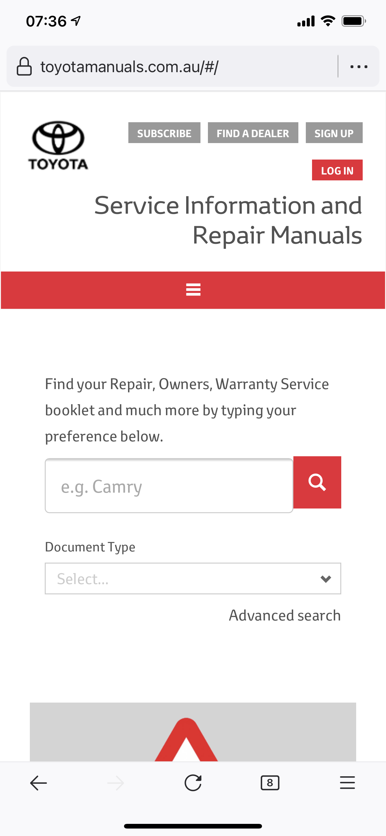

You can register your car in the “myToyota” app and get a lot of Toyota service history direct.
Also www.toyotamanuals.com.au will give you the ability to read the owners and service manuals plus find service bulletins like the VVT oil pipe.
I suspect Toyota have killed this site as the page is unreachable.
The www. was what fouled the search so I ended up google searching it and discovered that you need to register as a company and then they extort a subscription fee from you to be able to download a service manual.
All Service & Repair Manual Pack
Access to all available Service and Repair Manual on the SRM site
   1 Day - $ 16.50 7 Day - $ 66.00 30 Days - $ 198.00 6 Months- $ 990.00
So much for the poor old punter.
Wow Tony, they know how to make you dig deeply into the hip pocket to just download the service history and manuals etc
KAA
No.  Service History of your car is free through the myToyota App if you have a history with Toyota.  Also the Owners Manual and the Service Booklet is free.  Yes these are the ones included in the glovebox if they haven't been lost.  However if you need a service schedule, its there.
The detailed service manuals and procedures are a charged Item, but I would question anyone needing them to perform the basic maintenance.

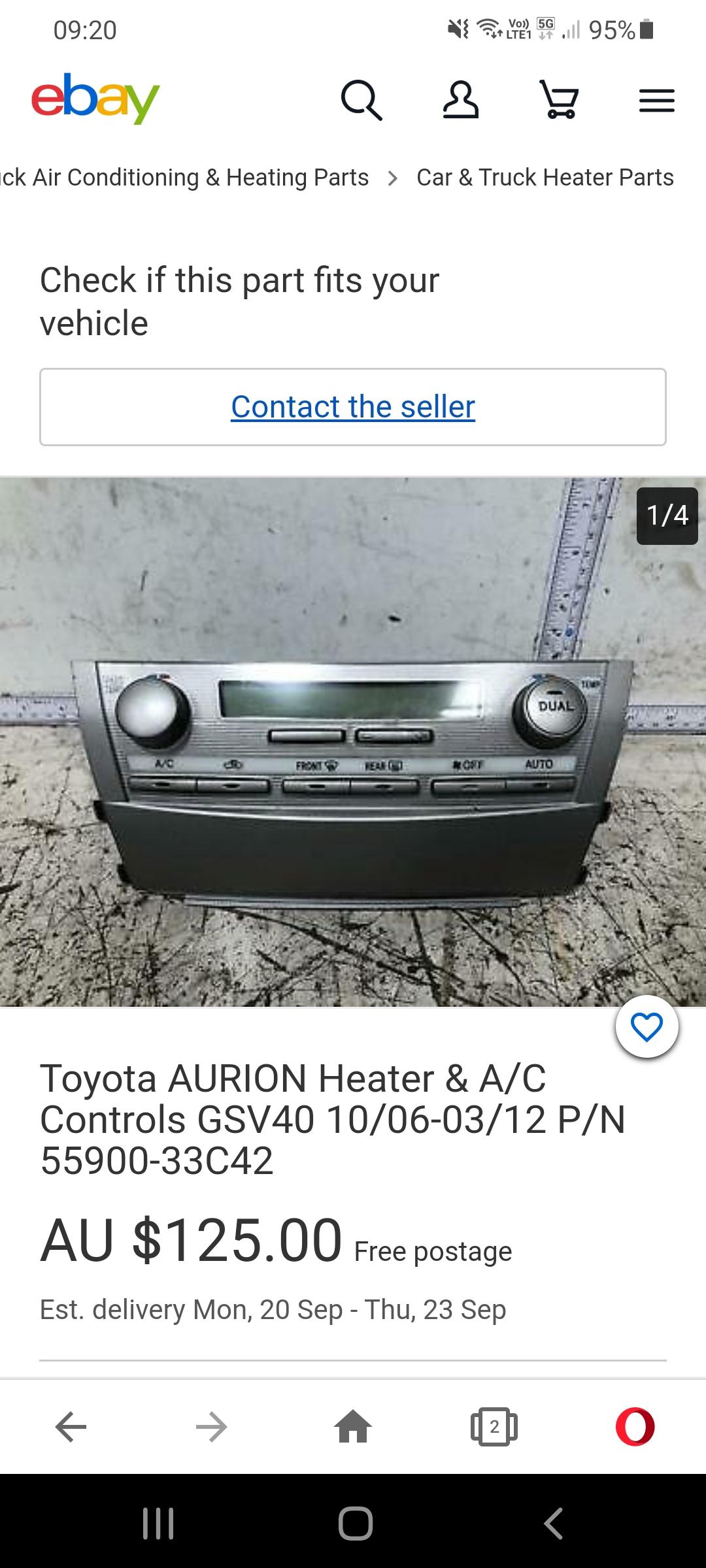

Hey guys,
Just discovered a new problem with my aurion (I thought it was normal). My AC/climate control wont start until around 60 seconds after the car start up (after parking over night). And once its turned on, the settings are always random but the temperature is always set at 25 degrees. Short trips are fine, the system actually saves the settings but it resets every morning when I start driving. It seems its a pretty common problem with toyota's climate control system delay issue. How can I start DIY fix before I take it to auto electrician. I've tried some DIY research myself...but the info is just too much for me lol. Change a certain fuse, reset ecu, servo motor, assembly plate etc...

Sounds like the climate control module is starting to play up. You can get these relatively cheap on ebay. Find yourself a good second hand one and just swap it out before spending all that extra money at an auto electrician who will probably just tell you the same thing.
It's a very simple job if you are prepared to do some minimal dismantling. There are plenty of youtube videos that can guide you in this process. You'll save yourself a lot of money and it's very easy, trust me.

Hey tony,
Thanks for the reply. So basically just swap one of these?Screenshot_20210910-092010_Opera.thumb.jpg.6128ec0900827daaa8dcb6e0e5b8b227.jpg
Just worried the problem could be somewhere else and it wont fix the current problem. Will do some more research before I purchase one of these.
Cheers!
Yes. Just swap yours over if it's the same for your model car.
By all means do your research. Usually the issue will reside in a localised area. It is a controller at the end of the day. Its function is to set and control the A/C so the symptoms you described point to the controller. The ECU has nothing to do with it really. These controllers can play up as they are pcb controlled and pcb's can play up over time.

Hi guys,
The air con problem is fixed. Found out that the blue plug (near the foot/hand brake) was disconnected. Maybe one of the previous owners accidentally stepped on it. Just needed to plug it back in. Its working fine now!
