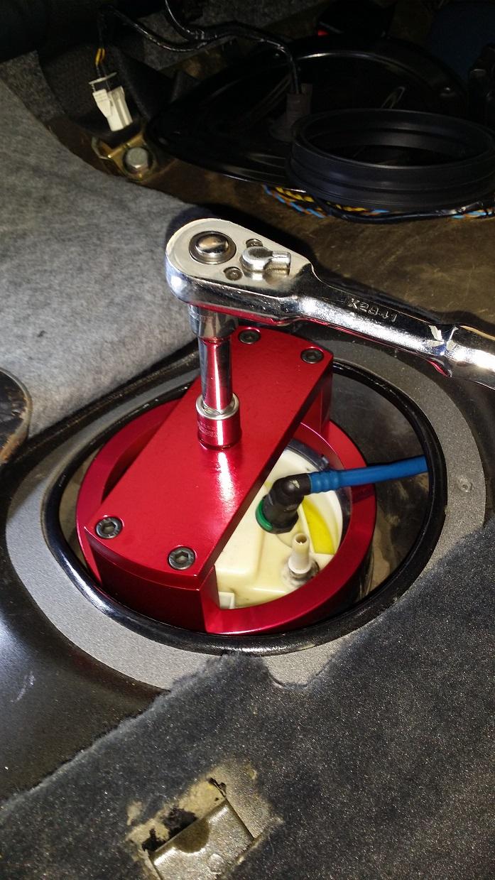

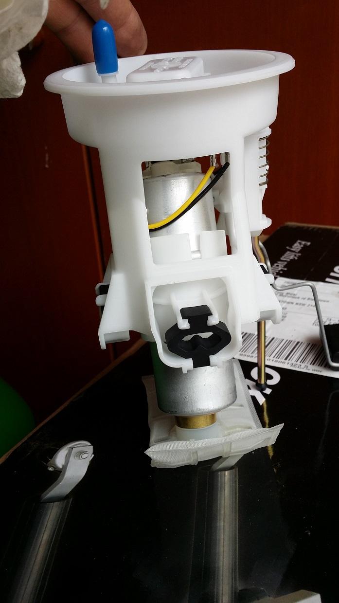

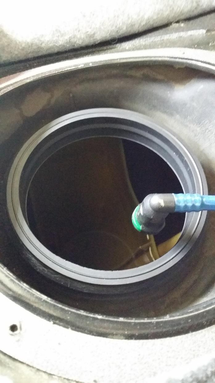

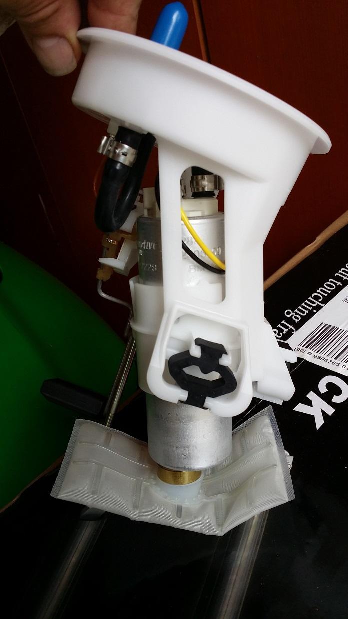

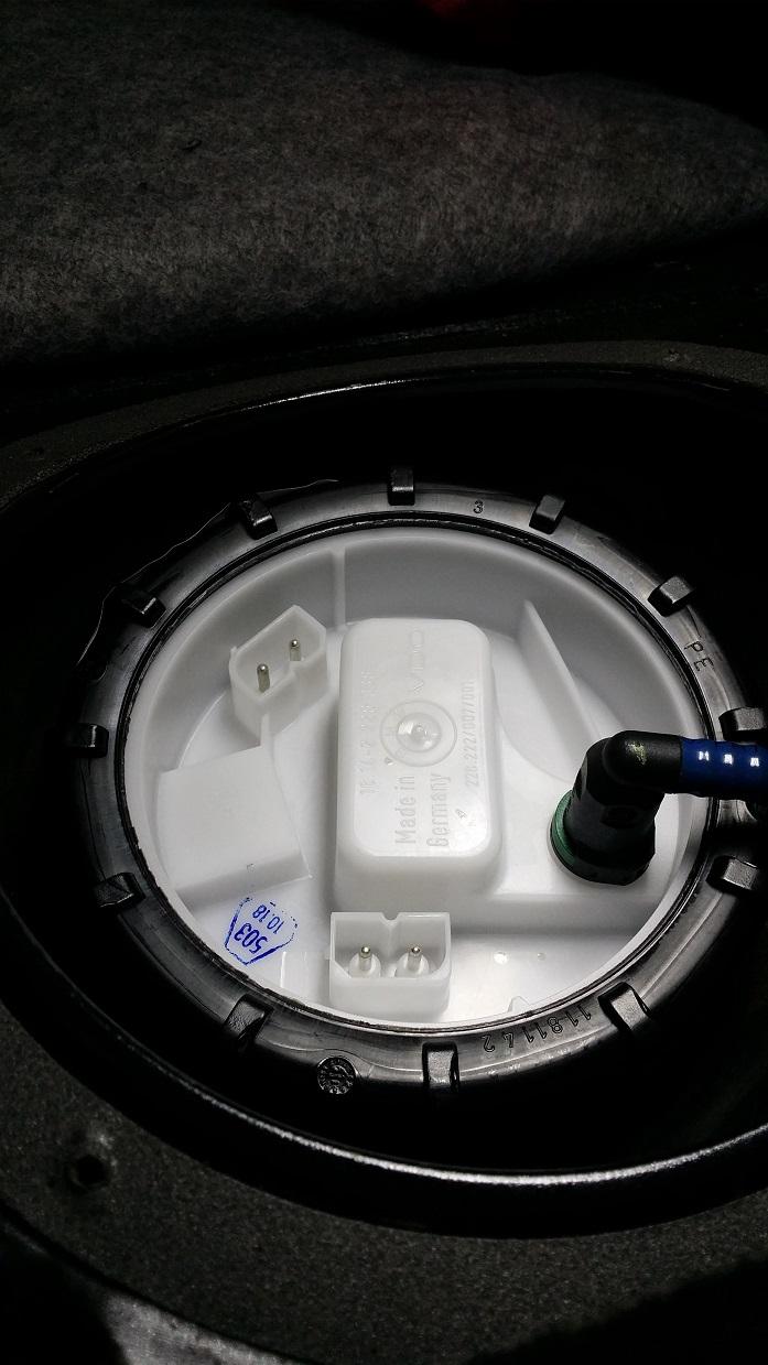

I haven't priced the the battery yet, but I guess it will more than what it cost all those years ago, with the current crazy that's going on. Still have to dig up the correct spec for it. I cannot remember for the life of me. The battery location is quite well thought out too. It sits nicely tucked in on the right corner under a storage tray. Pop it off and there it is. The battery has lift handles to make it easier to get out.
Fitment for the BMW delivery unit isn't all that much different from the Toyota. There is a metal cover which you have to remove, of course, and then you're suppose to tap a plastic locking ring off in an anti clockwise manner with a hammer and a blunt chisel, but I wasn't having that. Not only did I get a new delivery unit, I also purchased two new locking rings, rubber seal AND the special tool that helps remove and replace the ring sunggly. ECS Tuning were able to provide the special tool. Even If I got to use it once, it's good knowing that job was done to the factory standard. I need counselling I know 🤪
Edited by Tony Prodigy
