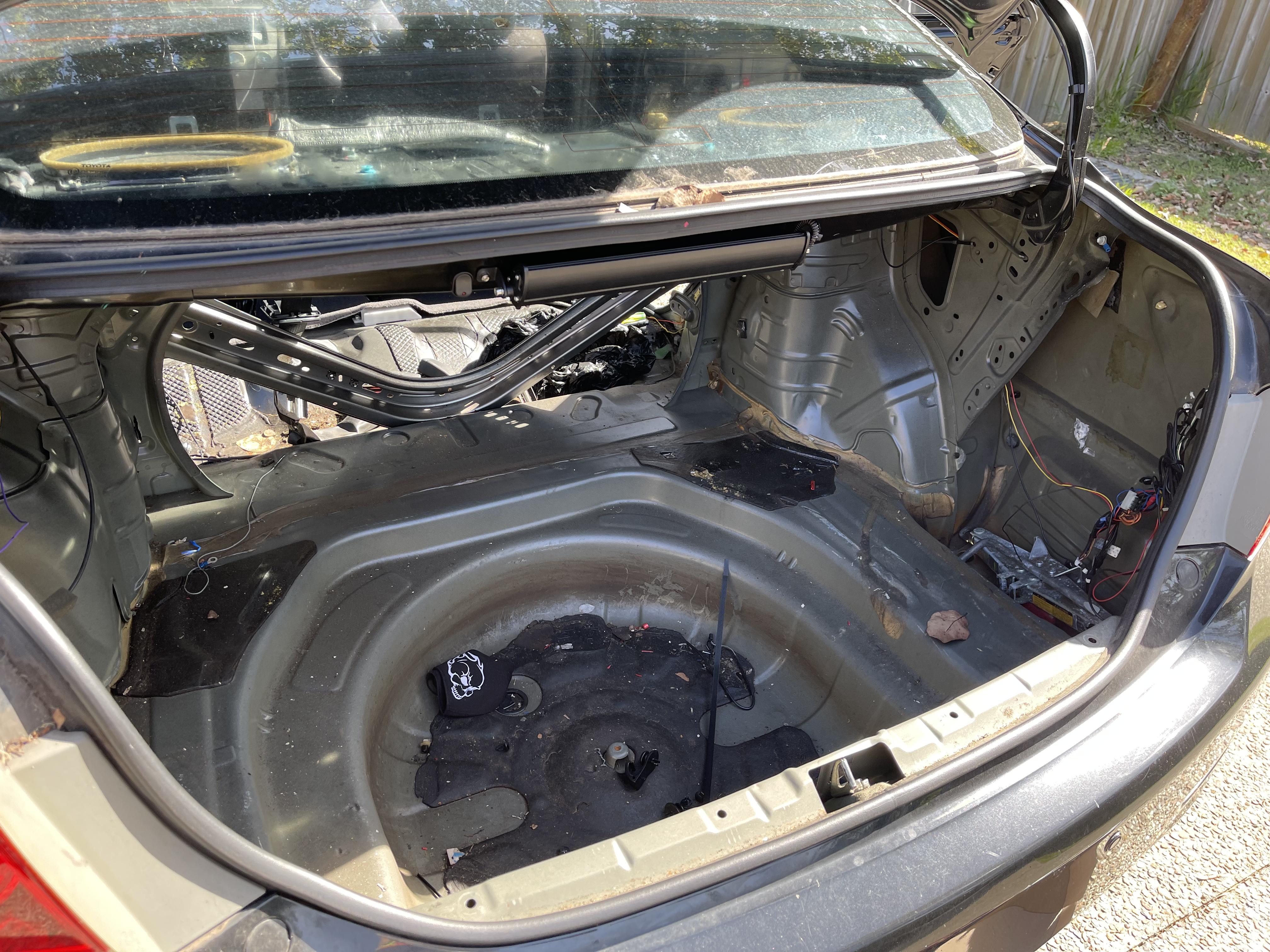

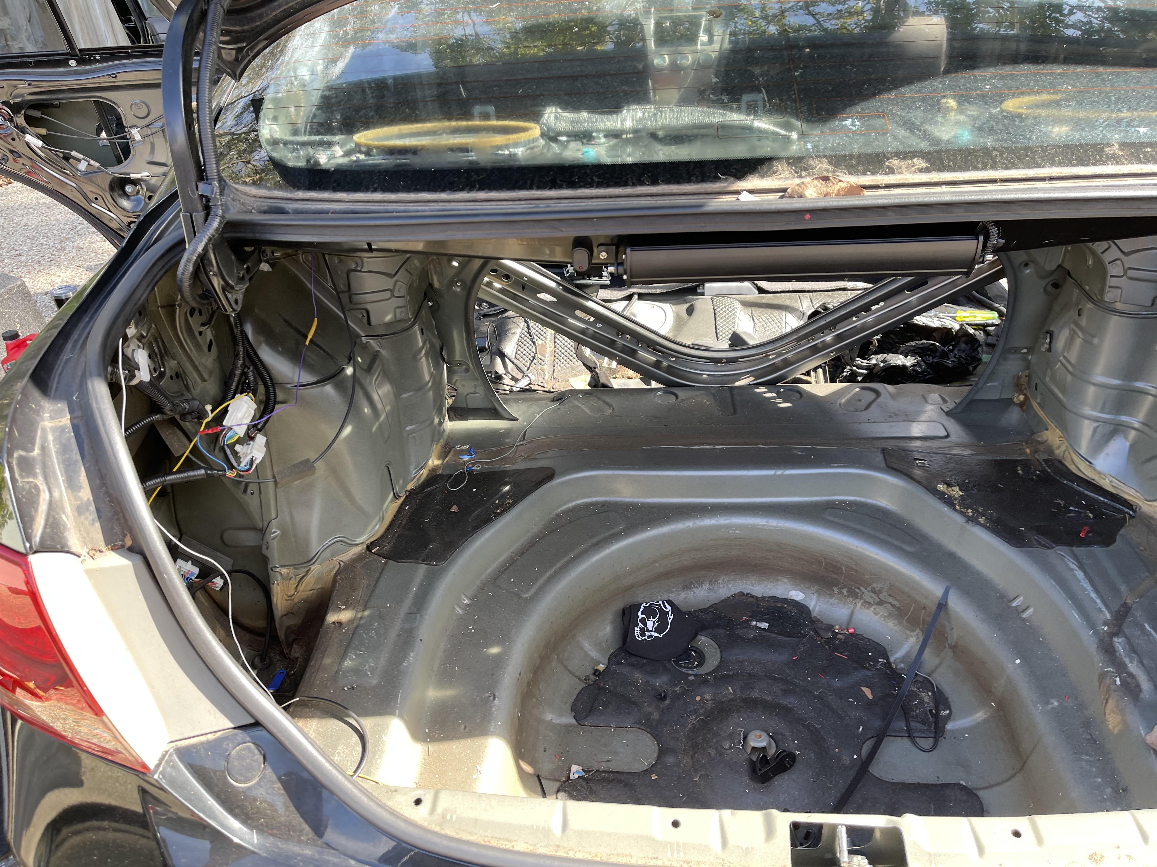

Currently have the back half of the car taken out, planning on removing the roof lining, carpet and maybe the sound deadening. Car is basically just a fun burner. Going to test if it goes any quicker.

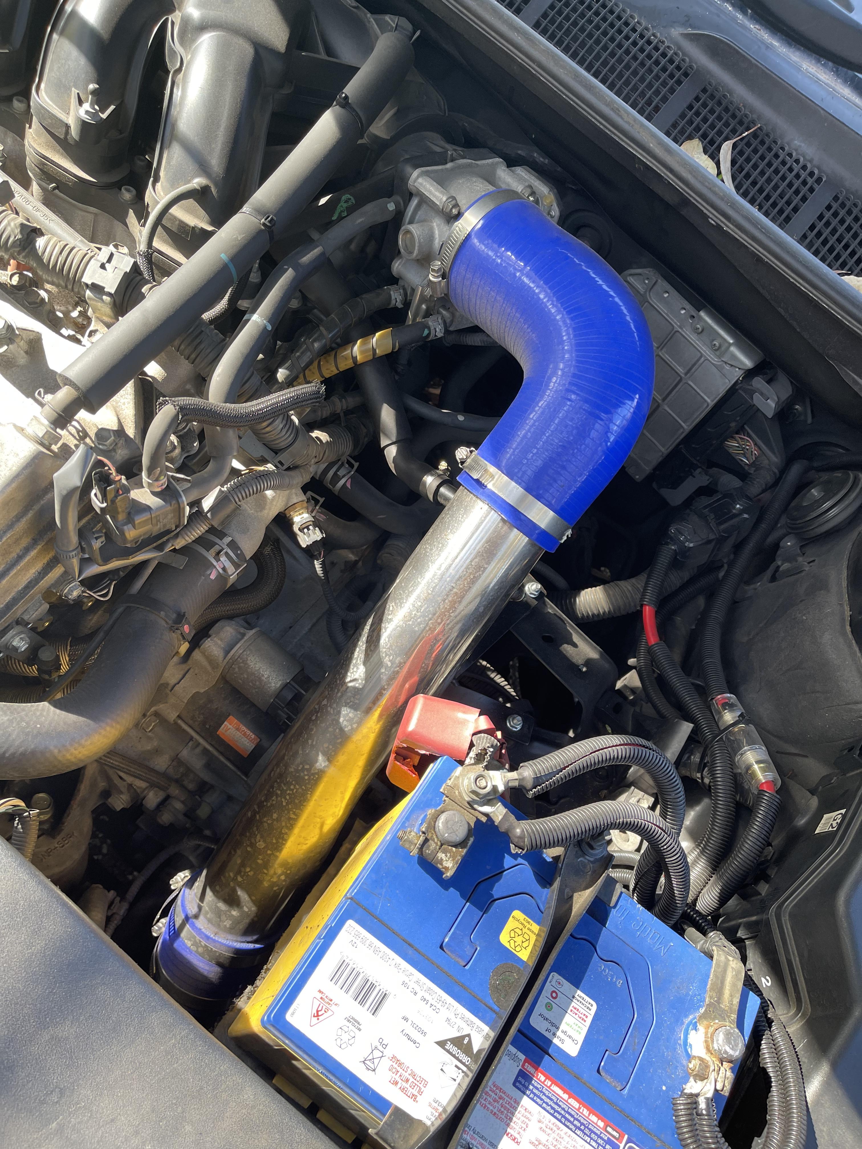

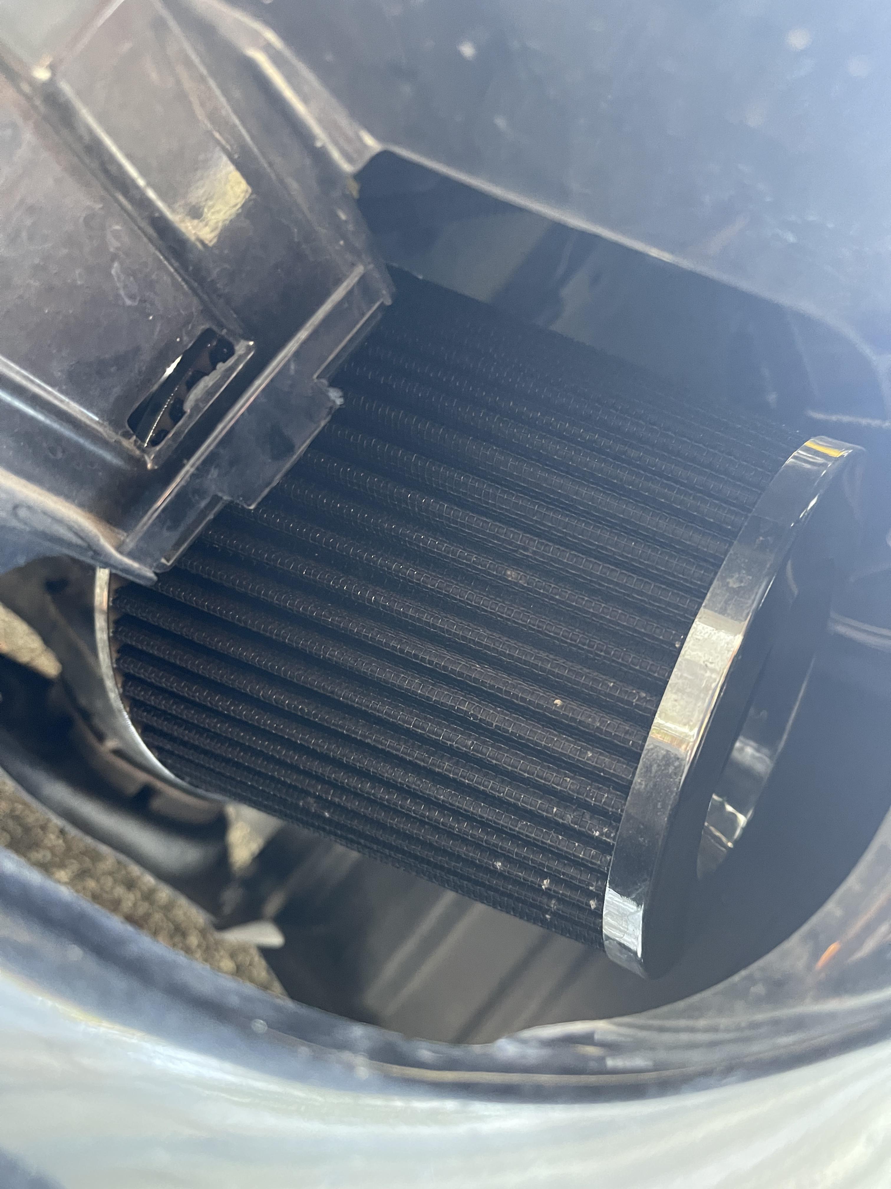

Honestly don’t know if the intake really does anything other than sound unless someone has dyno’d this car before and after.

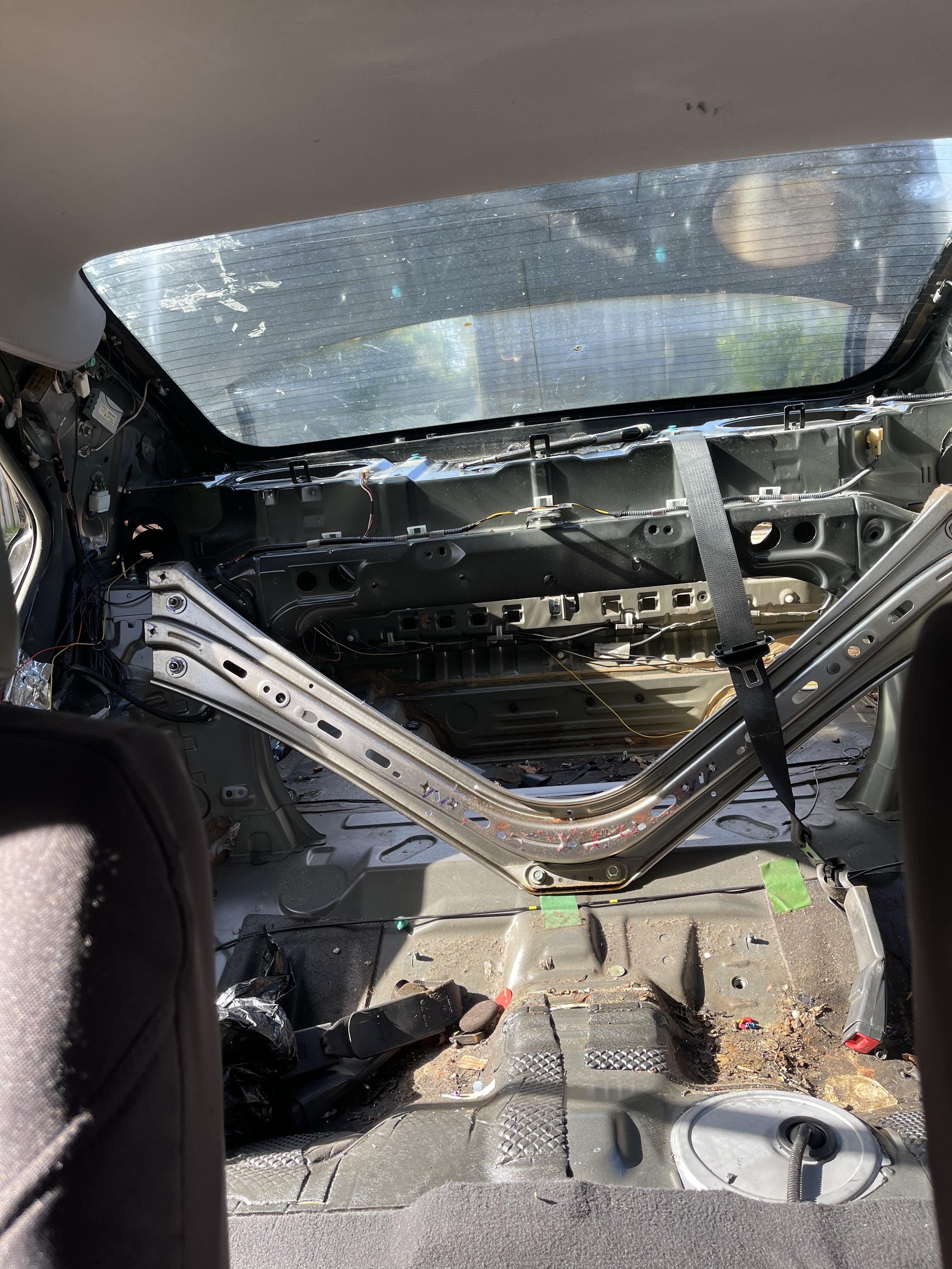

Are you able to post a few more pictures of the boot/rear firewall bracing? Preferably a few angles. Just wanna see how much of that brace is structural and if it could be built differently. (for full boot access instead of a ski-port)
Those existing pictures already show that the existing V shaped brace is structural to stiffen the body. You can see that it can be unbolted. It looks like it should be possible to construct a straight brace.

Alright been awhile kinda forgot I posted this but it’s road legal, just need a mod plate for seating change and keep a tyre repair kit with ya. But we got the car to 1330kg-ish (without me I’m 70kg) from its 1590kg I think. So cutting at the rear parcel shelf, shaving door panels out, sound deadening, etc. Quite a lot of weight in sound deadening and panels in the parcel shelf and doors. Possibly could do a weight reduction on a TRD and keep all interior but remove excess metal panels, sound deadening and all that, was a good chunk 40kg-ish. Don’t have accurate scales as used a weight scale and whatever was added to my weight while holding it. Used a recycle place scale to weigh it up. To sum it all up definitely fun, goes way quicker than before 0-100 under 6s, handles significantly better, no wheel spin on 20” with 235 tyres (use to wheel spin crazy due to weight and squatting), surprises a lot of people with tuned gtis, wrxs, ss’s, turbo fords, you name it. Traction control & vsc always off, ported intake manifold, cai, no cats, no mufflers. If you gotta burner aurion definitely fun experiment. It has now turned into a work car with dual battery, drawers, 240v etc. Current weight with me and fully loaded tools 1870kg. But now it’s time for the TRD to get some weight reduction.
