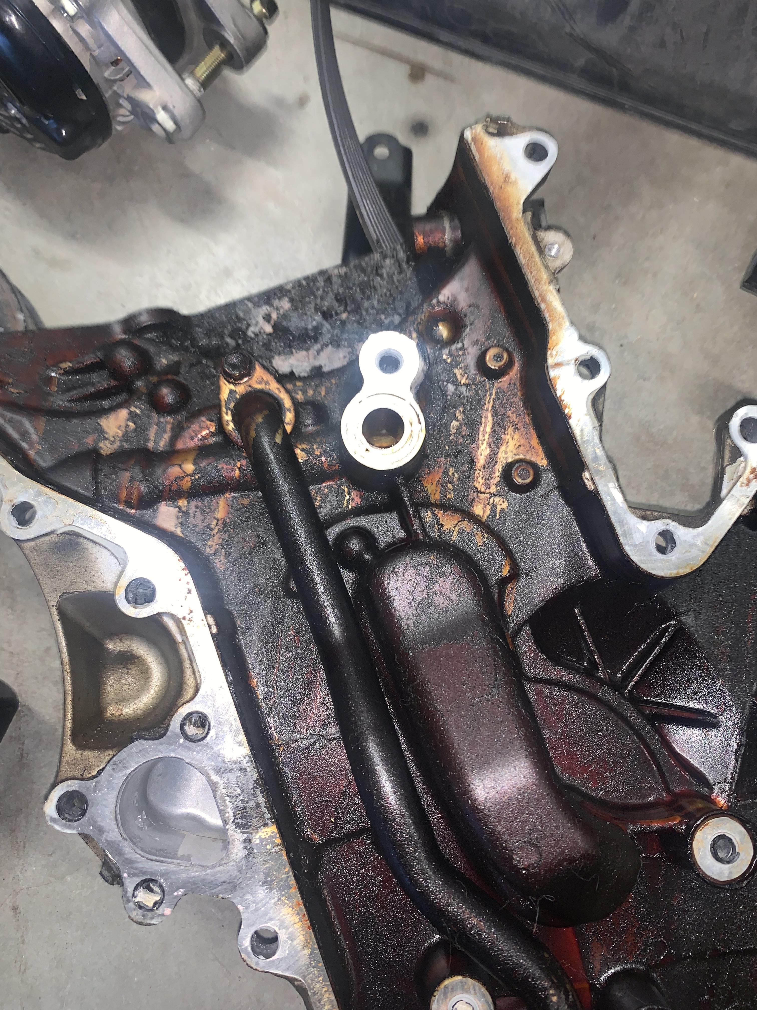

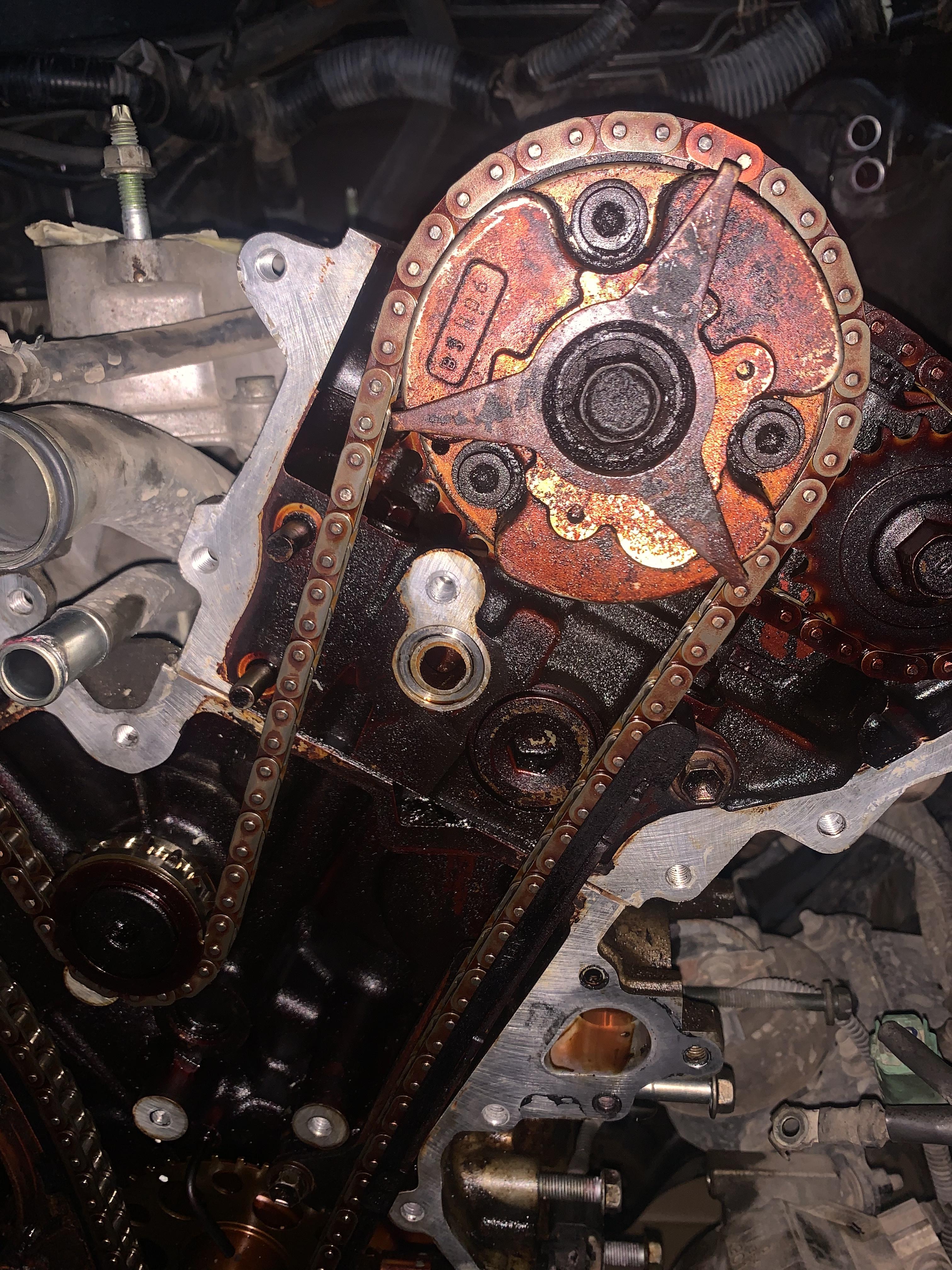

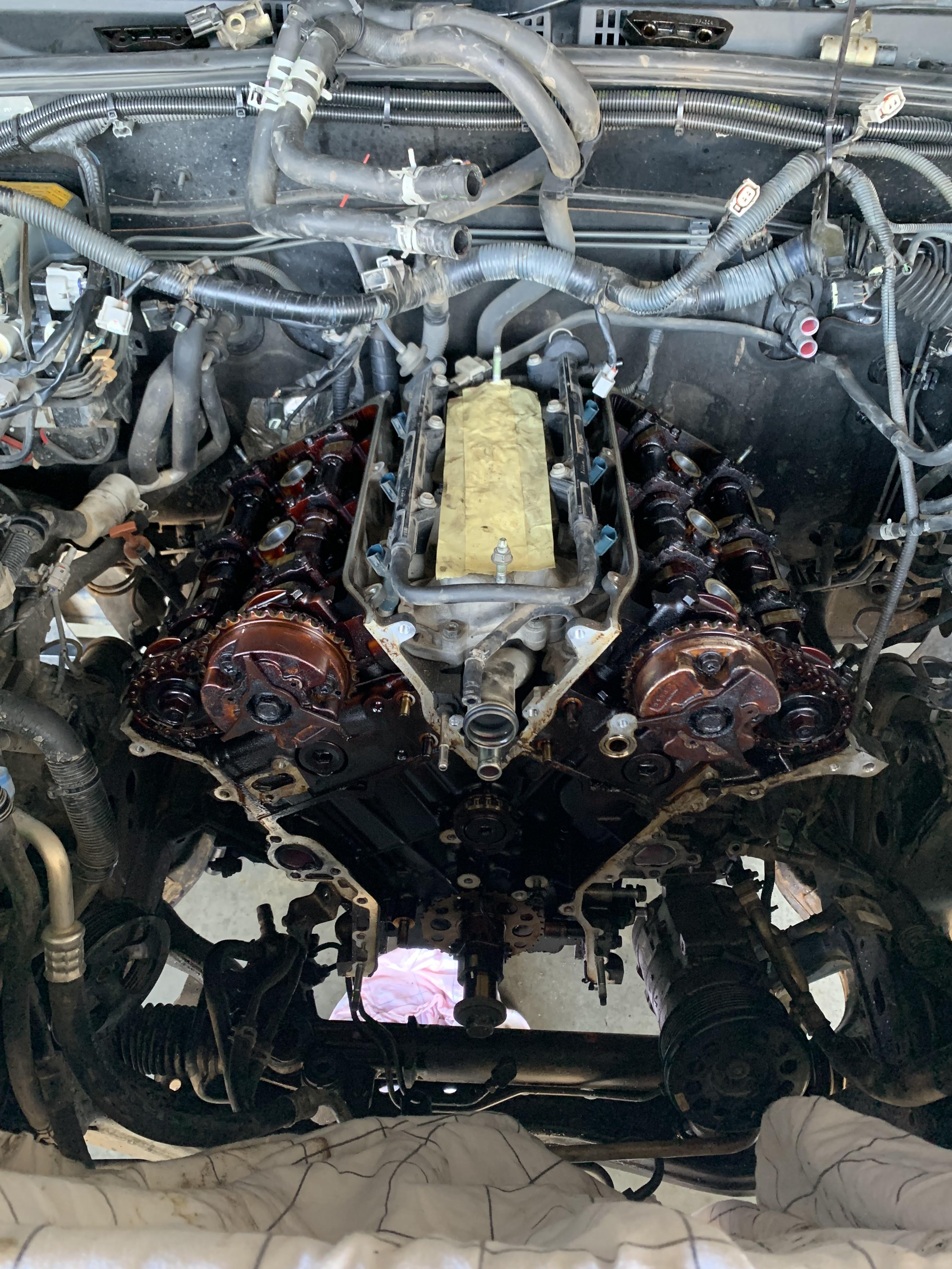

Hi guys can anyone advise me what this black foreign matter is from.  It’s all around the heads and I found about 2-3 tablespoons of it in my sump pickup. The engine is a 4ltr v6 prado and for a long time now the only oil I’ve put in the engine is fully synthetic Penrite

It is oil sludge and burnt oil deposits. Good that you have been using a quality brand full synthetic engine oil.
However, what the oil change interval have you been using?
You should consider reducing the oil change interval to say 5000kms as a general rule but be more guided by regularly checking the oil colour.
I also look for oils with higher levels of detergent additives e.g. Penrite HPR, Shell Ultra and Diesel engine oils.

Wow, that is pretty sludgy. You have the best opportunity to de sludge it while it's all open. Pour diesel all over it and brush the heck out of everything and then flush it several times over with fresh diesel. Collect the crud with a drain pan of course. Then once it's all buttoned back up, you'll still need to perform a few more de sludging treatments with regular, and I mean, Regular oil changes.
You should never let the oil go past 10K. 8k tops and 5K for best results. Oil is cheap, but long term engine damage is not.
