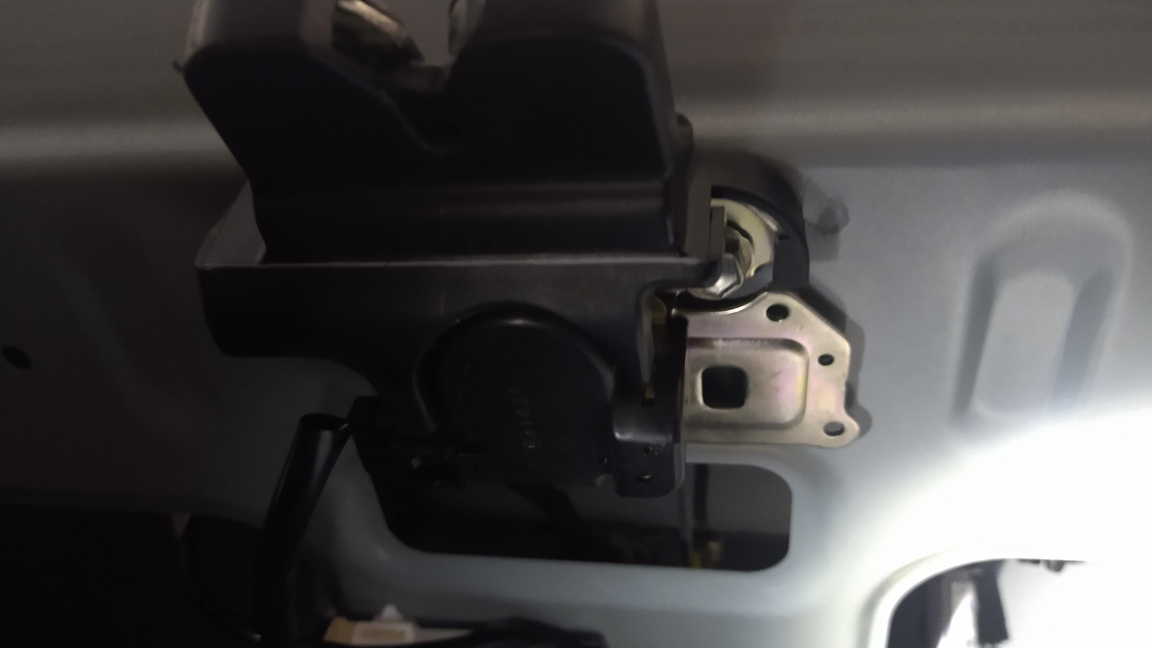

Hi to everyone , I just bought my second Avalon , 2005 GXI with just on 100K ,fully serviced every 7500 klms ,so I'm very happy with a genuine one owner central qld immaculate machine. My other Avalon ( which has just been sold ) runs like a swiss clock and is a 2000 Conquest with 260 K on it .Why but new when you can buy another great reliable machine for a change over of just $5k au. Plus all of my spare and service parts will fit. My question to any one out there after many hours of looking up the web is ,does my car come standard with remote boot release? after reading all the info for this model there is conflicting reviews saying it comes standard but looking at my remote boot latch I found no actuator on it (see photo) there is a black plastic round shroud which should cover a motor but behind it is nothing. Yet there a single wire connector connected to it( boot release latch). I have 2 ,two button remotes, when the small button is held down for 1 second I can hear a relay clicking sound behind the glove box and the horn sounds twice but no boot opening. There is no remote glove box button . The Conquest does not have remote boot opening ,so I cannot compare . The manual just covers all models and does not specify which model has which. My question, if it is not remote ,can I fit a actuator with the existing wiring harness? Many thanks in advance if you can shed some light on the matter .

Yeah remote boot release just means you don't have to be standing physically at the lock to open it.  My '98 Corolla lists "remote boot release" but it is 100% just a lever in the cabin even on the highest spec.
Hi, If there is no button on the remote there is no remote boot opening the only actual cable would be the one from inside the car to open the boot lid, I would imagine unless there is wiring in place already it would be a very expensive and complicated job to add a remote button boot release and the car would not recognise any other remote to operate the boot opening. I don't know the Avalon well but is there a button under the boot lip to open the boot? that may be the wiring your seeing.

Hi to everyone again ,thankyou for your experience and advice ,with the info given I have now worked out that this model (at least) has a remote boot release , as pointed out is the manual lever beside the drivers seat , the electrical connector going into the boot release actuator is there for when the car is locked and you open and then shut the boot lid the indicator lights flash once to show the car is now all locked, so I do not have remote button boot release even though I received 2 sets of original keys with 2 ,two button remotes (this is what confused me, that and the electrical connector to the release actuator as the per the attached photos),so again thankyou to the Avalon community for your time and replies to this post, hoping to reciprocate in the near future.

As my post states , I have 2, two button remotes that came with the car ,so this is where the confusion and why I was wanting info ,that and the electrical connector at the boot release actuator all pointed to remote button boot release.. Cheers

If it's anything like my parent's '96 Camry, if you don't close the boot lid properly with the car locked it'll beep the horn too

Or if i don't shut my Avalon boot fully then re-open it, the alarm sets off, because i'm guessing even though it didn't latch fully it detects a forced open event. Oops, sorry neighbours 🤣🤣🤣
