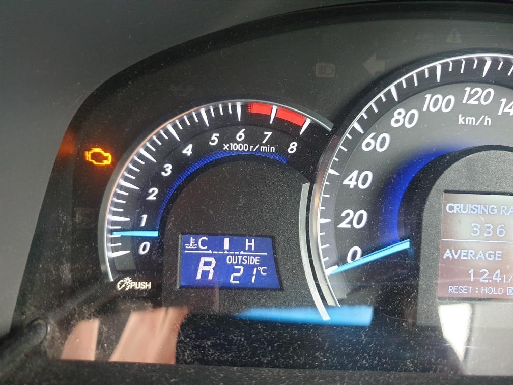

G'day Gents, It is a historical moment for me as I have encountered my first ever CEL on my beloved Aurion.

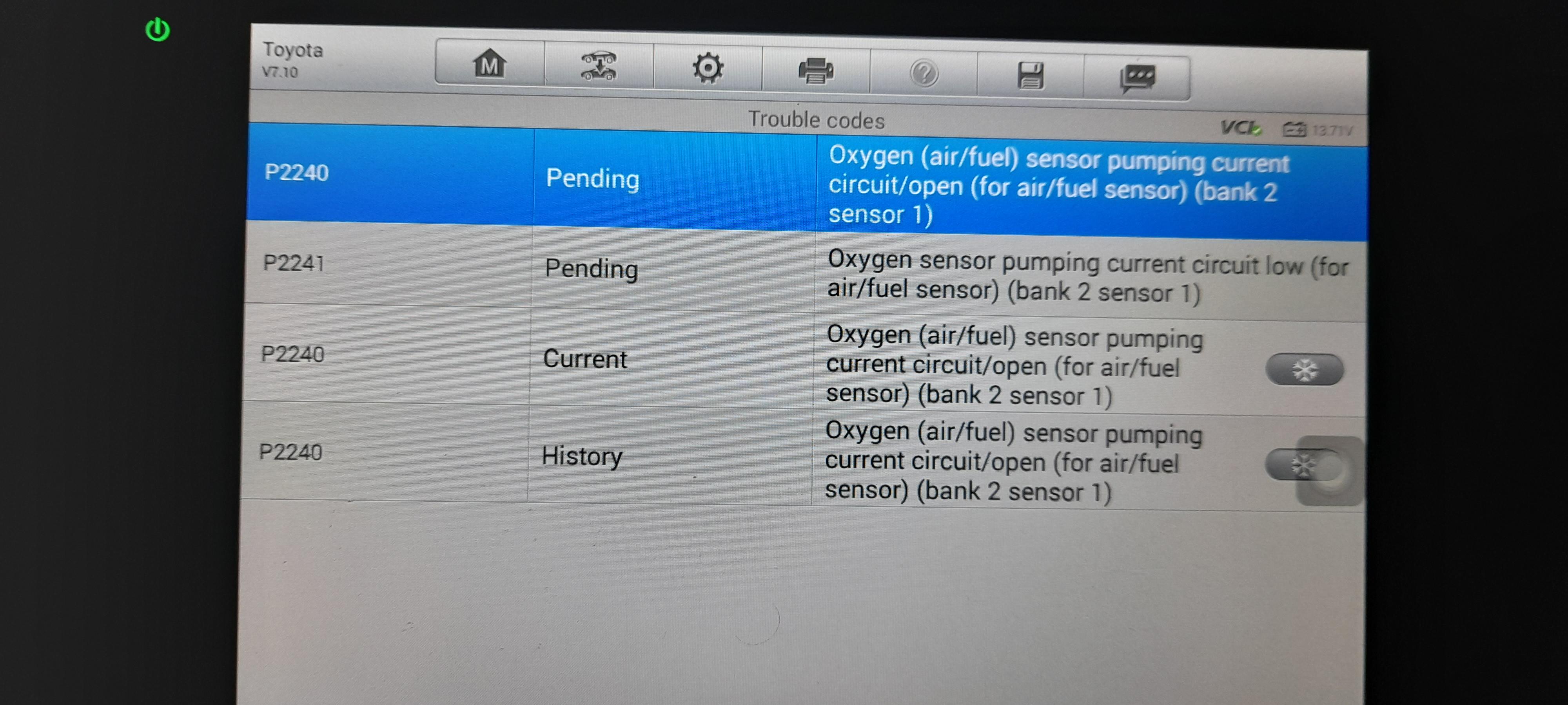

It's throwing a P2240 code which points to the Air/Fuel Sensor on Bank 2. Luckily enough, bank is the front facing side so replacing this will be much simpler than that of the rear.
Initially I tried to do a simple reset, but it presented itself again soon after driving it, so It looks likely I will have to order and replace it. But before I do, I will attempt to remove it first to inspect its condition, do a reset and try again. If that fails then I'll just replace it.
I'll update you guys later on.

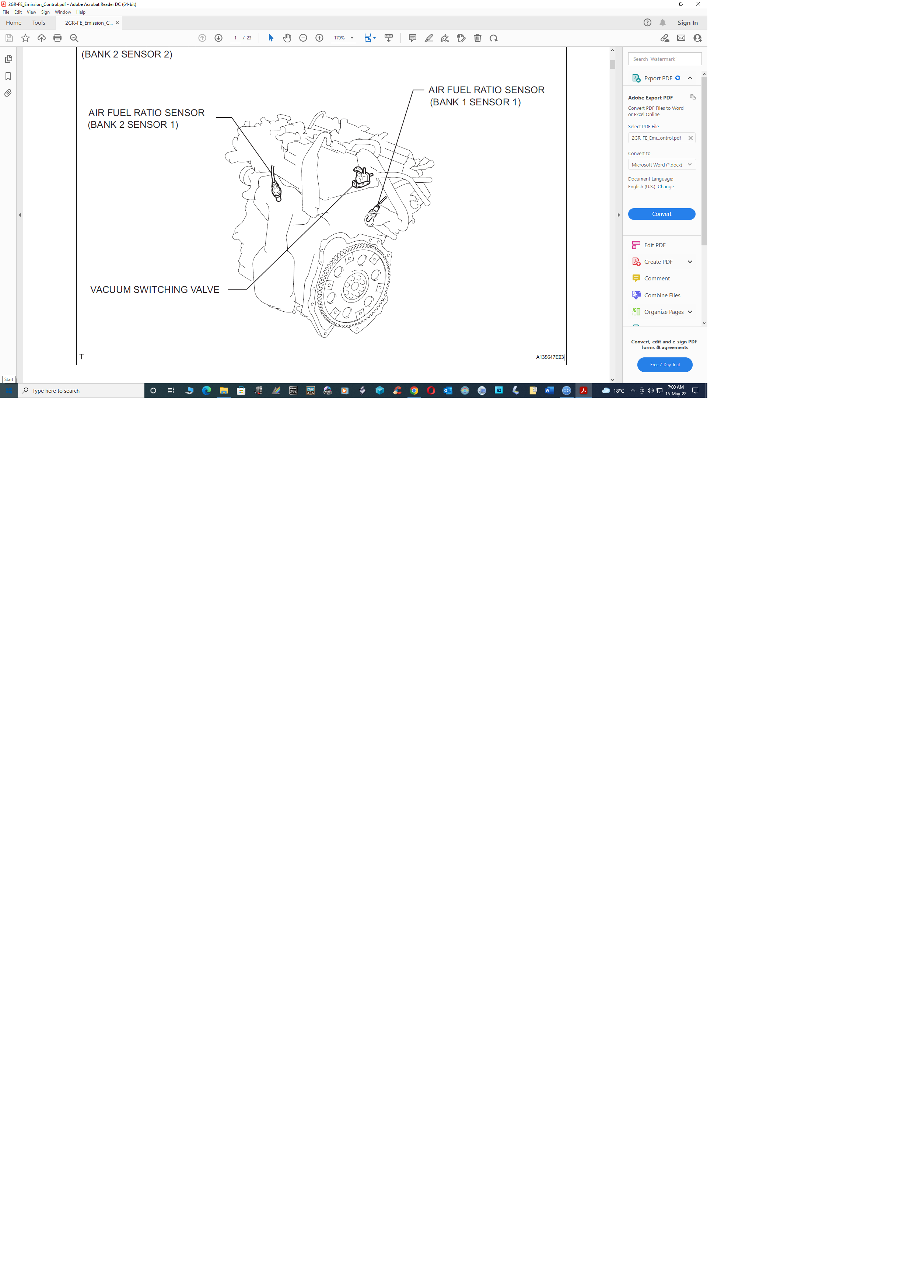

16 hours ago, campbeam said:
Bank 2 is the one closest to the front of the vehicle.
Typo. I meant to say bank 2 actually, not bank 1. The front facing bank is bank 2, correct.
