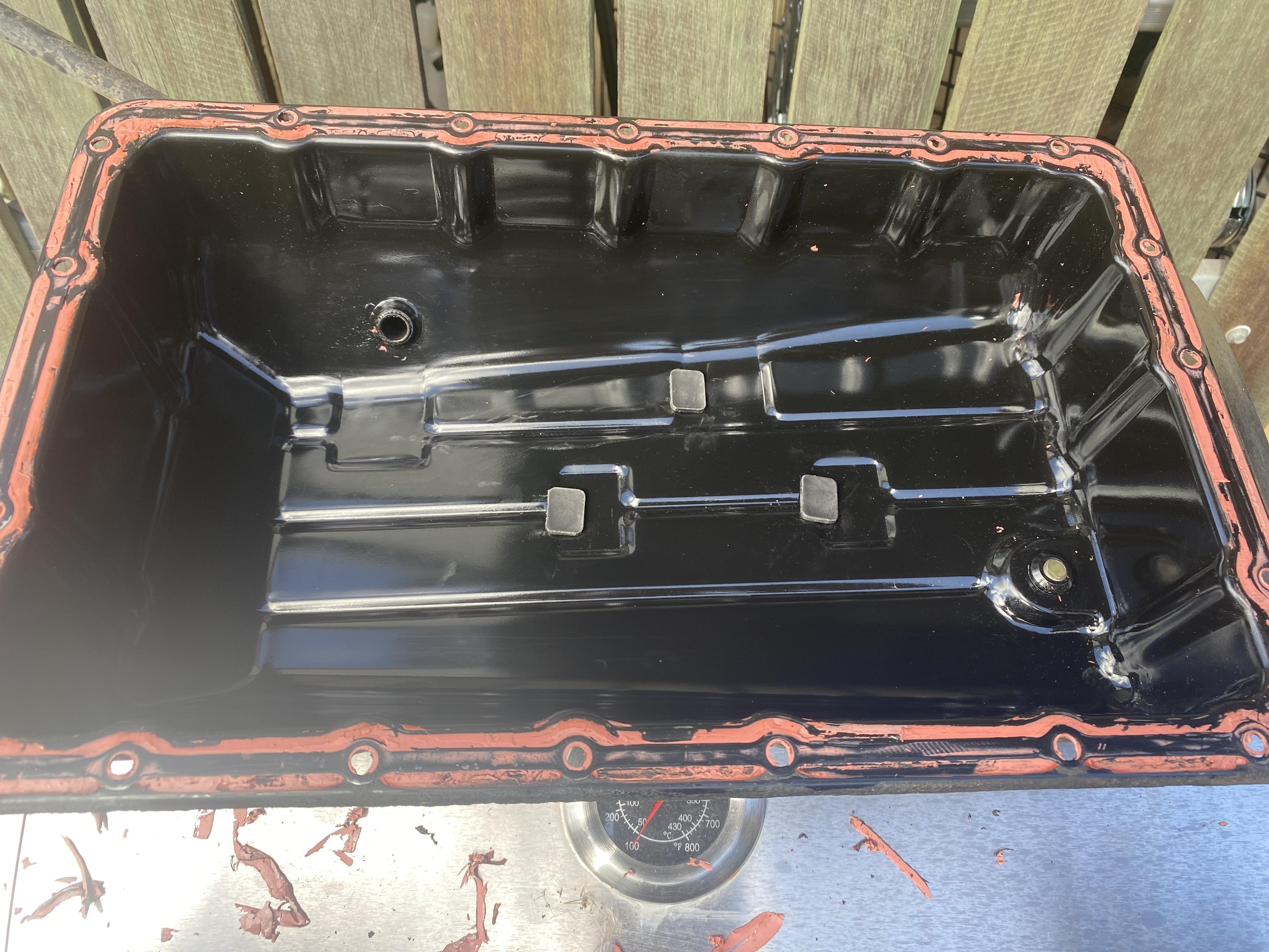

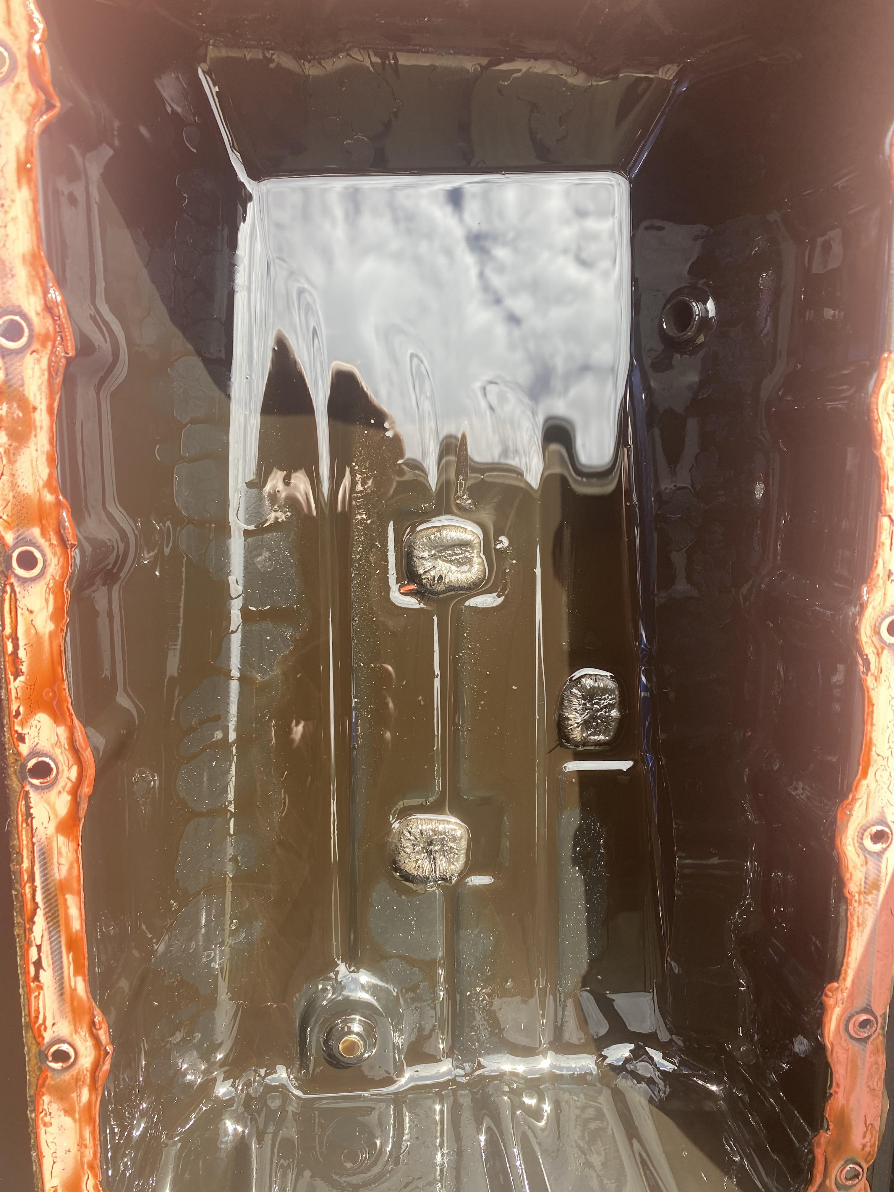

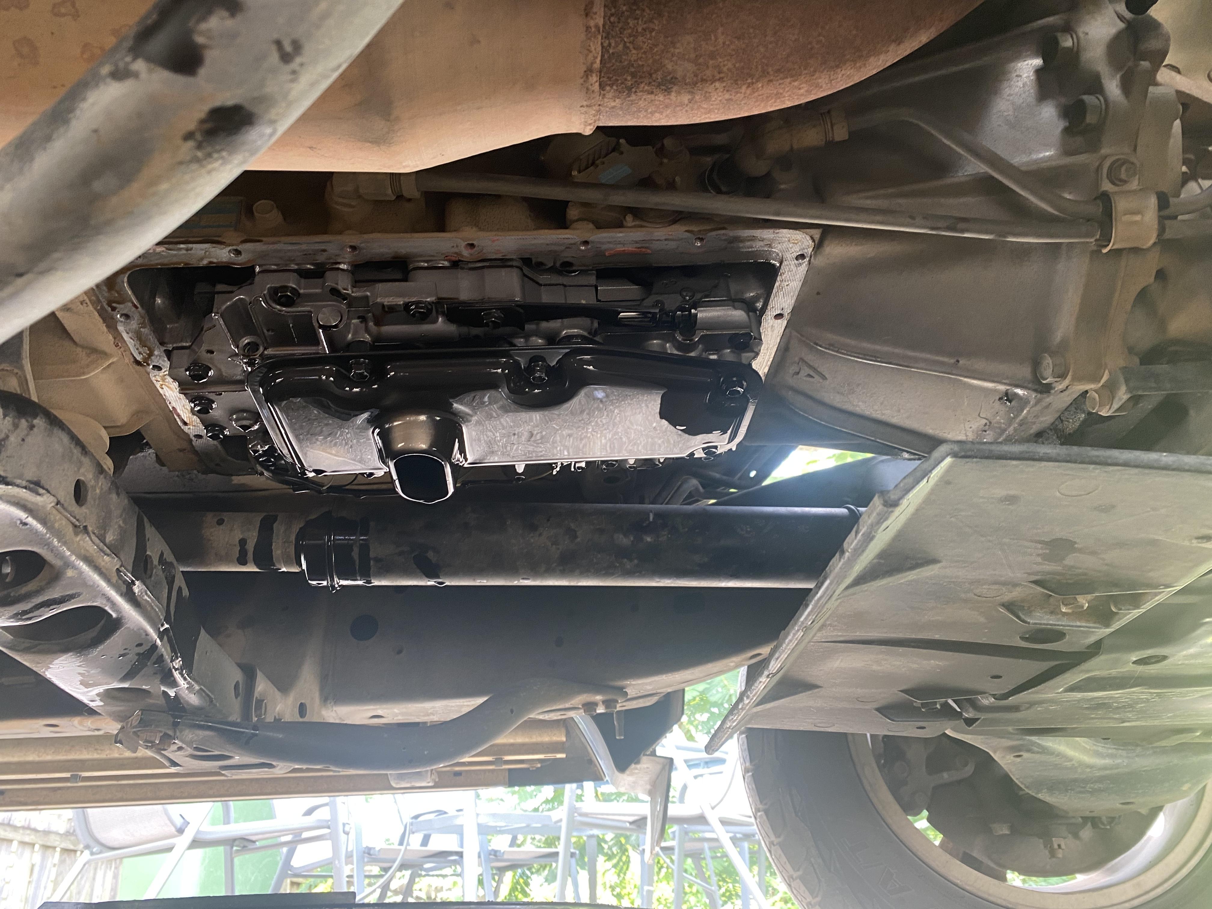

So replaced the transmission oil , cleaned out the sump and also replaced transmission filter but still hasn’t fixed the issue hmmm. Off to a transmission place tomorrow I guess unless someone can help here
