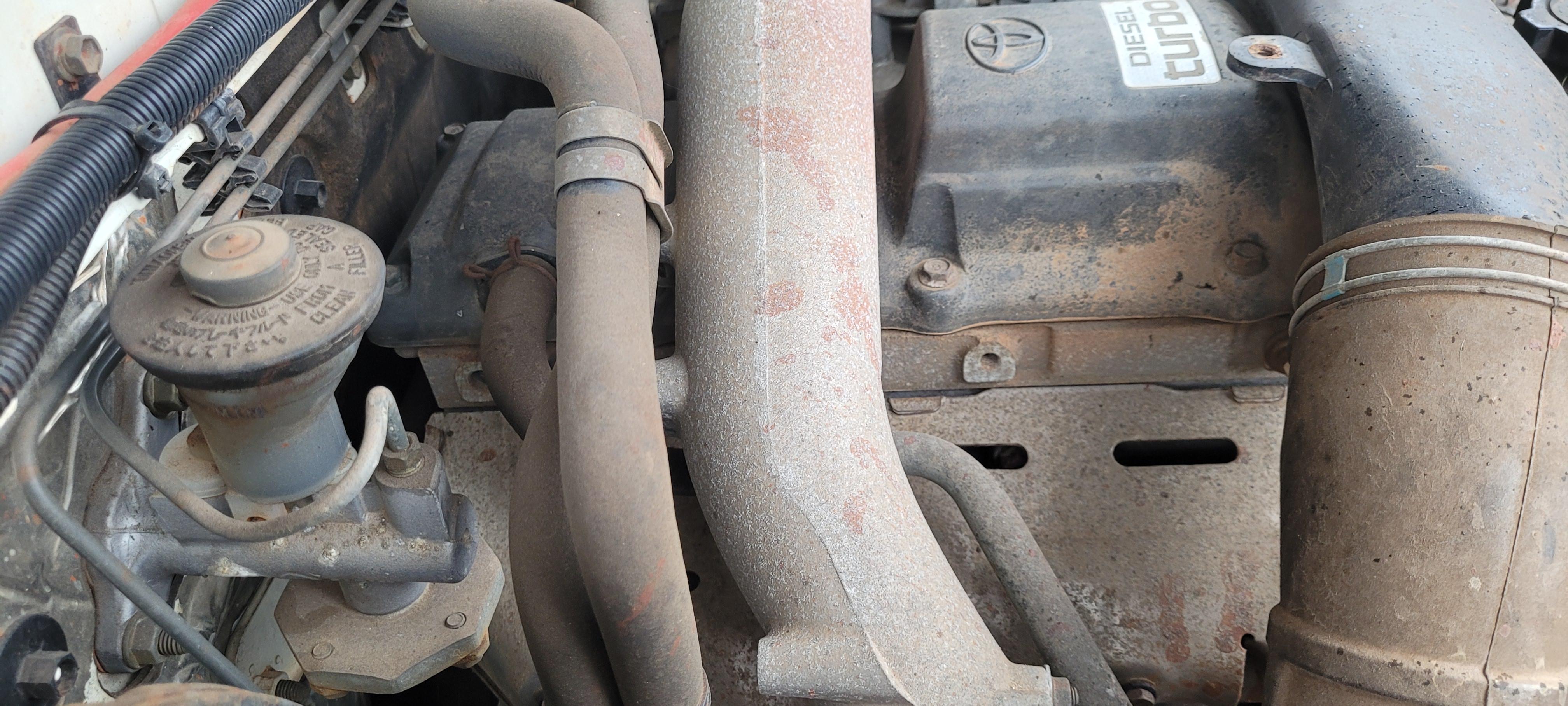

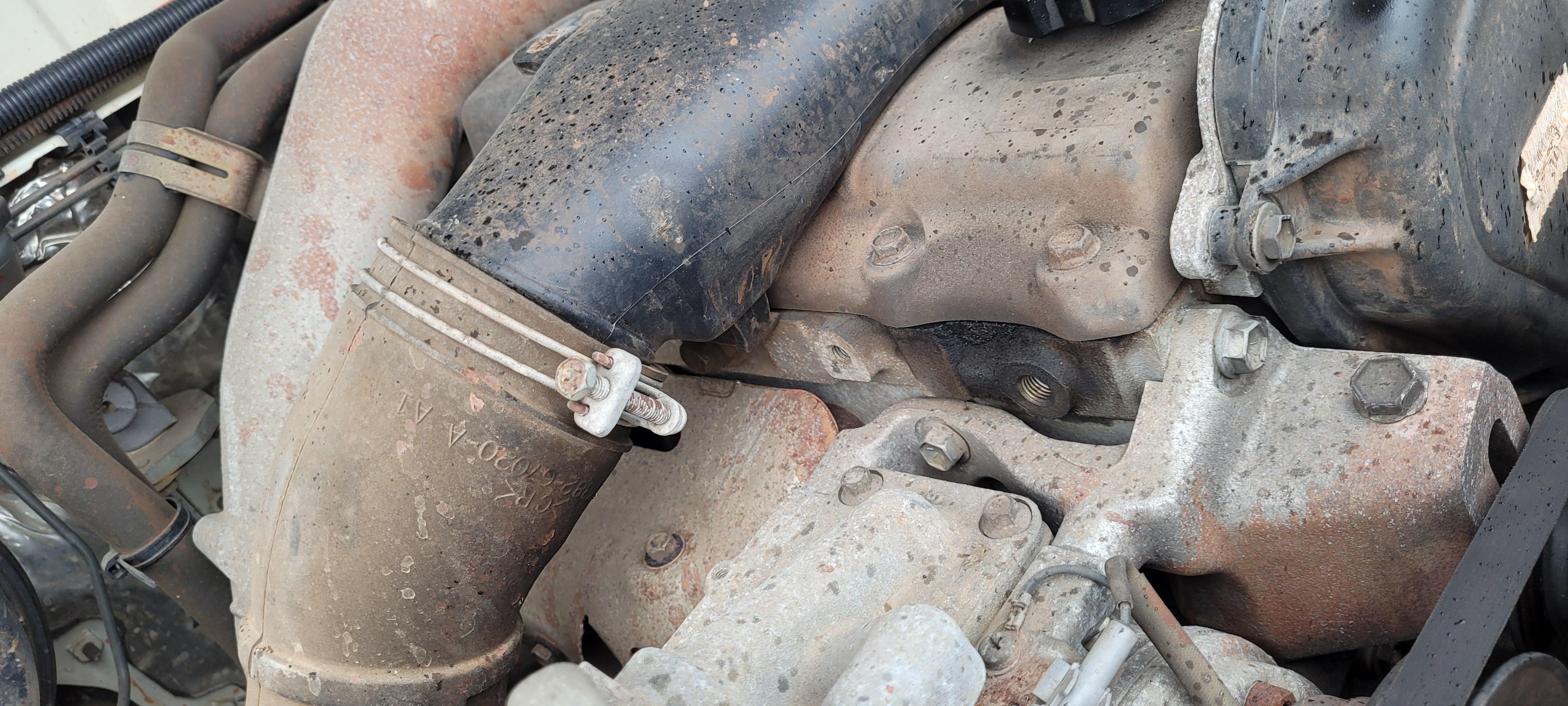

Am I missing something? A bolt to turbo? or is it a filling point? Looks like a well oiled clean part, 1 especially doesnt look like its always been missing.
I opened the hood and looked around and found 4 bolts missing. screws for turbo manifold? or threaded hoist and air inlet? I seem to be losing torque, and shes not so wprry free aanymore after service (i am taking it back asap)..just wondering if i am crazy that is all,

Judging from the "mating surfaces" of those threaded holes, i'd say there was nothing attached there to begin with. If you look closer, you can see the amount of corrosion on the mating surface matches the rest of the metal surface adjacent to them.
If there was something attached, then those mating surfaces would be clean and shiny, right ? They can't get corroded if something is covering them.
Also, that oily residue is your rocker cover gasket weeping ever so slightly. Doesn't look too bad to worry about, but you can have them check it and see what they reckon. Should be ok in my book.

Thanks for your reply. Yeah I agree the dull srews which are missing seem to be missing for a while.
Though, in the photo with black oily residue, there does seem to be a threaded hole which has fresh oil visible, also there seems to be evidence of oil almost 'spraying around the head manifold / or turbo.

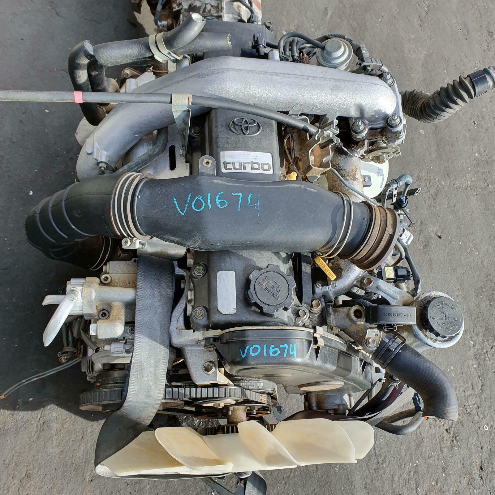

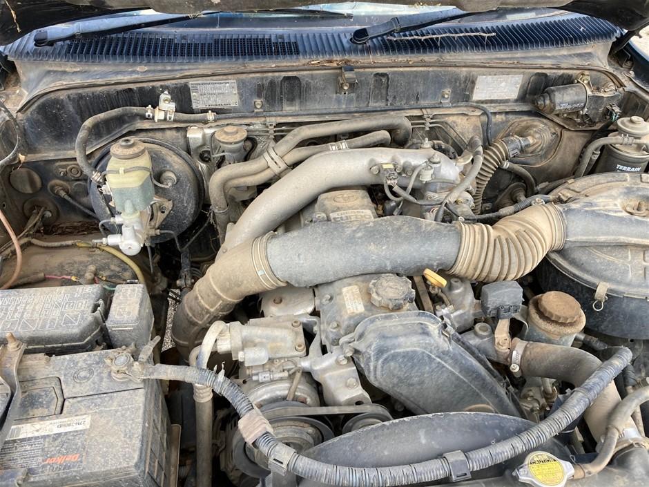

No Sir. It isn't the case at all. Those threaded sections are NOT through holes. They are cast in the head so you can be able to bolt on other accessories.
The two towards the rear are for brackets. One is for some tubing and the other is possibly cruise control. Your's has neither.
The front two, again, potentially same as the rears, but in all the pictures I can see, there is nothing bolted there. The oil you are seeing is the rocker cover gasket leaking. That's it.

Take a look at the two pictures I've attached and see for yourself.
It's the best I could find.
This link has one for sale. Hover over the pictures and see the brackets attached to the very holes you speak of.
https://www.jdmwestcoast.com/jdm-toyota-1kz-hilux-surf-4runner-3-0l-1kzte-turbo-diesel-awd-auto-trans.html
