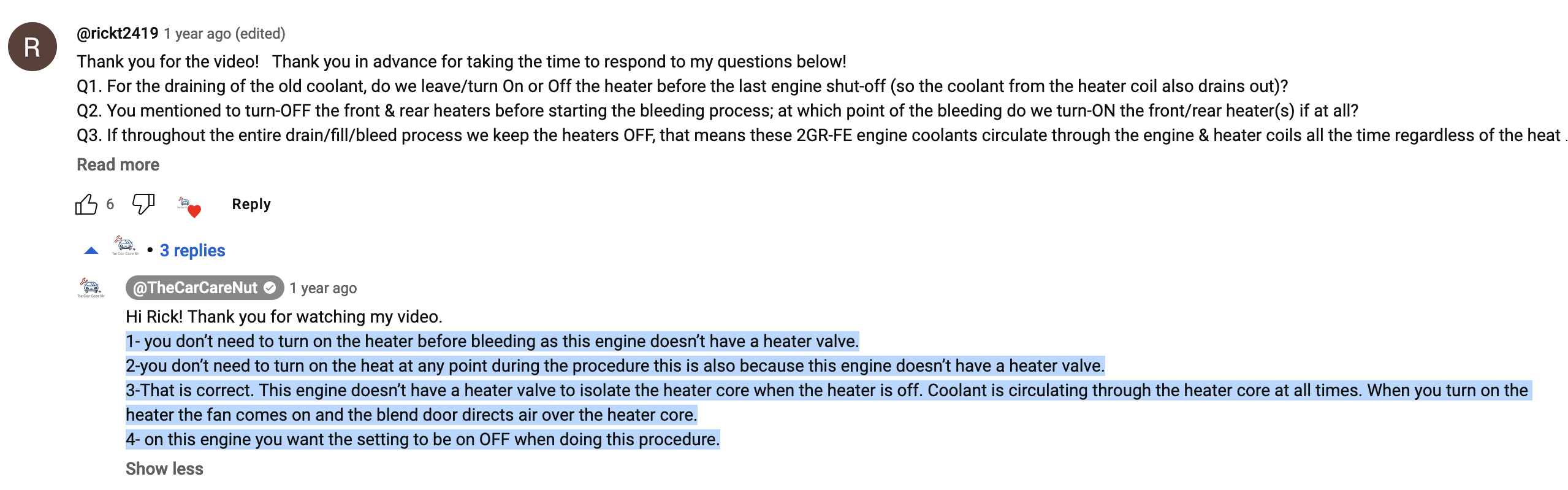

The car care guy goes thru a great video of purging the system which works great.  I read in my Haynes manual for the car about the two engine block taps.  Haynes also suggests removing the thermostat and flushing water thru with a garden hose via the radiator hose.  I did not do that but I did put 2 x bottles or radiator flush in and drove for half an hour then came back let it cool and then jacked it up and emptied all that fluid.  I then filled it up with brand new toyota genuine fluid from the dealer which was cheap.  Then went thru the air bleeding which works exactly like he says it does.  I purchased the container with the special radiator caps from amazon as he links to his video. Works well.  I changed the oil at the same time and filter.  I do oil changes now at 7500 km and use Mobil 1 full synthetic.  I managed to buy some in bulk recently on special and use it in the other Aurion and another car which takes the same oil grade.

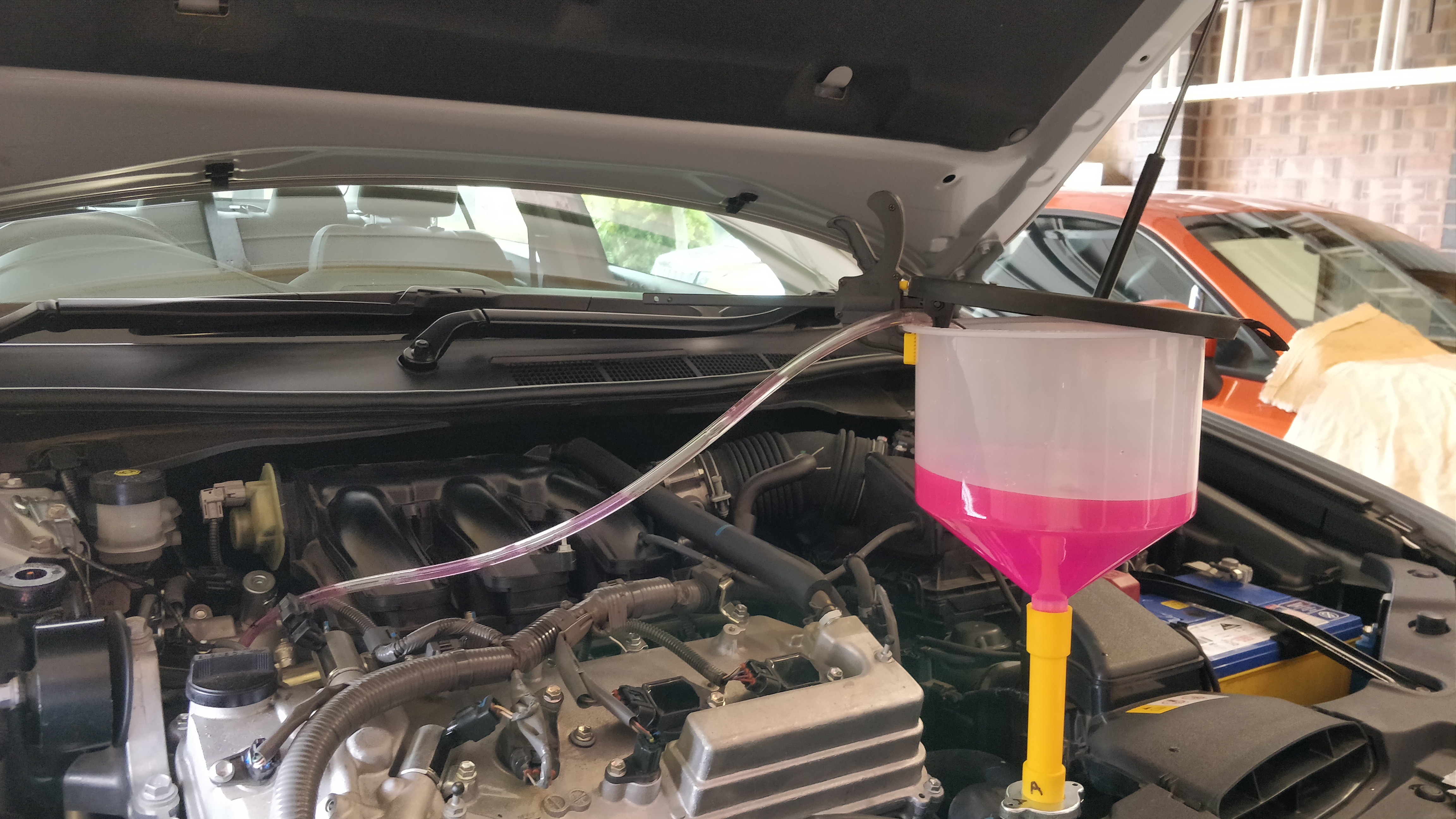

Some additional notes I made:
1: open bleeder 1 - 1.25 turns max otherwise air may get in
2: bleeder hose not immersed into overflow coolant funnel otherwise will suck back in
3: install cable tie to base of bleeder hose to prevent leak & falling off
4: make sure funnel rad-cap tight fit otherwise will leak (had to tighten mine)
5: bleed process took 13minutes in 30+degree heat in garage before steady flow from bleeder hose
6: let engine idle a further 15minutes for coolant flow to normalise & little to no air/bubbles from overflow funnel
7: next time use both block taps to drain
8: fill coolant to crease on funnel plenty otherwise risk overflow during bleeding process & engine running @ 2500rpm
After turning engine off I extracted excess coolant from funnel, removed the funnel & bleeder cap from radiator neck, filled to top then closed her off with factory cap. Filled cars overflow bottle to full & let the engine cool overnight. In morning when cold refilled overflow bottle to full as engine cool down process will suck some back in, lightly washed engine bay of coolant & dirt & dried it before starting. I checked the coolant level was full after a few drive cycles to make sure it was all perfect, car runs beaut 🙂
A painless process all made possible due to the great AMD aka the Car Care Nut, our greatful & dedicated friend from the Toyota world 🙂
Edited by ZZT86
credit to AMD

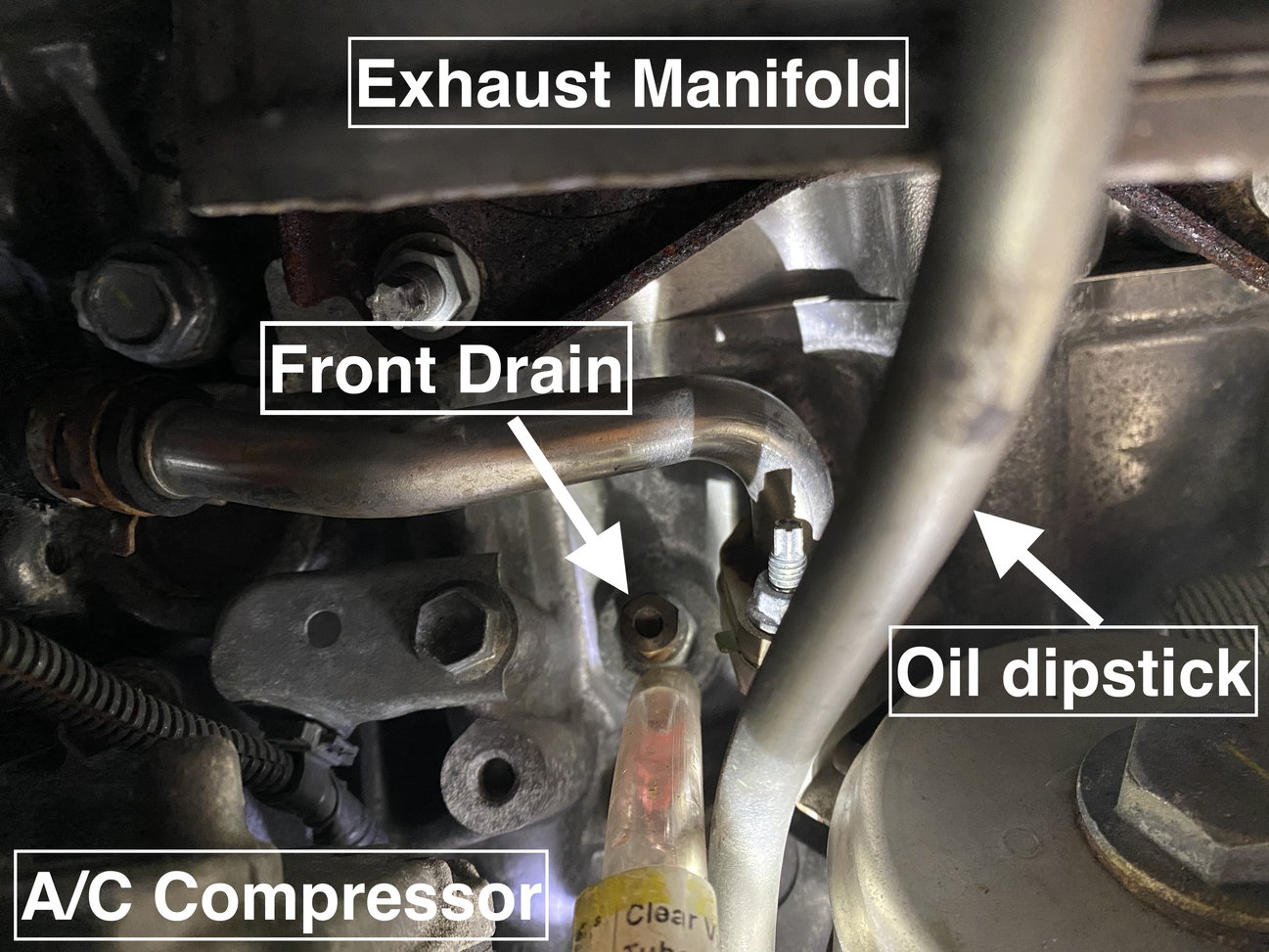

I too also accessed the block taps but couldn't see the front one & just ignored it as I got most from the rad tap (4.75L) & then the balance (2.5L) from the rear block tap. I connected a hose to both before opening the tap for extra cleanliness.
I had a quick look online and this is the picture I found for the front drain point. (SEE BELOW).
I haven't physically looked at mine yet, but according to the picture, it appears to be next to the oil cooler flange adjacent to the dip stick tube.
I wonder how much more coolant one can recover if both are drained instead of just the rear which you did. I also wonder if the heater core also drains back whilst utilizing the rear drain. I would assume approximately 500mm or so in the heater core.
The coolant capacity is 9.4lt. You were able to extract 7.5lt leaving 2.15lt, so I would be inclined to drain the front section of the engine too, to get as much out as possible.

Just re-reading some old posts and didn't realise that AMD actually responded to your comment ! Wow, what a rare occurrence. He most certainly wouldn't be doing that nowadays with his gruelling schedule. One of the lucky few.
I also re-read my coolant flush Thread and looks like the moderators have defunct the video parts I uploaded too. I wished they wouldn't do that. Ruins the continuity..
